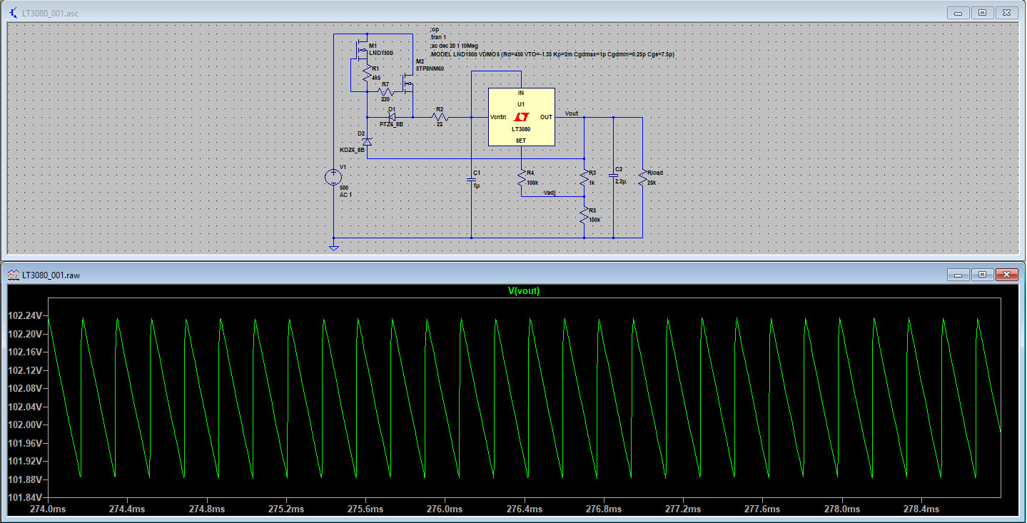

You've got something going on there, but it isn't oscillation. It's the load pumping. If the circuit were unstable you would see a sharp peak in the impedance plot.

Could you perhaps humor me and load up the attached .asc and let me know how it works for you?

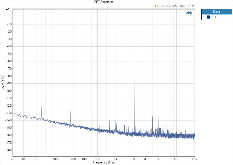

"Hash", that is what it looks like, however most all of it is below 1uv.

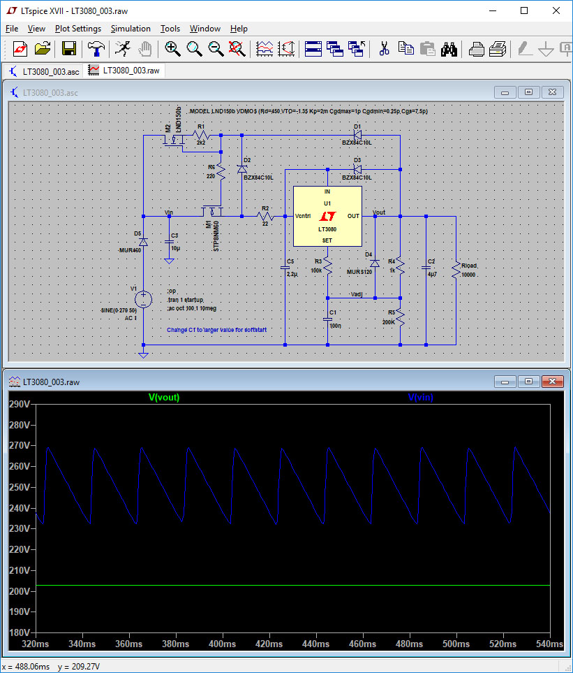

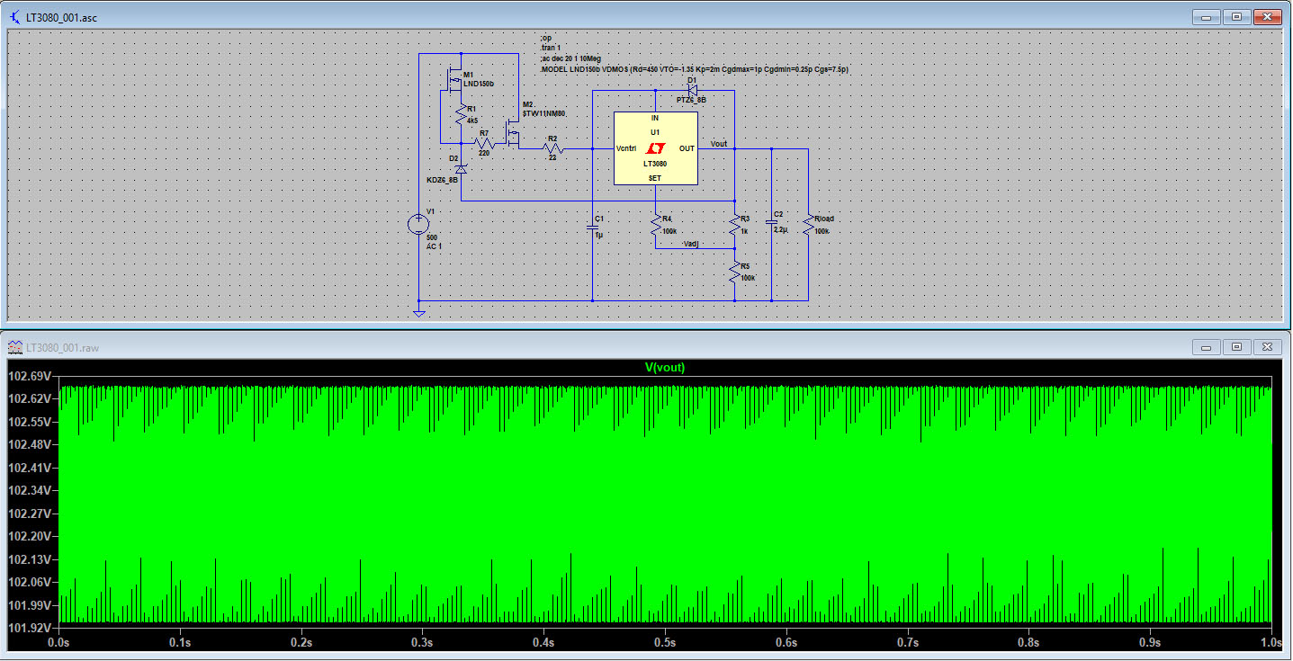

Would help if you had connected the gate of MOSFET M2
I'm sorry, but as per the picture in my previous post the gate of M2 *is* connected (to R7).
To make matters even more entertaining I've just redrawn the entire circuit as per your first post in this topic, even matching all of the parts in terms of exact type used. Et voila, the same result, it oscillates or has a bad hiccup, as can be seen in the picture below (Vout zoomed in).
And please don't take this as offensive or anything of that nature, I'm merely trying to figure out why this design falls apart in the simulator and appears to work in practice, in my experience it is usually the other way around.
If you could share you .asc that does work I'd appreciate it and look forward to taking a look at that, as my goal here is to understand why there's a discrepancy between simulation and reality.

You'll agree with me that the schematic presented in the first post is significantly different from yours, hence no need to be concerned, we're not comparing apples to apples here.
Like you I take a rather analytical approach to engineering, so if something doesn't work on paper, or in the simulator, I'm not going to gamble that it will in practice. So I'm merely trying to understand why a circuit that is discussed in this topic, and apparently seems to work in practice, falls apart in the simulator.
You'll probably want the cathode of D1 connected to the gate of M2.
I'd also look at the loop stability around the CCS.
Finally, I'd double-check that Vgs(M2)-6.8-Iout*R2 > Vdropout(U1).

I'm sorry, but as per the picture in my previous post the gate of M2 *is* connected (to R7)....
I do not know your schematics editor (and can't load your file).
To _my_ eye, R7 is 'too close' to M2. The end of the resistor, and the end of the gate, do not meet, but overlap. My editor will let part leads overlap without connecting. This has bit me several times.
However usually the sim will complain on error-check ("floating node"). I do not know if all sims do such checks.
Rest assured I triple checked everything and have redrawn the circuit many times, and in case of an unconnected pin, the simulator will indeed report a floating node.

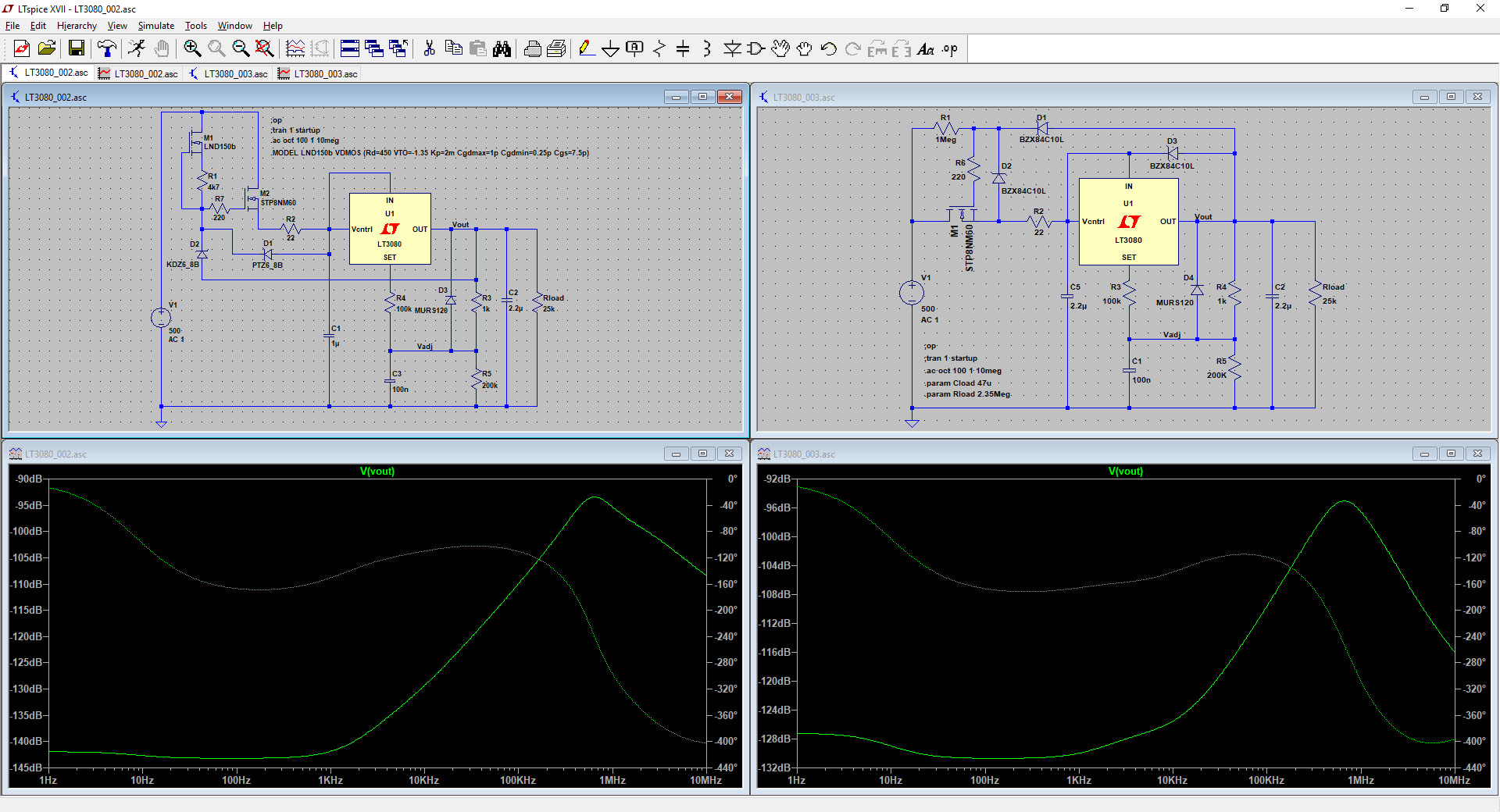

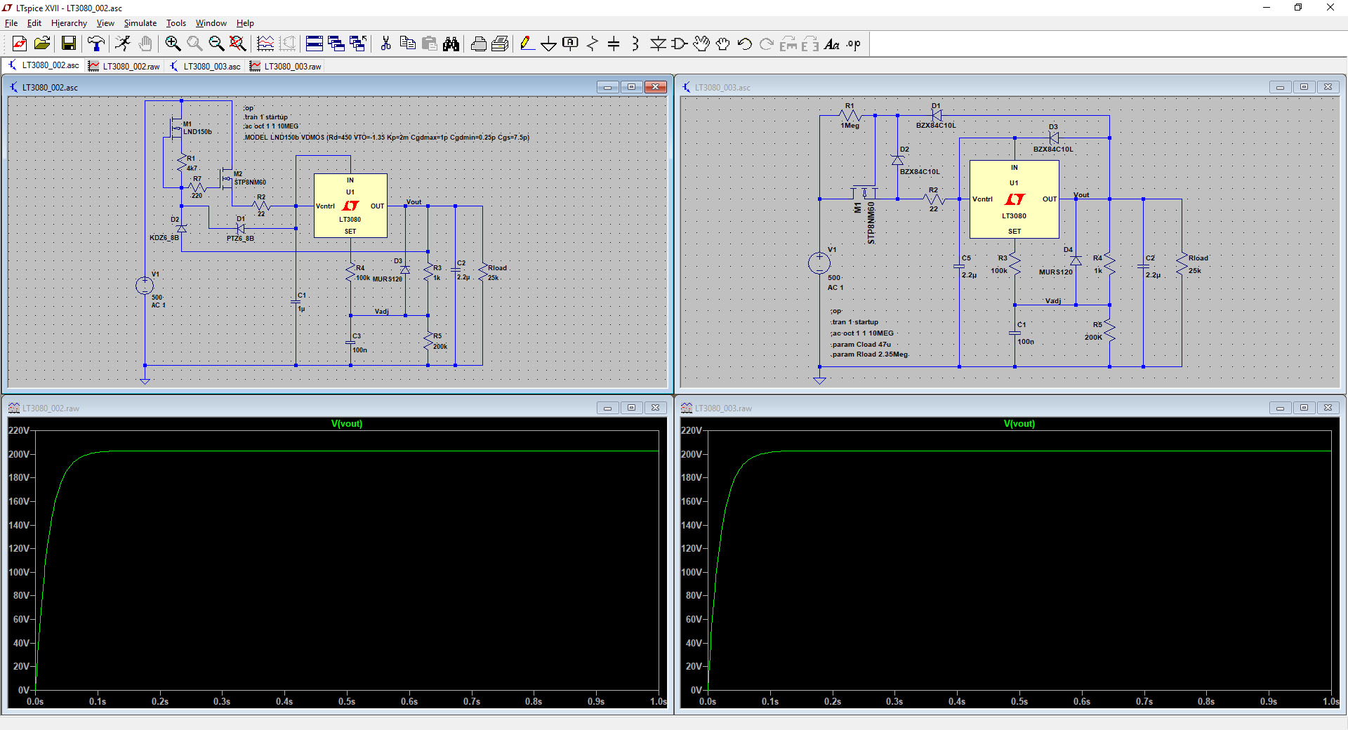

Alright, I had an hour to spare this morning before heading off to work, so I dabbled with this for a bit whilst munching on breakfast. After going over things with a fine toothed comb all I could come up with is that the startup behavior isn't well defined and would cause for the hiccups as the LT3080 is having trouble regulating.
I added C3 and D3 to the original schematic which now properly define the startup behavior, the whole regulator now works fine through its voltage range by changing R5 in value. I also generated some PSRR plots and as icing on the cake reduced the original design to a simplified version without the CCS which shows good performance in the simulator as well.
Below are the schematics and graphs generated, on the left is the original design from the first post, on the right is my simplified version. Comments are welcome of course.

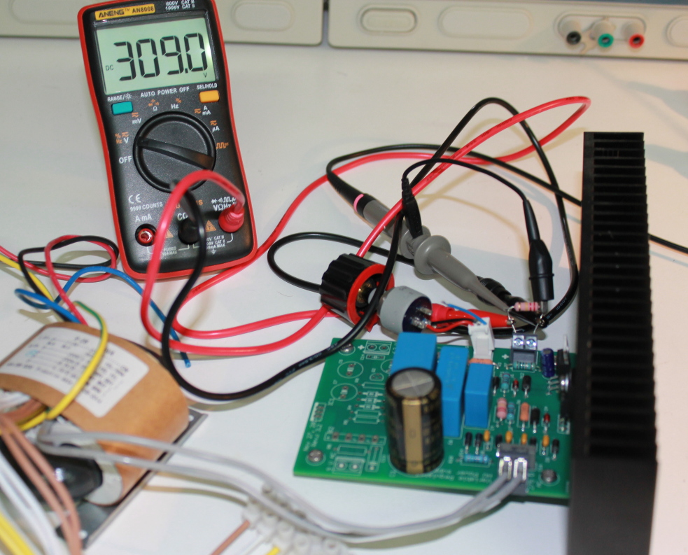

Did not want to keep you hanging. There is still not space for the oscilloscope. Same setup as original run. This time I cleaned up a few clip leads and twisted the power supply conductors. The FFT for the 21st Maita is much cleaner. See attached plots.
I'm doubtful of that hypothesis. At least I haven't seen any startup issues with the LT3080 in simulation.
Nice improvement in line rejection. It'd be interesting to see if it holds up in practice.
Very cool. Thank you for following up. Yeah... It doesn't take much loop area to muck up a measurement at the uV level.

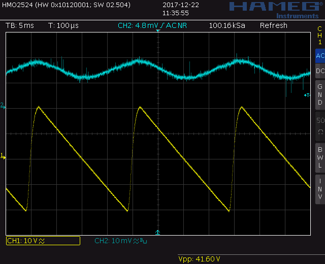

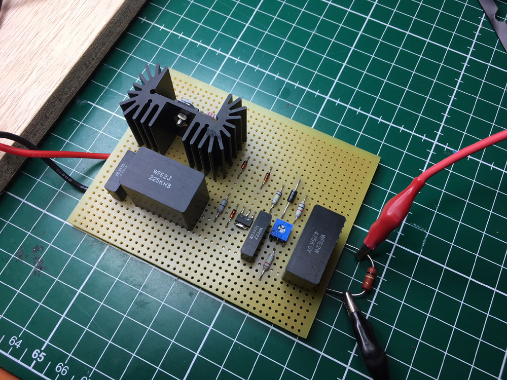

However, going forward, I've subsequently revised the design and verified it both in the simulator as well as in practice, as per the below pictured quick perf board prototype. That crude 30min prototype shows some impressive PSRR and that's without a decent PCB and a good look at current loops etc.
With 42Vpp at the input and 7mVpp at the output that's a factor of 42/7x10e-3=6000, or about 75dB, good enough for a perf board prototype in my book.

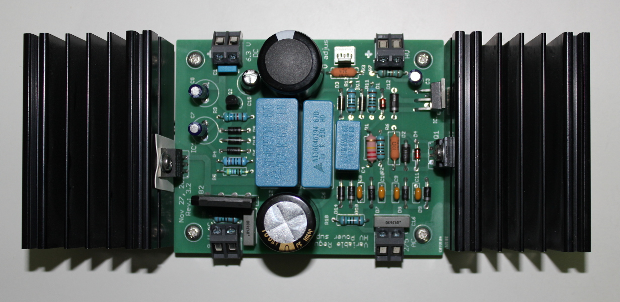

Congratulations for the nice result you had with a simple perf proto board, personally I will have used the TO220 version for the LT3080, not for power dissipation but for easy soldering 🙂
This is the version I have used in my power supply for an RIAA preampli (see photo) I wanted to integrate the rectifier and filtering on a single PCB with also the 6.3 V power supply for the heater therefor I only need a transformer to build the complete power supply...
I just need to add a pot on the white "V adjust" connector to set the output voltage between 50 V and 350 V and I can also use it as a laboratory power supply. I didn't made extensive test yet but a quick demo with the RIAA amplifier described here Merlin RIAA Preamp give very good result without any power supply noise 🙂 I will do more test next year 😀
