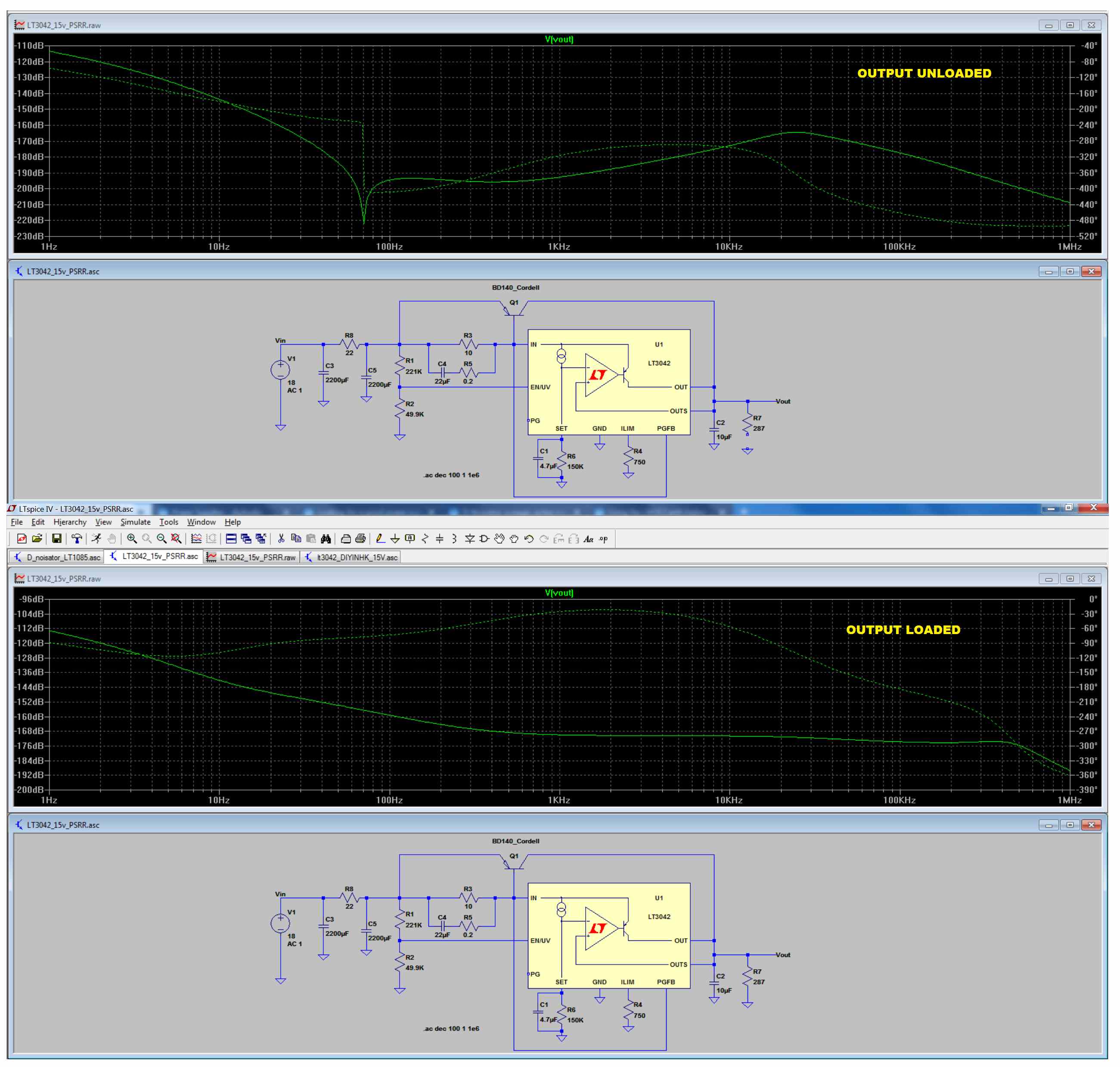

LT3042/3045 LTSpice simulation
When doing these simulations, the first electrolytic capacitor (connected to the voltage source) is useless except if you define some series resistance of this voltage source, just try 🙂.
Of course in the real life the things are different...
I'm not sure what change you mean. If possible add it to the asc file for me to see or show it how.
BTW, I do not see any kind of load on the first picture?
Of course, there will always be a load. Load added. Curve got much flatter.

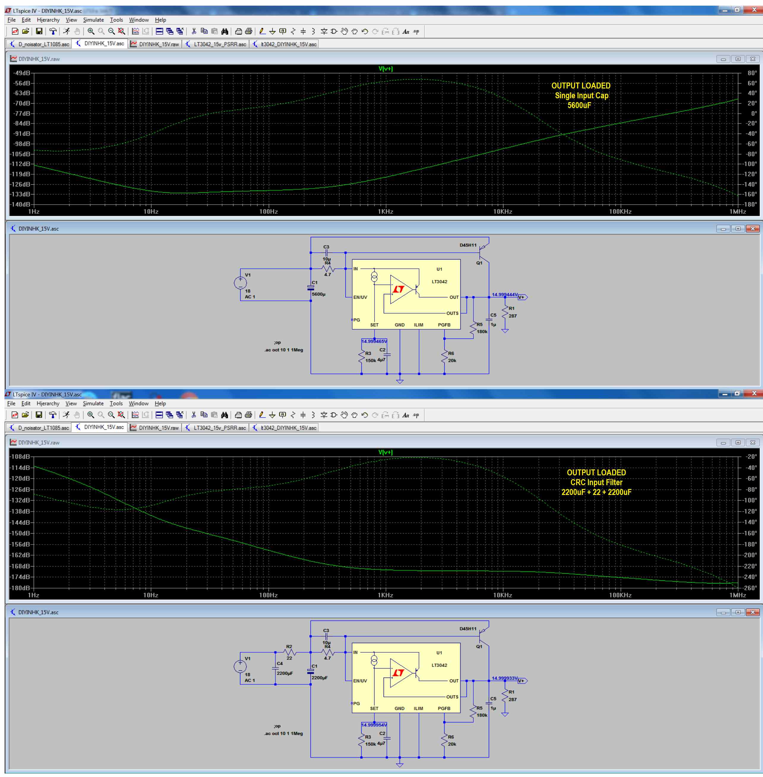

Can someone explain to me why the resistor divider is at the input on the datasheet and at the output on the DIYINHK version?
Here are some more PSRR comparisons. The CRC improvement seems quite obvious all over. Anything against it?
No differences between PSRR on datasheet and DIYINHK versions. I would have to check any impedance differences.
The more components that can be eliminated to simplify the circuit the better.
Please do suggest changes to correct or to improve things.

Since you use the High-power version, load it accordingly, for example with 15 ohm load which yield 1.5A output current.
The resistor dividers are not so important for PSRR simulations - they are used by Enable and Power Good circuitries.
Very high values for resistor in the input CRC filter are not advisable because you'll loose a lot of voltage over it, especially with high currents.
I just checked on the preamps I would be using these regulators, and the maximum load and current demand would be 50mA, according to the simulation.
How much can load it with and not need the external transistor?
Would I need a small heatsink on the 3042? According to my numbers, for 3v x 0.05A = 150mW.
Can you explain a bit more on that? Can or should I eliminate them?
The load I'm using now shows the maximum demand I would be, and in fact the drop is almost 2v.
Lowering the CRC resistor to 10 ohms will sacrifice 5dB, which I think is fine for the PSRR levels we are getting. Don't you think?
Is there a way I could flatten the PSRR curve on the left side, like how the CRC did on the right side? What component would do that?
