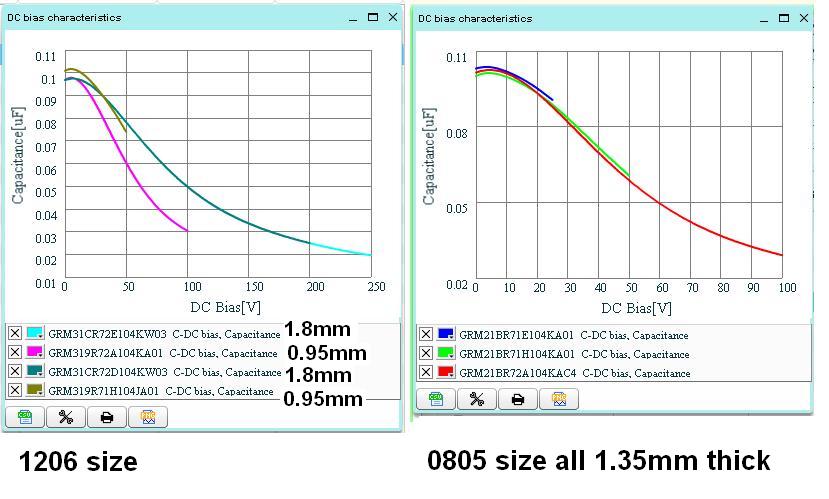

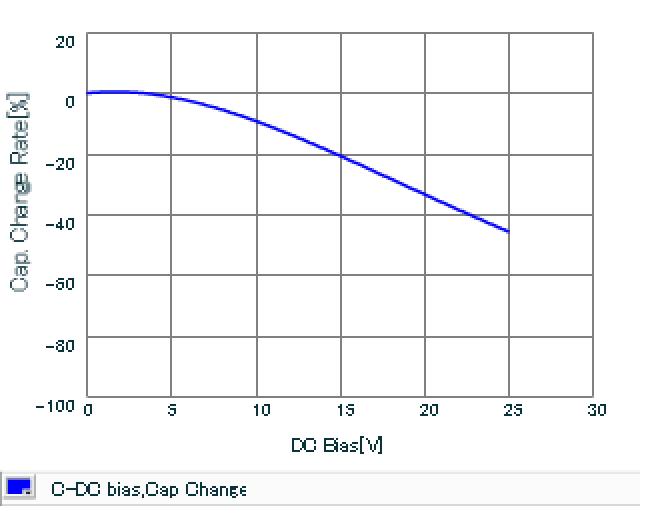

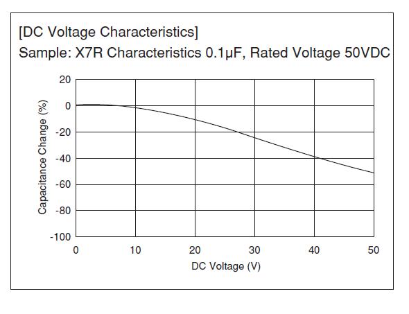

I used 10uF 16V 0805 DigiKey # 1276-6455-1-ND in my little preamp and was not expecting the capacitance
to drop as the Voltage goes up. The capacitance goes down by more than half. Just something to be aware of.

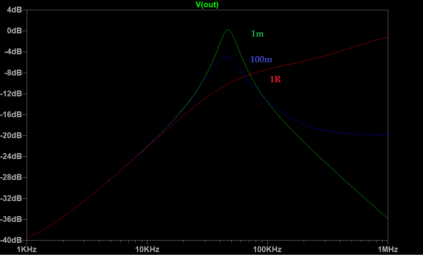

LT1963 is my favorite OEM poz regulator, but noting this, the ESR of the output cap plays a huge role in stability.
By sweeping the load current one can judge the stability of a regulator with feedback. This example assumes a 10uF with ESR of 1milliOhm, 100milliOhms and 1 Ohm:
