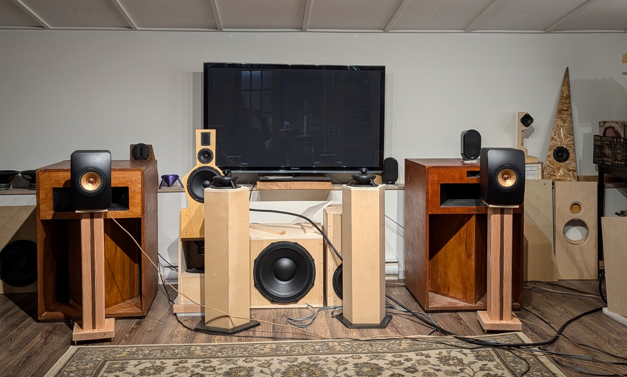

So I did manage to get the bass section of the Linkwitz Orions set up as dual-mono subs for the LS50 Meta. Wiim sub out>phono splitter>amps>dual Orion woofers -- a pair on each side. The EQ for the Orions bass was replicated using the PEQ function in the Wiim Amp. I got it pretty close to the original EQ in the miniDSP.
The end result was a much fuller sound and deep bass with the LS50 Meta. I tried a variety of crossover frequencies, from as low as 80Hz to as high as 150Hz. Best seemed to be 120-130Hz. It was quite a nice tidy pleasant presentation, but a bit too tidy at times. Switching back to the Orions always brought a sense greater relaxed openness, fuller range of harmonics (??) & authority. That switching was only done a couple times because the process was rather fussy, a PITA.
My decision in the end is to switch back to the Orions. The KEF LS50 Meta experiment is over.

The KEF LS50 Metas got moved to my studio. The stands were equipped with spikes to make them more stable, and driven with one of the 2x150W amps from @Erica.C They sound considerably better here than in the house by the TV. If they sounded like this in the house, I would have accepted them and moved the Linkwitz Orions on elsewhere. The simplicity of stereo amp is such a big attraction for the house. But they didn't sound like this in the house.
The 3' sealed sub with SBA 15SW800 was sitting between the KEFs, calling out to be tried.... so naturally, I complied. I used the EQ settings that make them flat to ~25Hz, set the crossover (miniDSP) at 120Hz LR4, and set levels between the KEFs and the subs by ear. The latter, driven by one channel of a 2x150W amp, required -8 dB reduction.
Now this is not far from what I hear with the LX521. Very impressive!
