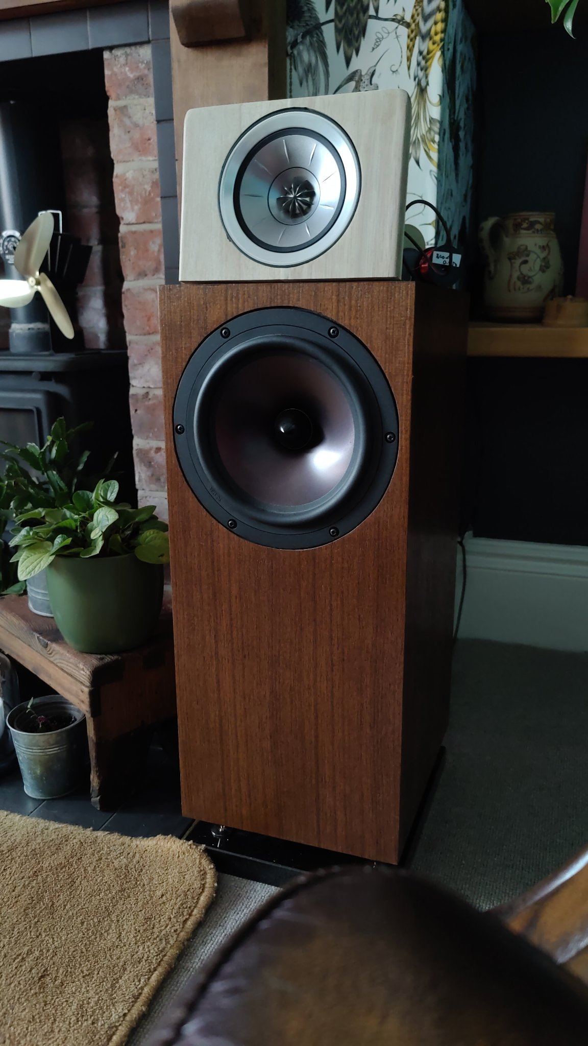

Kef reference of coax used in ls50 meta. I used it in my own box.

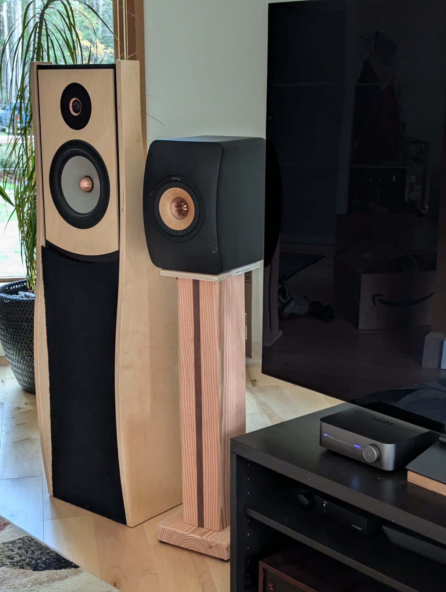

AH! It's one of the things I wanted to try but was stymied by lack of supply and extremely high price -- typically US$400 each + $100 shipping on ebay from HK. Way more than the ~US$650 I paid for my used pair of LS50 Meta. The enclosure is spiffy -- lots of great tech in there, quite hefty @ around 18 lbs.
Interestingly, I didn't notice for the first couple days that the rear ports had foam plugs in. When I took them out, the improvement in my environment was enormous. The sound had seemed a bit congested & small before but after the ports were opened, it became more expansive, open, with better illusion of bass. I'd guess the previous owner had them up against the wall.
At the moment, I have a couple of experimental enclosures than can be used as subs, and am working on a dedicated pair of stands, too. After testing with a single sub (with closed box 12" SB34SWNRX-S75-6 or Dayton 10" RSS265HF-8) and the 300W amp mentioned above, if it works out well, I'll consider putting the Daytons in 2 enclosures built as stands for the LS50 Meta. The fact that the Wiim sub output is mono is a bit unfortunate but probably not a big deal for this mostly TV media system if I cross at <150Hz.

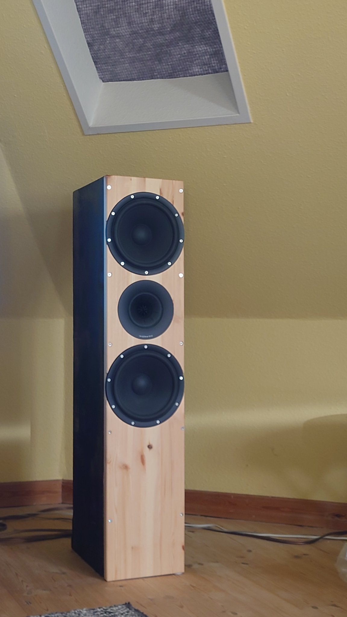

I bought Q150 pair from discount sale a year ago, to make it 3.way. The project ceased because they found end user as is! diyaudio has at least two threas for Q150 mods.
Did the same....

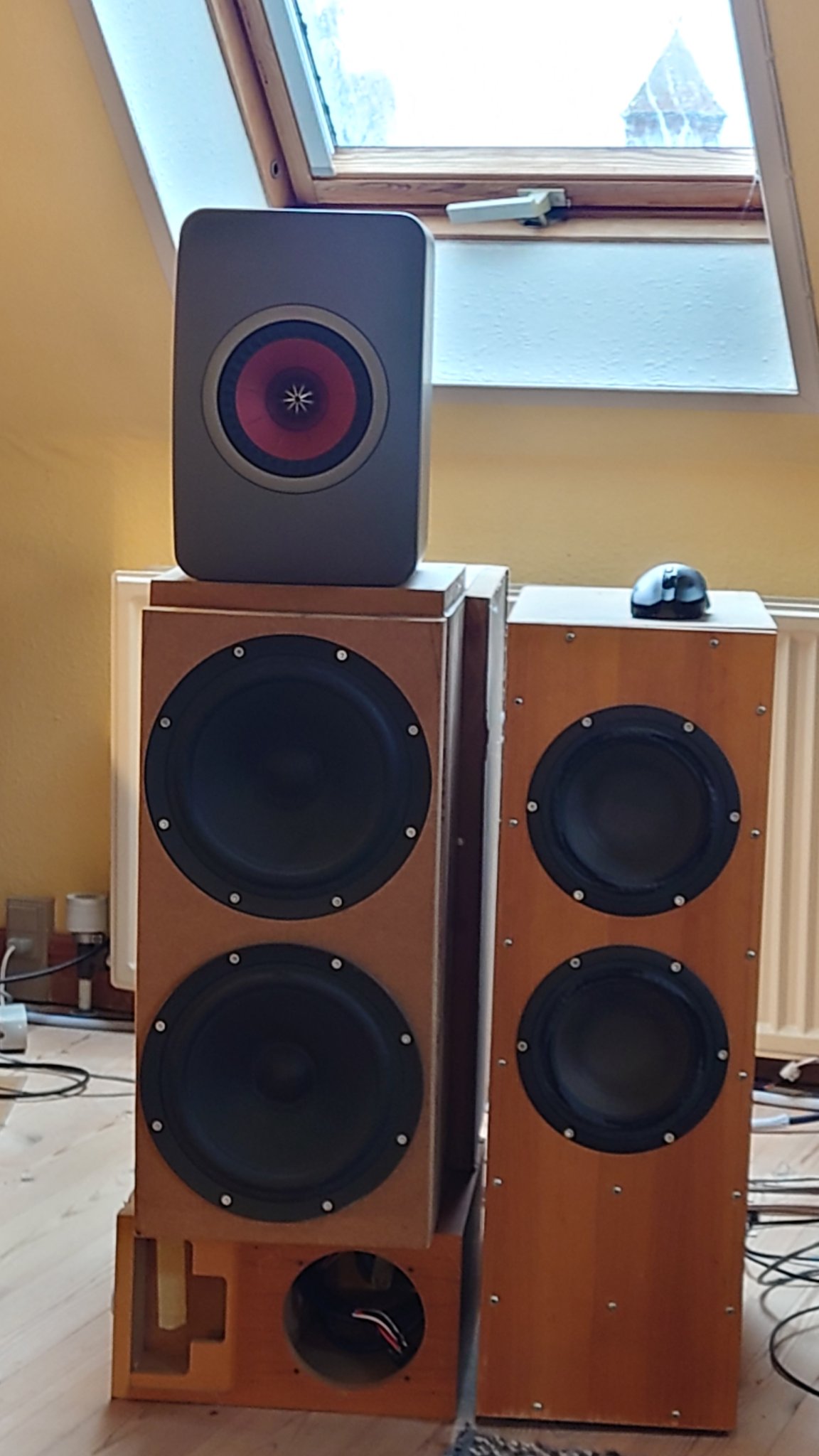

The little KEF has little punch below 3-400Hz in larger rooms. So any woofer capable of going cleanly to 400Hz and down to where you wish or cross to subwoofers.... Should do. RS225 in closed boxes with two subwoofers, would be my minimum goal. Woofers on the picture is just the purifi and SB I happened to have laying around. LS50 Meta are now sold to my sister for her kitchen, and I use a dedicate KEF R version instead, with two WO24P and 4 subwoofers.

Current test setup of my copy of R900. Adding two 9" woofers below 400Hz, really gives a much more powerful realism to voices and lower octave instruments.

Maybe I'm missing something but don't the LS50 Meta & the R series use the same "12th generation Uni-Q® driver array with MAT™ "? Hence the reference to "R series coax" is confusing. If you're referring to the whole speaker system and not just the driver, certainly it's easy to believe KEF would have done better with the pricier R series, but you're only using the coax driver, right?
Oh.. sorry for not being more precise.
I have the R series dedicated coax from a 2018 R3 speaker. It has a much flatter suspension than the driver in the LS50, which smooths out the response because of less obstructive interference and less xmax. The Z suspension which is necessary for the LS50 to have more xmax and deeper bass, require some compromises.
I'm biased... I know. And maybe it's mostly technical and measurable, and something you can hear. I just like to have the best technical solution for a given purpose, and I needed a dedicated midrange, not a midwoofer.

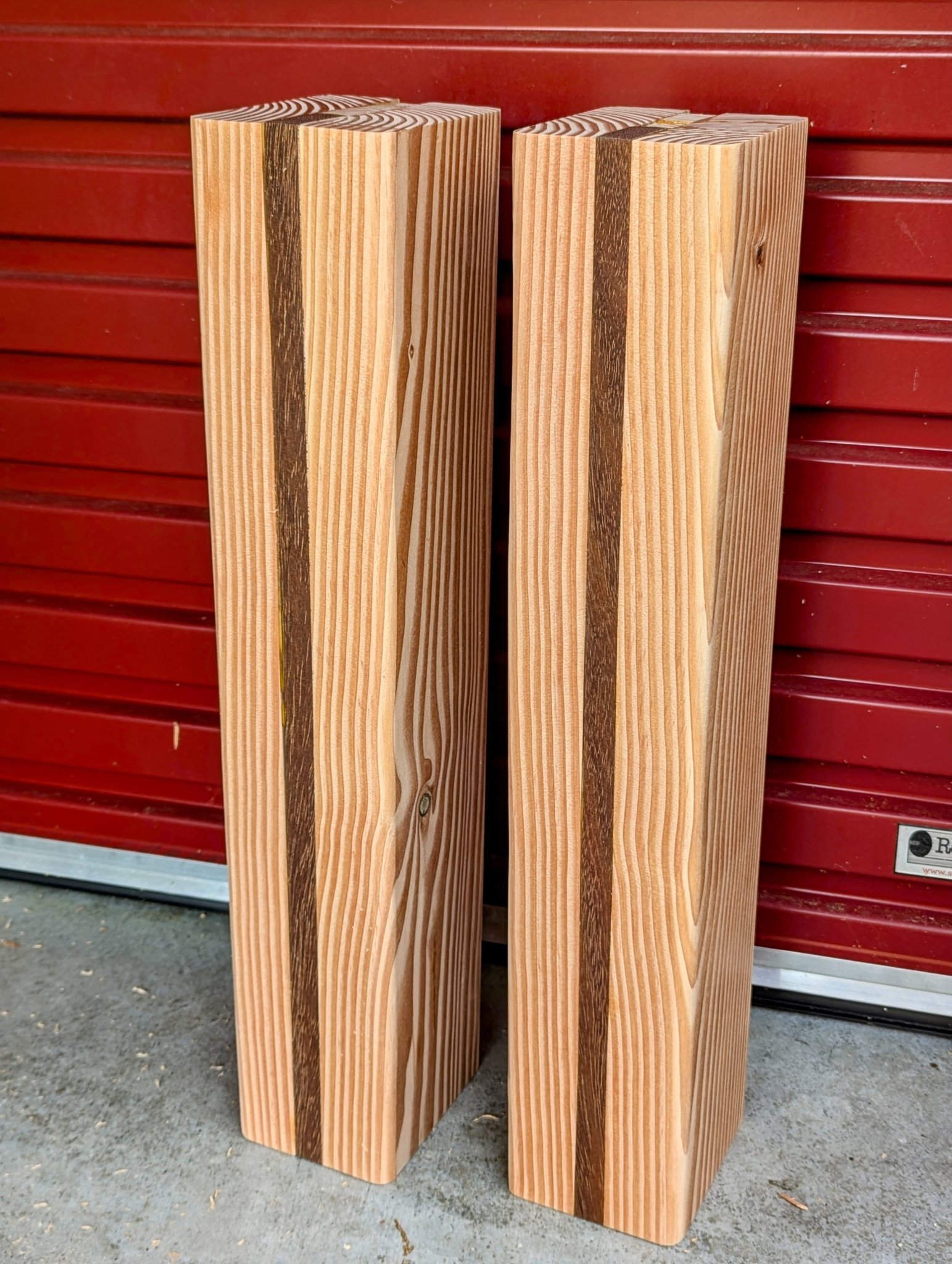

Working on proper stands for the speakers. 25" tall posts mostly ready, made of fir milled from windfall tree here a few years ago, then kiln-dried. The center inset is recovered ipe (I think) trim from 2018 house renovation. They're quite heavy, I'm guessing ~10 kg each.

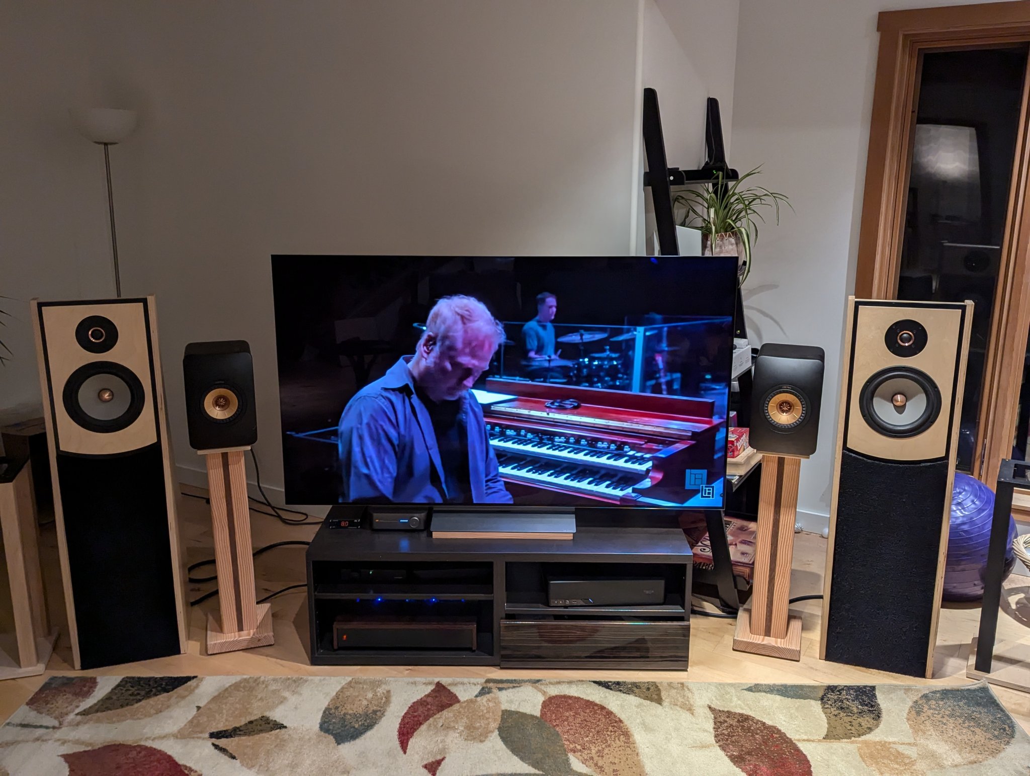

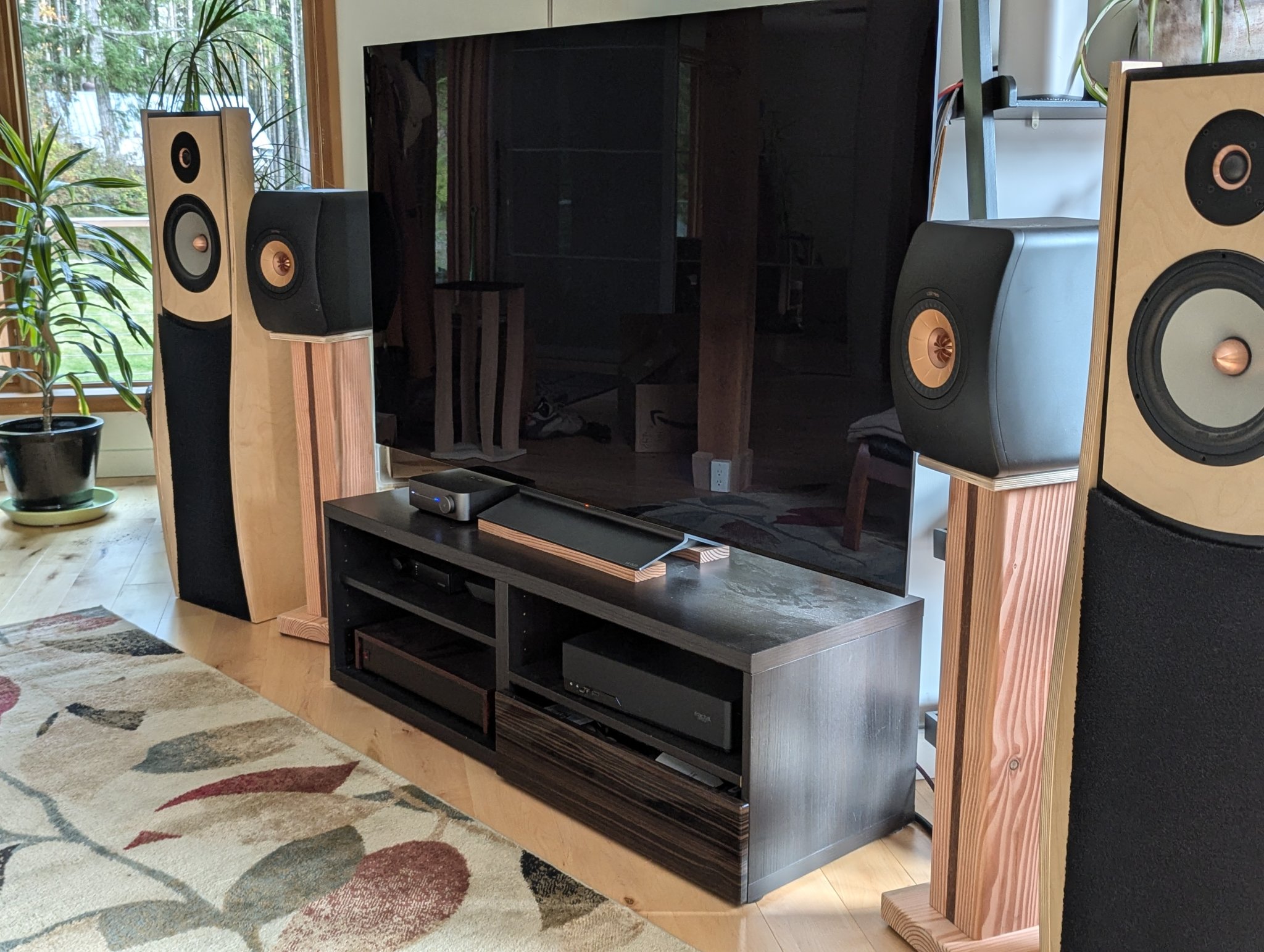

After an afternoon of comparing the LS50 Meta vs the Linkwitz Orions as a music-only + youtube + netflix conduit through the Wiim Amp and LG 65C3 TV, I am thoroughly conflicted.
The Orions have the big wide-open presentation I associate with dipole + deep natural bass of the 4 10" Peerless XLS woofers in H-config. They are very dynamic, detailed & can also play more comfortably louder. The KEFs, within a smaller tidier soundstage, are as involving after a few minutes of acclimatization, and especially for audio tracks in videos (movies, series), might have a bit of an edge. This edge is not enough because it's easy switch the PEQ in the miniDSP crossover to enhance speech intelligibility and reduce the bass a touch for TV/movies. I still haven't had time to complete suitable subs for the KEFs for a fairer match. This is all with the speakers about 7-8' apart, 2-3' from the wall behind the TV & speakers, and me sitting 9-10' away.
One thing is crystal clear: regardless of which speaker systems takes permanent stage in my LR, a control unit with eARC HDMI is an absolute MUST. Amazing how nice it is to have! A Wiim Ultimate might soon be in my future. 😉
The 2 speaker systems were actually run & controlled through the Wiim Amp -- the KEF in direct speaker output, and the Orions + miniDSP OpenDRC-DA8 via a Topping D10 connected to the USB output of the Wiim. Yeah, the Orions had the disadvantage of one extra component through which the signal passed but... they still came out ahead overall.
