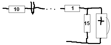

What do you mean with "a little too much" with 15R? Are you talking about:
(a) Too much attenuation of the treble?
(b) Lost of coherence? (If so, replace the 6uF after the resistor with 1.8uF)
(c) Lack of sparkle or "dead" sound? (If so, combine the 10R at the input with L-PAD made of 1R and 15R)

13R maid with 12+1 in serie was not enough because the brighness peak can be heard. 15R is better regarding the peak of brighness but the voice and the middle is too muffled ! So a) and a little b) too because mostly heard in the middle (voices are too muffled and heavy...they have to be more pristine, clearer...not so warmer). Maybe your c) description is what i want to write : muffled=dead sound like a cover plate on a nasi goreng : you don't hear the oils boils...
Wich 6uF are you talking about ? The 8 uf // 6 uF of the first cellul in the 4° order filter ?
But there is so little difference in DB attenuation between 13R & 15R : 0.7 DB. And the initial tweeter attenuation is 10R//1uF in serie. Without the cap is better every where but one exception is near than the best results I test. It's : 1R in serie with the initial 10R//1uF !
So I have to test before your C) : Initial R1 10R without the //1uf and R2 L-Pad with 16R (15+1 serie).

You should not write 15+1=16R as the L-PAD has bigger effect at attenuation than series R at the input, or shunt R cannot be added with series R in a L-PAD (it is simply a voltage divider network).
The (C) is like I posted before, that above 10R at the input the sound tend to become "dead". The biggest I have experienced is 12R2. You can replace the series R at the input with an L-PAD, but L-PAD is worse (also the "dead" sound) so the maximum attenuation without deadening the sound is the combination of series R at the input around 10R and the L-PAD with series resistance no more than 1R.
The (B) is, yes, the 1.8uF is to replace the 6uF so to reduce from total 14.2uF to 10uF. This is to restore the phase coherence of the original network (which was changed with your 15R modification)
Ok understand know : 1 ohm is the serie added resistor to the initial 10 ohm and 15 ohms is the shunt value of the L-Pad (=R2 in the L-Pad) shematic...
Do I have to test with the 1uf// to the 10 ohms too ? No matter if the serie added 1 ohm is at the beggining of the filter (in front of or just after the 10R//1uF and th R2 shunt at the end near the driver ?

The 1uF effect is more or less to increase the top end of the treble response. It seems that the top end is problematic so I believe your ears that it was better without it. Besides, even tho this kind of network is considered "smart" by experts but believe me I'm against such network.
I think you got it wrong. What I mean is:
10R at the input (the 1uF removed), then next to the tweeter you have 1R (series) and 15R parallel (across plus and min of the tweeter)

Ok, The two resistors of the L-Pad need to be together.
I'm going to start it. Say to you tomorrow the result...
