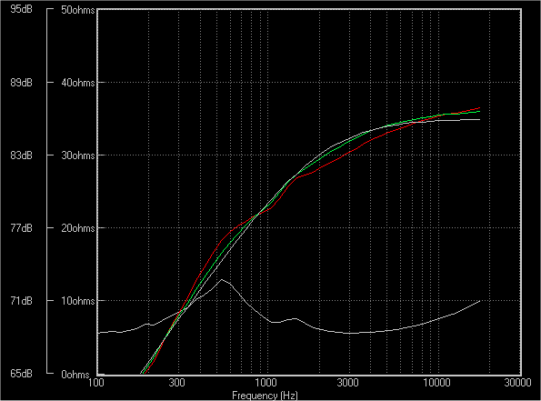

I've run a comparison where: the upper grey trace is a plain 6dB slope, the red trace is an 8 ohm parallel and 4 ohm series L-pad with a 10uF capacitor using the shown impedance.
The green trace is from reducing the parallel resistor to 2.5 ohms. The series resistor needed to be reduced to 1.5 ohms and the capacitor went to 25uF.
