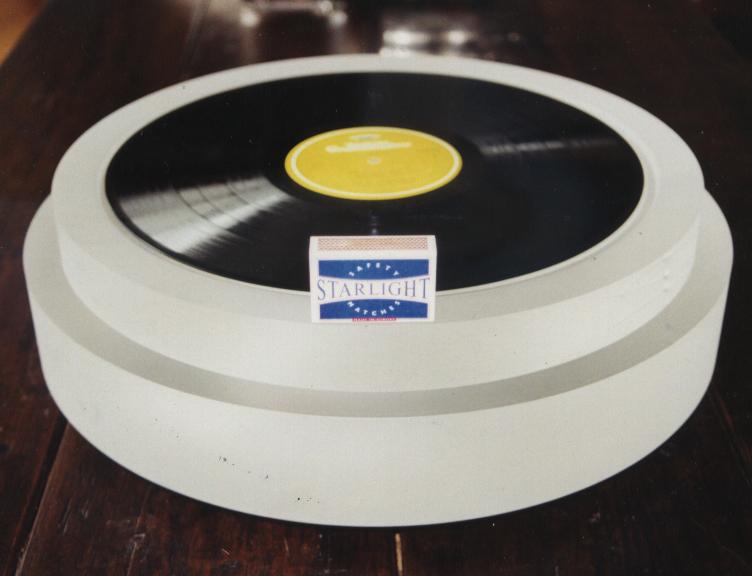

Hi Hugh
The POM/Acetal was stacked to the SS because POM flat plate warps when machined. The SS also keeps COM low and provides inertia.
POM thickness has an impact on sound quality. I made myself 2 platters POM bonded to gunmetal, 1 has 10mm POM and the other has 20mm POM both bonded to identical gunmetal bases. The 20mm POM has far greater detail retrieval and lower noise floor than the 10mm. The 10mmPOM/GM out performs the stock platter and bare SS with OEM mat by a large margin.
Bon sent me another 20mm sheet of POM I will be bonding this to an OEM platter shortly. It will be interesting to compare this to the POM/Gunmetal and POM/SS.
On a side note I removed the damping material from the bottom of the platter I will be bonding the POM to and found that the damping material had hardened and the glue (contact cement) had failed in many spots, rendering the damping ineffective.
Warrjon, Bon,
Nice project! How thick will the Gunmetal be? How will you bond it to the POM?

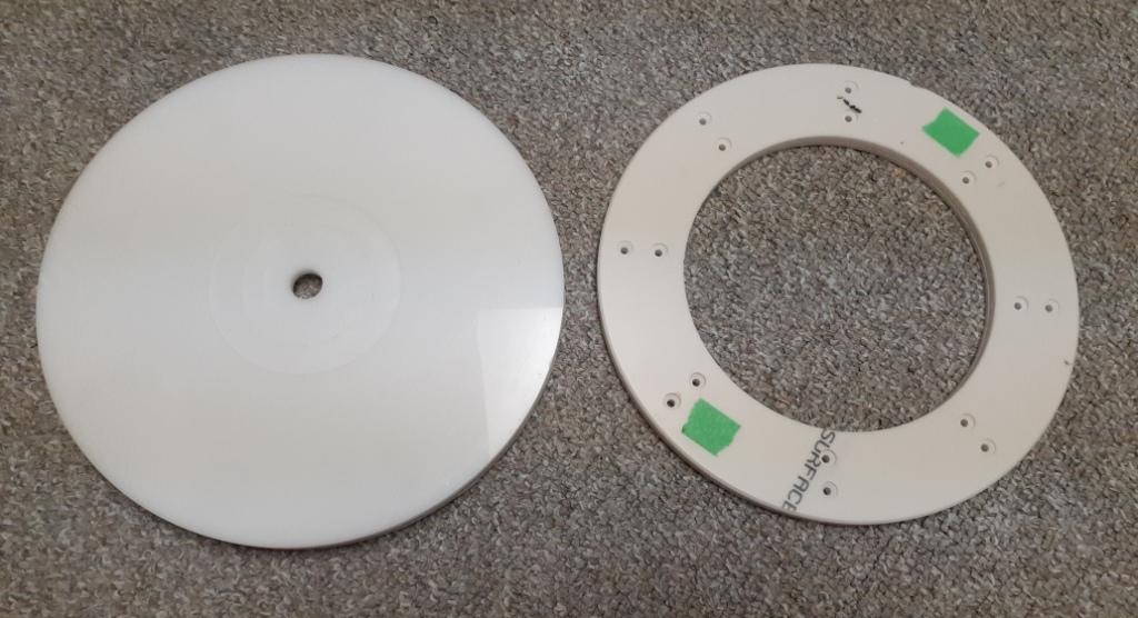

Prior to ordering a Tangospinner Delrin platter, I tried some 3/8" Acetal using two different backings. Like you said, flatness is an issue.
The cream coloured ring is Corian, The biege one is bamboo. I liked the bamboo one best. I may try other backings later.
I'd love to hear how your 20mm one goes.
Thanks,
Hugh

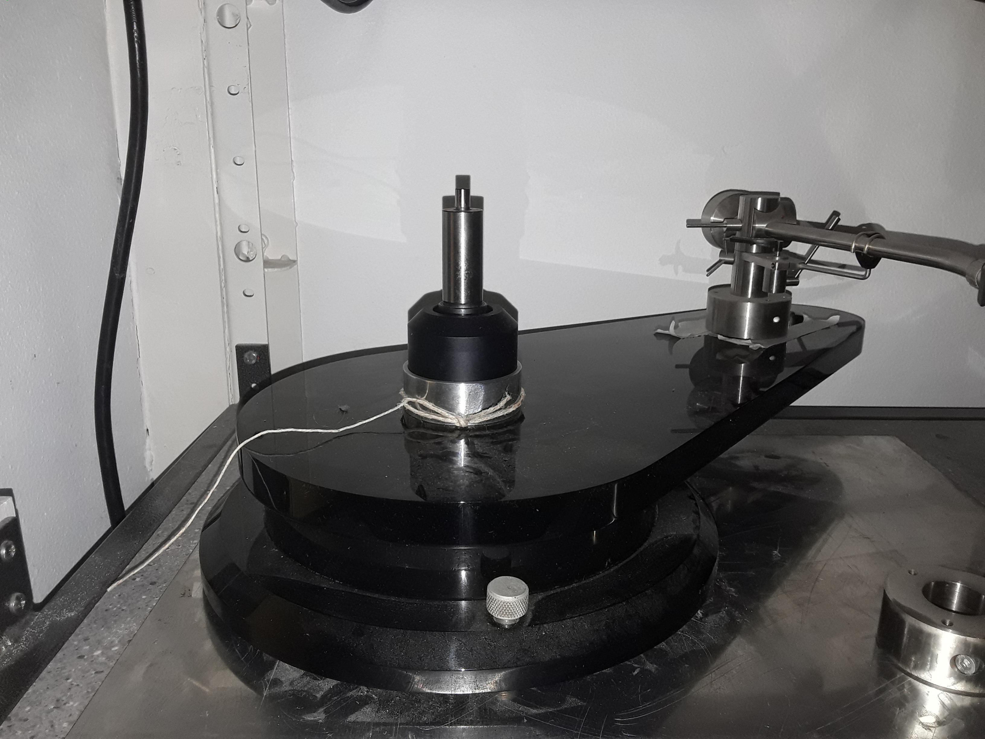

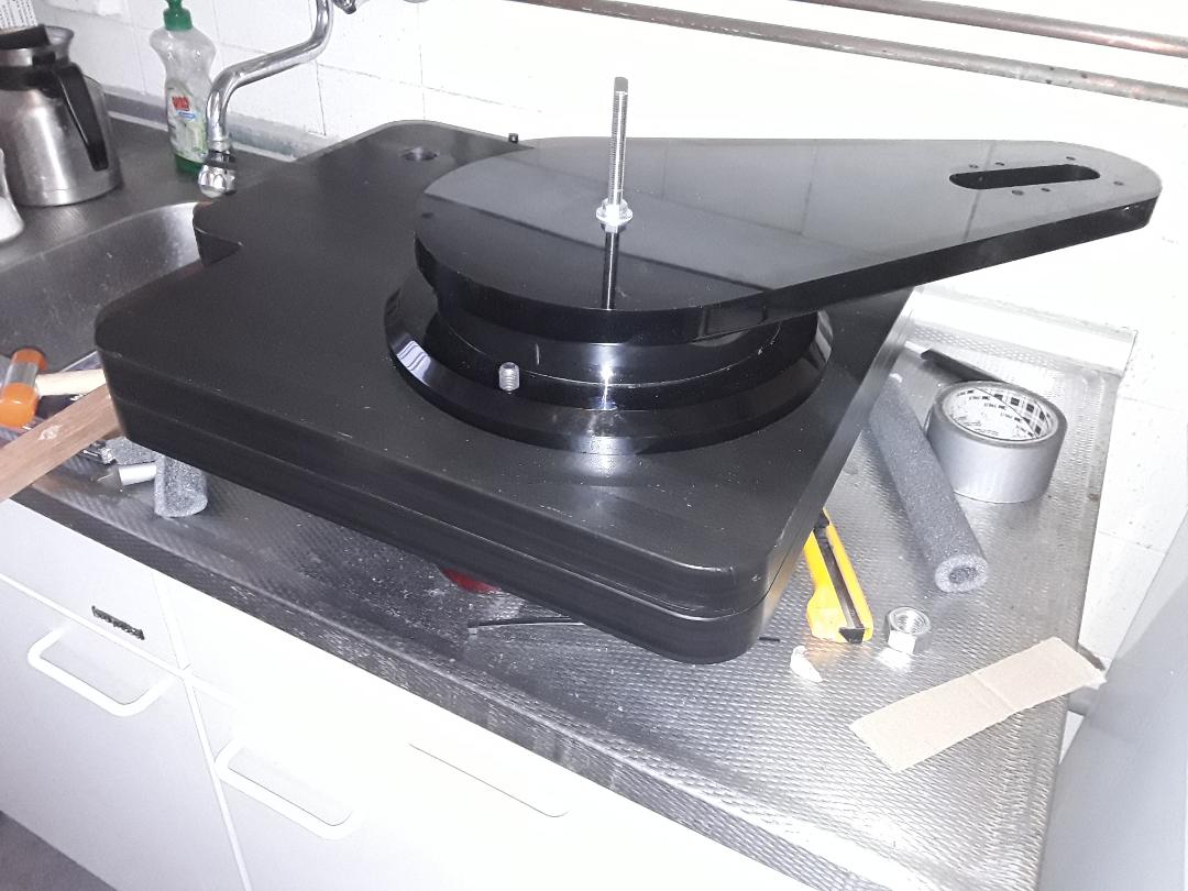

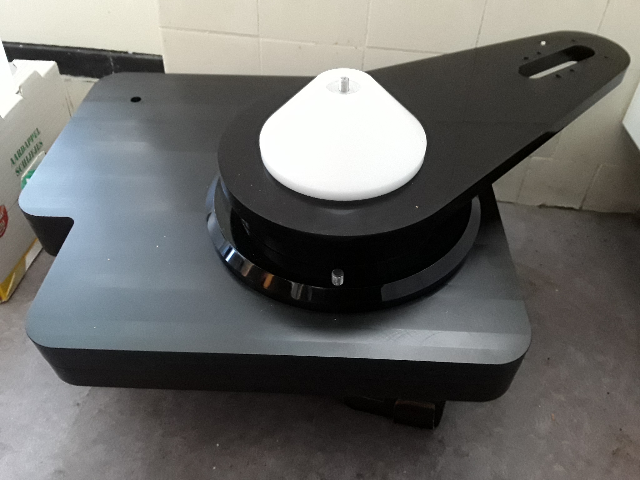

Hello,
I have a made a turntable '' base '' with pom.
Pom material is very difficult to glue. I never try to glue it because i knew it takes a very special glue.
My base consist of two pom CNC machined plates connected together by nylon bolts. I made some M8 or M10 threaded holes in one of the plates. I wanted to use bolts that would have similar properties like the POM anyway no metal bolts.
Greetings, Eduard.
P.s as you can see i also got the arm base and the motor base machined from POM
Hi Eduard,
Looks good. Is that lead shot I see in one photo?
Hugh

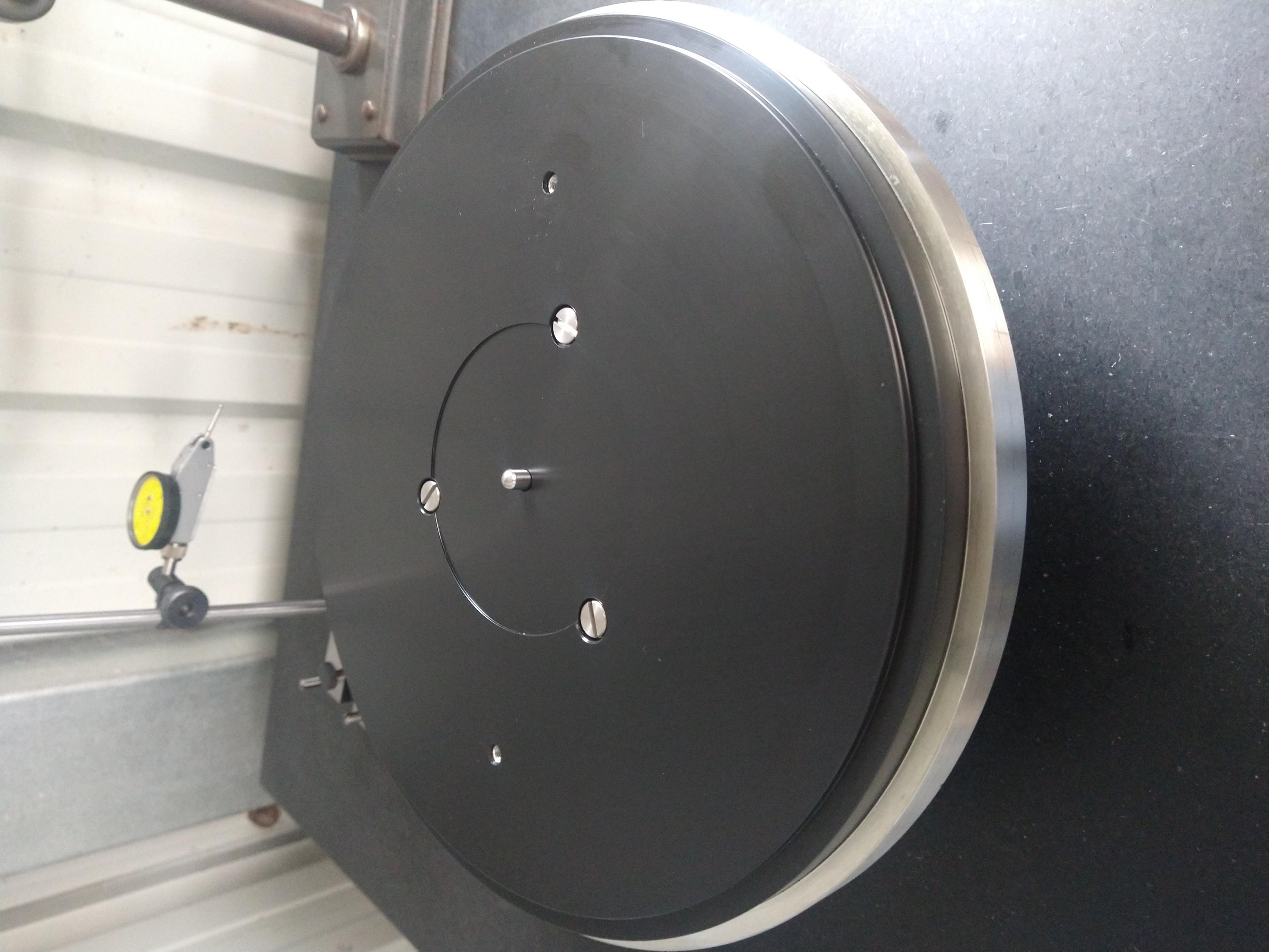

First pic is Bon's platter this is Stainless Steel / 16mmPOM the second pic is my gunmetal / 20mmPOM.
Bon's platter will not fit a stock SP10 as it was made to his specification to fit his Kaneta SP10.
This GM / POM will fit a stock SP10mk2 chassis but I have had issues with voids in the GM so have machined my platter smaller OD (approx 315mm) to remove these voids. Mine uses 20mm POM which leaves the motor spindle below the top so a secondary spindle was made that does not touch the motor spindle.
As I said I am going to bolt 20mm POM to a stock platter and test it against the SS and GM / POM, as both Bon and I suspect the POM is doing all the heavy lifting regarding noise floor and detail retrieval.

Hello,
Probably it will be beneficial to not use a metal connection between the metal and the pom because it will function as a kind of '' bridge '' for the vibrations to pass from one material to the other one. And i think the aim is to get the transfer all over the surface.
Maybe using a kind of plastic bolts or a kind of dowel ( wood or even a teflon rod ) could work. If you make it a tight fit and make a little hole in the center the teflon can be '' reshaped '' to get a good grip. You wont needed any glue.
Greetings , Eduard

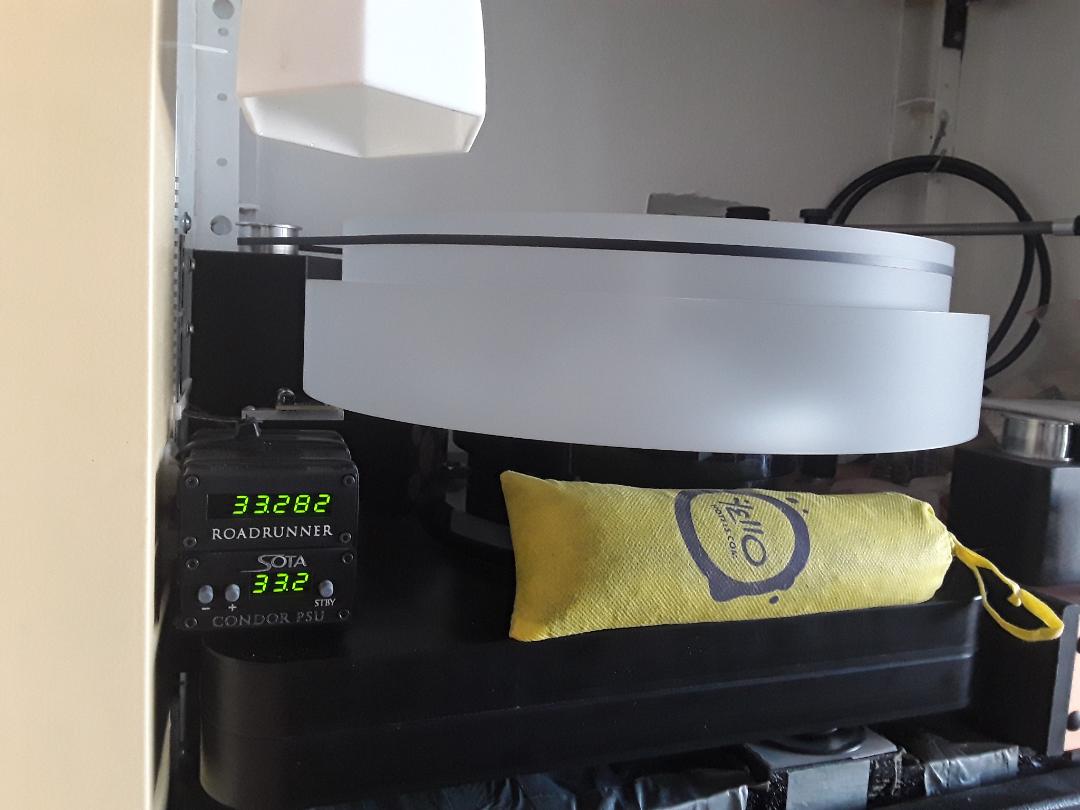

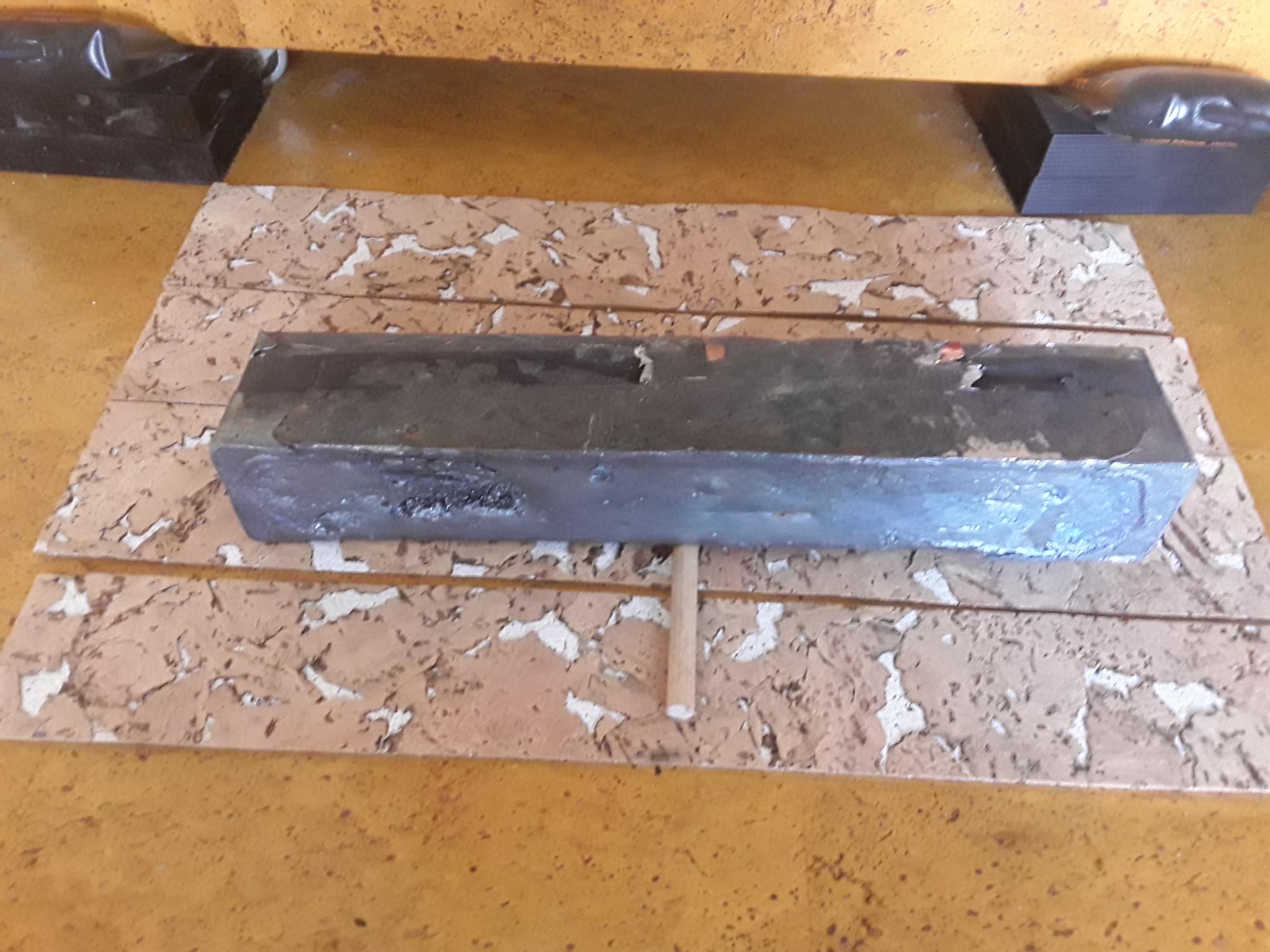

Hello Hugh,
It is indeed lead shot and some cavities are partly filled with some foam because the actual turntable base that is attached to the two pom plates by means of 3 holes will move the center of gravity away from where you want it to be. You want it to be close to the platter bearing. This will allow me to have a very similar load on all 3 feet ( Townshend seismic load cell) because you want them to work in the same conditions. As you can see there is more pom material on the '' wall side '' of the base AND that will also be the area where motor housing and arm base are located so you need more lead shot on the '' front side ''
I have done a test to locate the exact center of gravity by balancing the complete unit on a rounded bolt and nut.
The pom motor housing has lead filled cavities with different diameter and going in different directions to get an irregular '' volume '' for the vibrations to travel through.
Normally the platter is attached by the a big bolt and an inverted bearing. With this platter this will create a big cavity in the center of the platter. SO i decided to have a special shape white pom to fill the gap leaving just a little air ( empty spaces must be avoided in turntables) Had some aluminium threaded part that is fixed onto the white pom and which will be used to mount the bearing creating some extra vibration killing.
Greetings, Eduard

Hi Eduard.
Is you turntable direct drive? I don't see a location for a separate motor, so I assume it is, correct?
What made you choose POM for the plinth material? The data available does not give it a high damping factor. Maybe the lead shot is the main contributor.
Is the platter also POM?

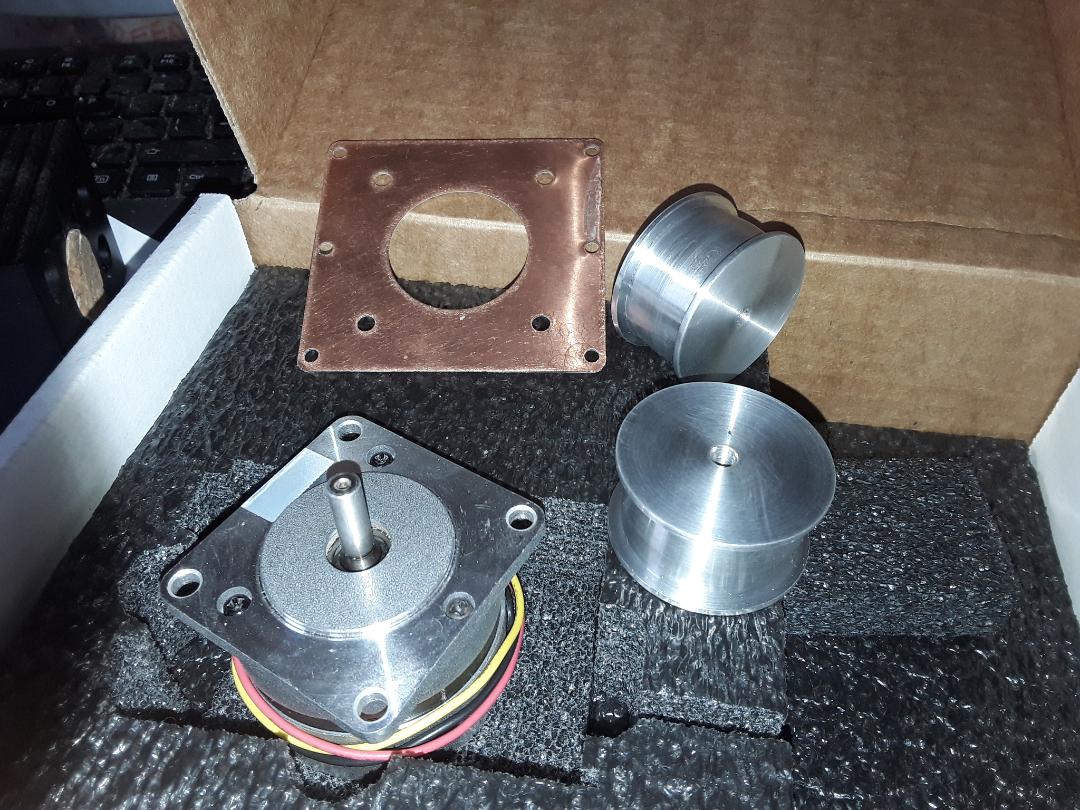

Hello,
It is a belt driven turntable.
The motor is kind of hidden behind the big acrylic platter which i bought from Scheu in Germany LONG time ago. The original base is black acrylic which has a big cavity filled with leadshot
The motor is a so called Sota Eclipse package. I decided to buy it without a housing because i wanted to make a pom housing.
My decision to go for pom was encouraged by some people using this material for diy turntable. If i remember well the properties are close to the vinyl used to make records.
The French also constructed some turntables combining some kind of '' plastic '' and lead.
Greetings, Eduard

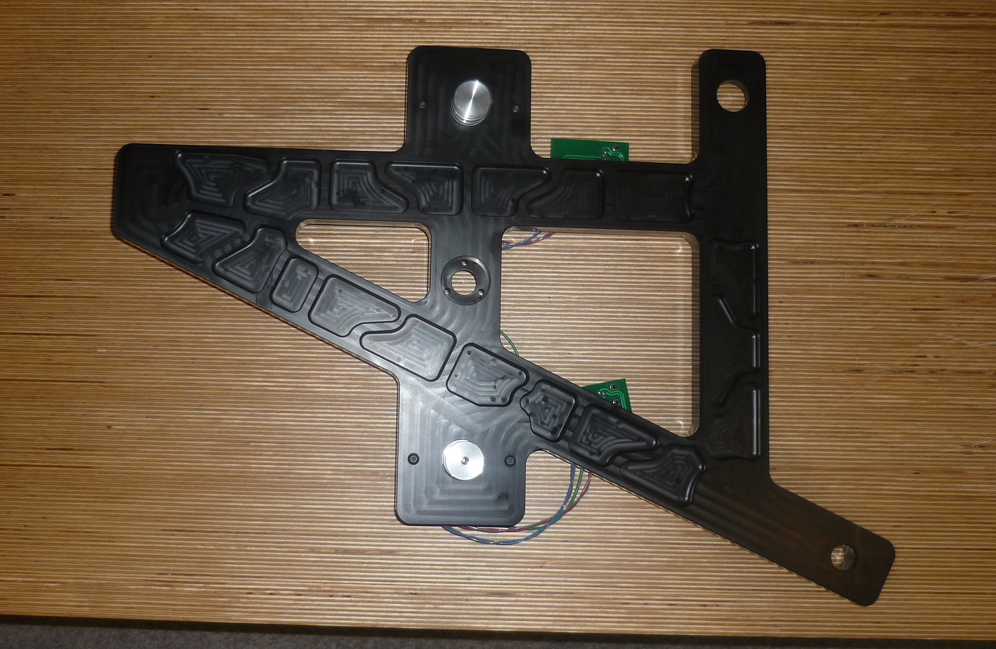

Hi warrjon,
As you seem to know something of Delrin's properties ... I'd be grateful for your advice. :)
Attached is a pic of the TT chassis that I recently had CNC'd out of Delrin. (This was to replace a previous chassis that I had constructed from bolted-together pieces of aluminium C-section.)
My problem is that the weight of the bearing housing and Linn inner & outer platters - located in the circular rebate between the two motor pulleys - is causing the hypotenuse of the triangle to bow. (Given the ends of the hypotenuse are supported by Linn springs.)
So I need to stiffen the hypotenuse. I was thinking of doing this by fixing a length of aluminium right-angle (say, 20x10x3mm) to the underside of the hypotenuse - my question is ... is there a glue I can buy to do this?
Or will I need to bolt the aluminium angle to the Delrin?
If you have any input for my dilemma ... that would be great. :)

Hello Andy,
I have worked with pom before and i never even tried to glue it. IF i would some parts to be glued i would surely ask the company where i got my parts machined for help. If you are building your own furniture there is a huge collection of glue that can be used and that will function for decades. If you wanna make a nice wooden boat your choices are restricted. For your turntable ask a professional.
At my old company we assembled a product that needed some glue. Sometimes the customer took 100 products and after one year there was one part in one product that didnt stay foot. Especially these one purpose glues come with an exact instruction HOW to use it and you can not do it with one line from an instruction from another glue. It might stick in the beginning but could fall apart during transport, temperature change.
What i surely wouldnt do is using an aluminium L or T shape to make your CNC machined part more rigid. I think if you use a T with the horizontal part about the same '' surface '' as the the hypotenuse and the vertical part just 1/2 inch high it will be perfect ( for me!). You could have it machined from Delrin but also from a material close to the properties of Delrin but offering just another type of reaction to vibration. If i remember well the French in the past used materials in this way to allow vibrations to pass from one material into the other to make the vibrations go down.
Bolting them together would allow some material to be used between the two parts . BUT this could introduce some bowing/movement if to flexible. It could well be that a nice piece of lead with a regular thickness ( usually the one from the shop will be good) will allow the added T to add rigidity ( because there will be no voids on either side of the lead) and add some extra vibration killing properties.
