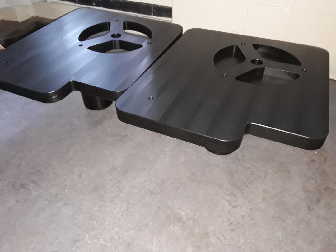

Hello,
I have a made a turntable '' base '' with pom.
Pom material is very difficult to glue. I never try to glue it because i knew it takes a very special glue.
My base consist of two pom CNC machined plates connected together by nylon bolts. I made some M8 or M10 threaded holes in one of the plates. I wanted to use bolts that would have similar properties like the POM anyway no metal bolts.
Greetings, Eduard.
P.s as you can see i also got the arm base and the motor base machined from POM

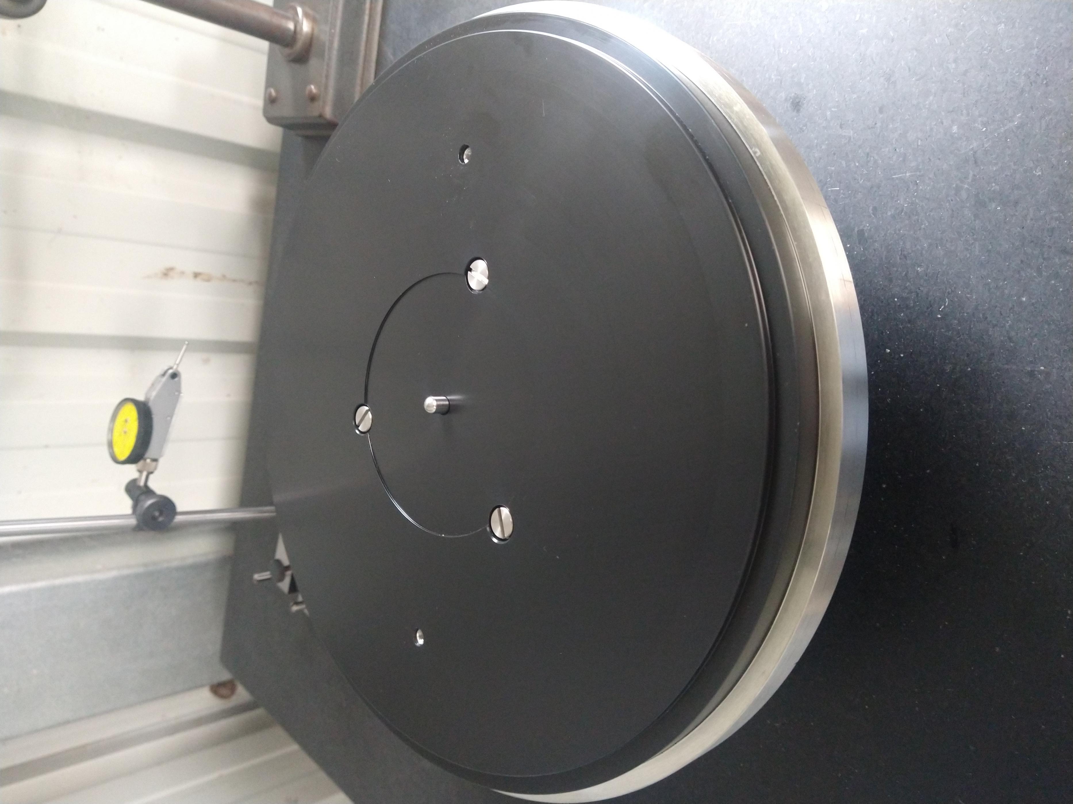

First pic is Bon's platter this is Stainless Steel / 16mmPOM the second pic is my gunmetal / 20mmPOM.
Bon's platter will not fit a stock SP10 as it was made to his specification to fit his Kaneta SP10.
This GM / POM will fit a stock SP10mk2 chassis but I have had issues with voids in the GM so have machined my platter smaller OD (approx 315mm) to remove these voids. Mine uses 20mm POM which leaves the motor spindle below the top so a secondary spindle was made that does not touch the motor spindle.
As I said I am going to bolt 20mm POM to a stock platter and test it against the SS and GM / POM, as both Bon and I suspect the POM is doing all the heavy lifting regarding noise floor and detail retrieval.

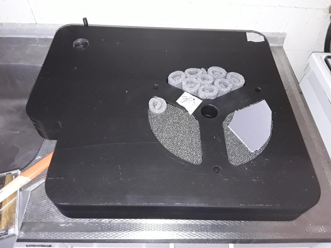

Hello,
Probably it will be beneficial to not use a metal connection between the metal and the pom because it will function as a kind of '' bridge '' for the vibrations to pass from one material to the other one. And i think the aim is to get the transfer all over the surface.
Maybe using a kind of plastic bolts or a kind of dowel ( wood or even a teflon rod ) could work. If you make it a tight fit and make a little hole in the center the teflon can be '' reshaped '' to get a good grip. You wont needed any glue.
Greetings , Eduard

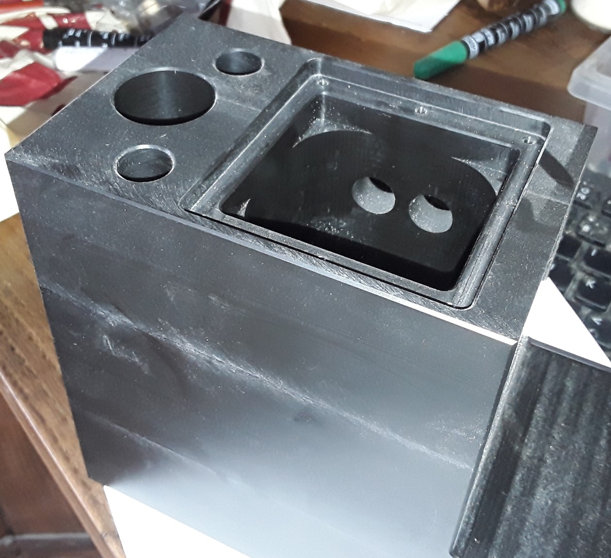

Hello Hugh,
It is indeed lead shot and some cavities are partly filled with some foam because the actual turntable base that is attached to the two pom plates by means of 3 holes will move the center of gravity away from where you want it to be. You want it to be close to the platter bearing. This will allow me to have a very similar load on all 3 feet ( Townshend seismic load cell) because you want them to work in the same conditions. As you can see there is more pom material on the '' wall side '' of the base AND that will also be the area where motor housing and arm base are located so you need more lead shot on the '' front side ''
I have done a test to locate the exact center of gravity by balancing the complete unit on a rounded bolt and nut.
The pom motor housing has lead filled cavities with different diameter and going in different directions to get an irregular '' volume '' for the vibrations to travel through.
Normally the platter is attached by the a big bolt and an inverted bearing. With this platter this will create a big cavity in the center of the platter. SO i decided to have a special shape white pom to fill the gap leaving just a little air ( empty spaces must be avoided in turntables) Had some aluminium threaded part that is fixed onto the white pom and which will be used to mount the bearing creating some extra vibration killing.
Greetings, Eduard

Hi Eduard.
Is you turntable direct drive? I don't see a location for a separate motor, so I assume it is, correct?
What made you choose POM for the plinth material? The data available does not give it a high damping factor. Maybe the lead shot is the main contributor.
Is the platter also POM?
Hello,
It is a belt driven turntable.
The motor is kind of hidden behind the big acrylic platter which i bought from Scheu in Germany LONG time ago. The original base is black acrylic which has a big cavity filled with leadshot
The motor is a so called Sota Eclipse package. I decided to buy it without a housing because i wanted to make a pom housing.
My decision to go for pom was encouraged by some people using this material for diy turntable. If i remember well the properties are close to the vinyl used to make records.
The French also constructed some turntables combining some kind of '' plastic '' and lead.
Greetings, Eduard

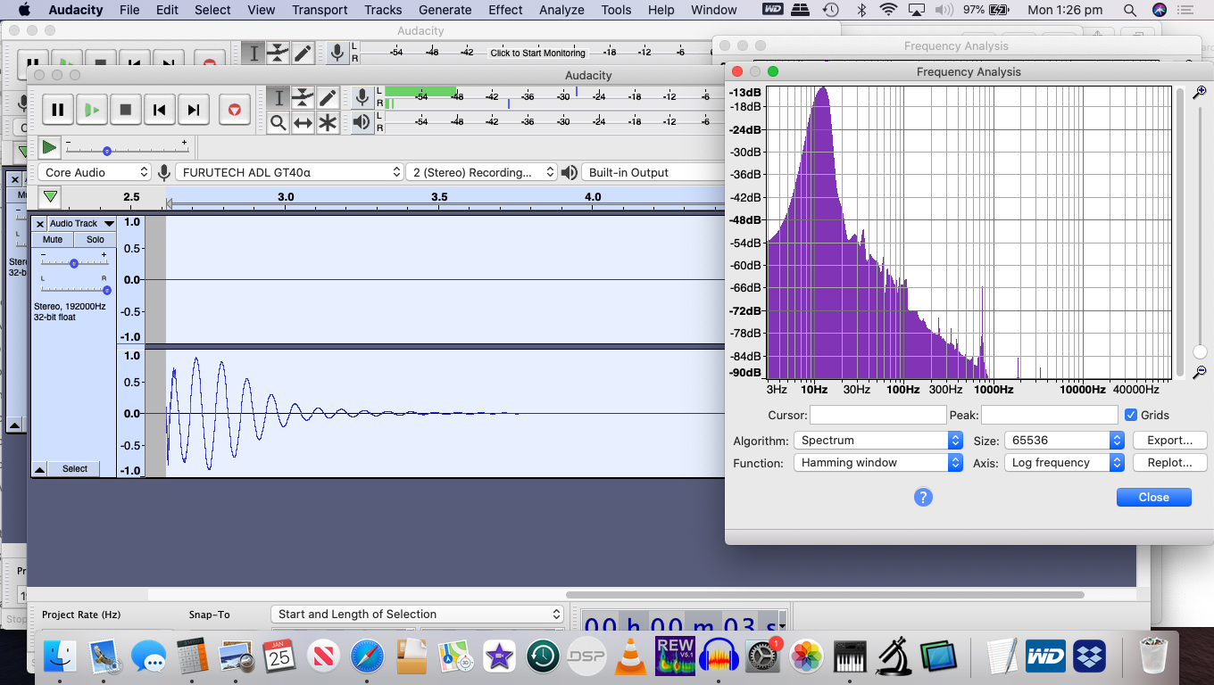

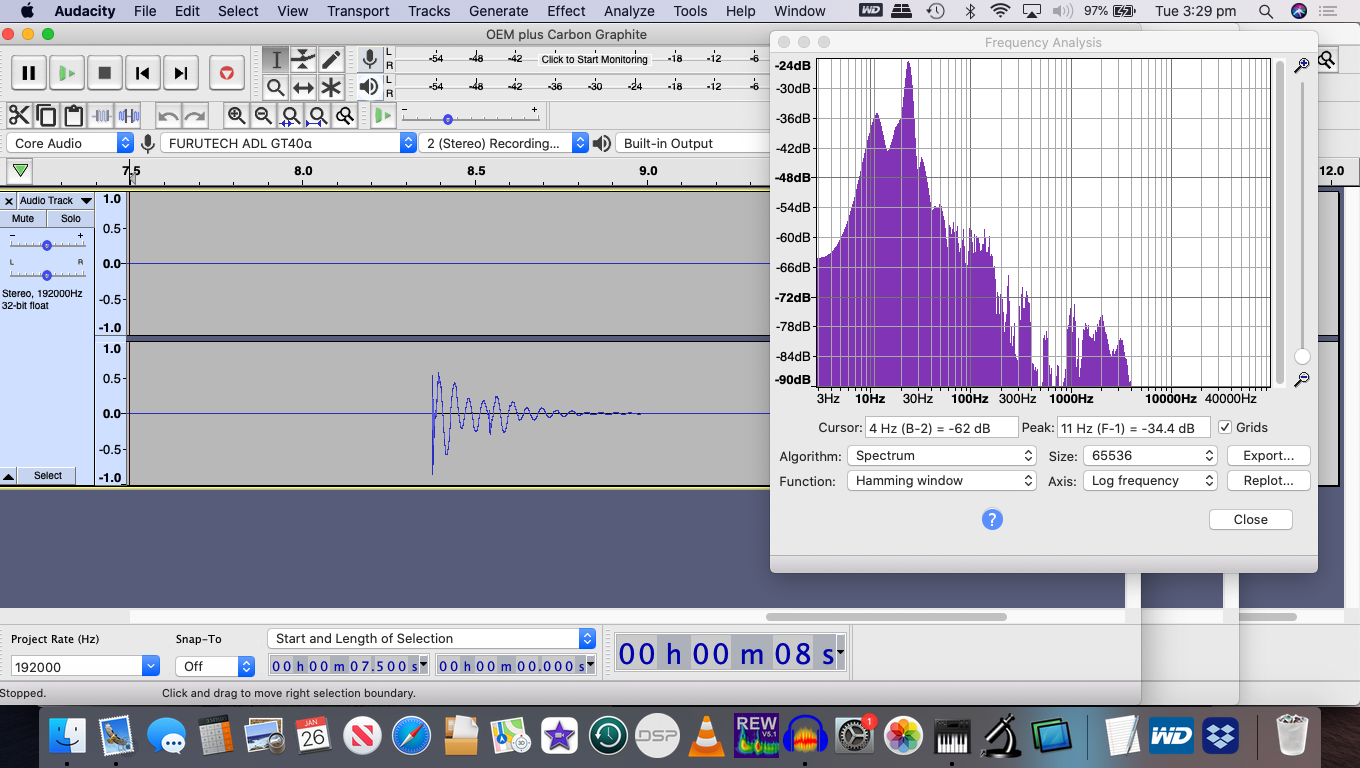

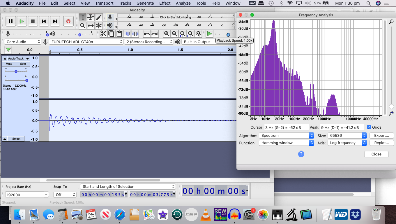

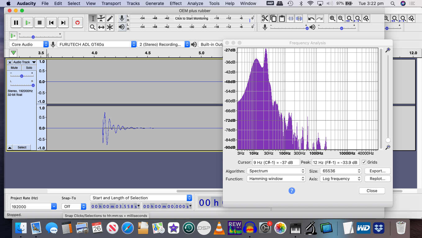

I'll add some of my experiences in setting up a SP10 MKII to this Thread.
As for investigating using differing effects of Materials as a Inter Related Assembly at interface of the TT's:
Platter>Platter Mat Vinyl>Vinyl LP >Spindle Clamp/Weight>Cartridge,
