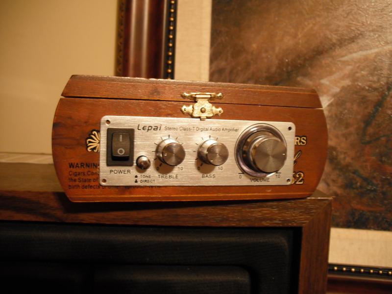

Bare, I tried this and it takes a few more turns with thicker wire. The original wire on mine was appox 0.38mm thick and all measured right at 9.5 uH. I replaced with 0.65mm wire from a transformer. I played with it till I found a 12.5" length would give the desired 10uH. I think it was 22 turns? Best to use a meter.
I left two of the coils untouched on one side and modified two on the other. I wanted a side by side comparison. It may be a little while till I get to test as I've removed everything I want to change and I'm modding a nice little cigar box for it to go into.
Take the oem Teeny inductors Off the board , unwind the hair thin windings, then rewind with the same number of turns (16) of heavier gauge Magnet wire. Instant upgraded Inductor coils, for a half hour's work and 1$ of wire.

Well, I ordered one from PE. As well as a few other things to go with it. 4700uf cap for the power side and a pair of 2.2uf Audyn foil caps for the input side. I plan on bypassing the tone controls and wiping the board of both opamps. There should be enough room for both 2.2uf caps where the opamps use to be.
Originally, I was going to place it in a new case but decided that this little amp isn't worth all that. So, I am just going to bead blast the main case and re-paint and replace the end pieces with something else, just haven't decided on what yet. I am also loosing the spring speaker terminals for binding posts.
I should have the goods in by the end of the week and will follow up with a Mouser order to replace the inductors and caps on the output side.
Should be posting pics after the weekend.
Well, I got the goods in today. But I won't be modding this one. Arrived DOA from PE. Really a let down. Been waiting and researching these things for a couple weeks only for it to get here and not work from the start. It lights up but no sound. Time to contact PE for a replacement.
