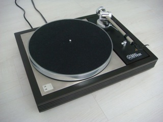

Finally finished installing the LP12 with Marks' DC controller and Maxon motor. Smooth, clean and dead stable
In all honesty i have nothing even close to compare it to. It replaced a Rega P3 with plex platter and Elys cartridge. The Linn runs with a Denon DL103 cartridge.
To my ears the Linn smokes the Rega set up. There is more authority in the base and far more separation across the spectrum. But the mids is were it really shines. PLaying Cat Power is breathtaking.

Your mind operates differently to mine :) I would never consider going through all this effort if i don't have a good LP12 at hand as a reference. The majority of LP12 owners use it with an Ittok/Valhalla and generally complain about bass bloat and poor dynamics. Would have been interesting to know if the the dc motor resolves this.
Sorry, no opinion about spiked feet. I always used mine on a ultralight table and without the bottom cover.

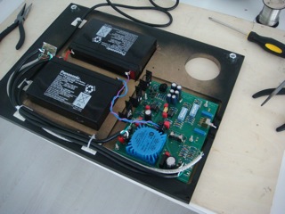

For better or for worse I am generally of the opinion "why use two boxes if you can use one".
It was also a bit of a cost issue; if i factored in the cost of an aluminum chassis with custom face plate and anodized, the project seemed less worth while.
I do not believe i am getting any electronic interference from the components, and call me nieve but since it has a suspended chassis design i was not convinced that adding a little extra weight to the chassis was going to make all that much difference.
The weight of the cells is small when compared to the platter

The base on my modification is 1/2" MDF CNC milled to accept the motor controller and batteries. It is definitely more rigid than the stock Linn masonite base.
The belt is a square shaped 1mm x 1mm. I landed up using a pulley from an earlier group buy with a v-section that accommodates this OEM pulley perfectly. I tried using a Teres pulley with the Linn belt but I had to much drift of the belt on the subchassis. My current solution seems to work well with so far very good speed stability. Of course this could change once the belt begins to deteriorate and stretch. If anyone is interested in this approach i can dig through my records to find the company that i purchased it from. Come to think of it i should order some more to have a few spares.
