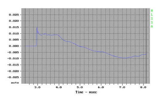

Here is a Step Response measurement of a conventional loudspeaker on and off axis and the second picture is the Step response of the Manger with Holoprofile. The argument is that the origin of sound ( point in time-space ) with the Holoprofile is constant over angle and that a conventional loudspeaker smears the origin over angle. It is argued that the 3-dimensional imaging is more stable over a wider range of angles. I do not find that hard to understand, ones you have made the transition from transferfunction ( amplitude response and phase, frequency domain ) to step response ( time domain ).
