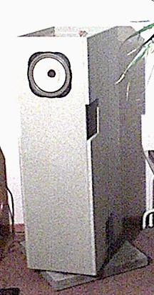

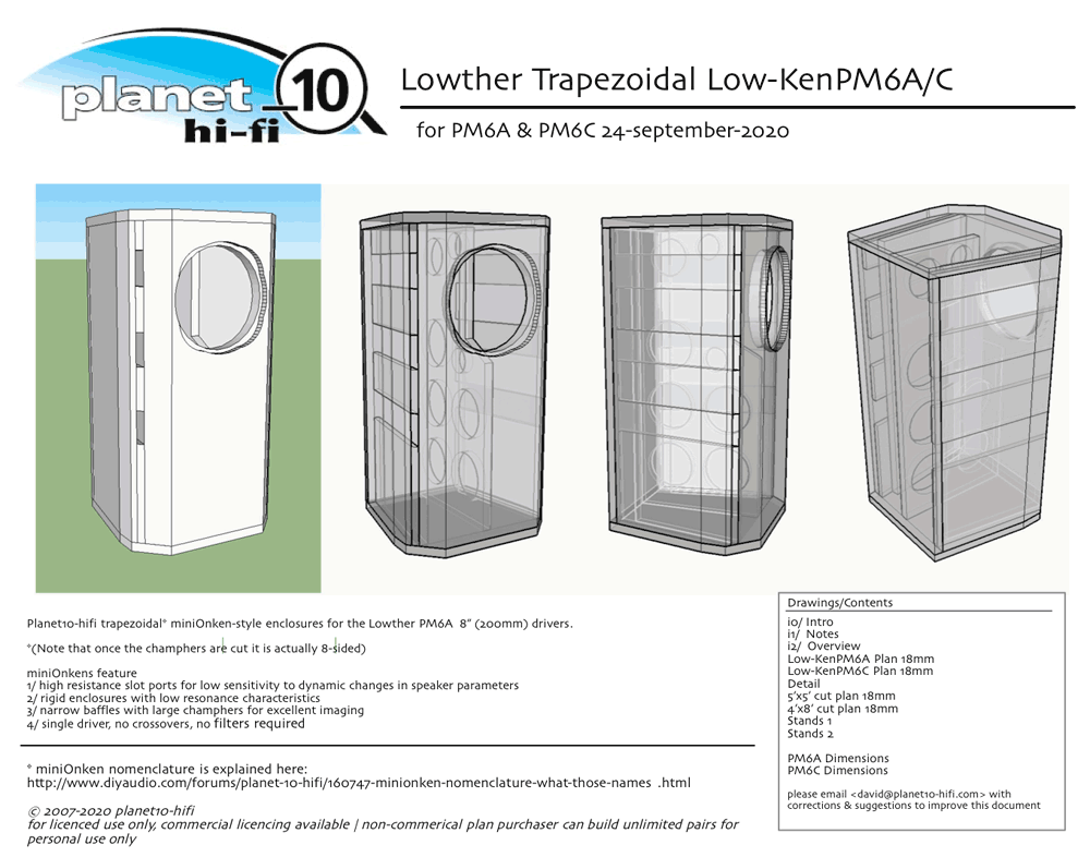

Most lowthers want some sort of horn. I was quite surprised, when asked, to see about PM6, i was surprised it worked in a miniOnken.
Most of the horns and voigts you will find these ar enot so much designed, as guessed.
dave
Interesting. If I understand correctly the plans for the miniOnken of the photo you sent are for sale. I am interested but would need a bit of general info. Can you tell me the dimension? Do you have -3dB frequency point for these, calculated or measured? thanks
Roger

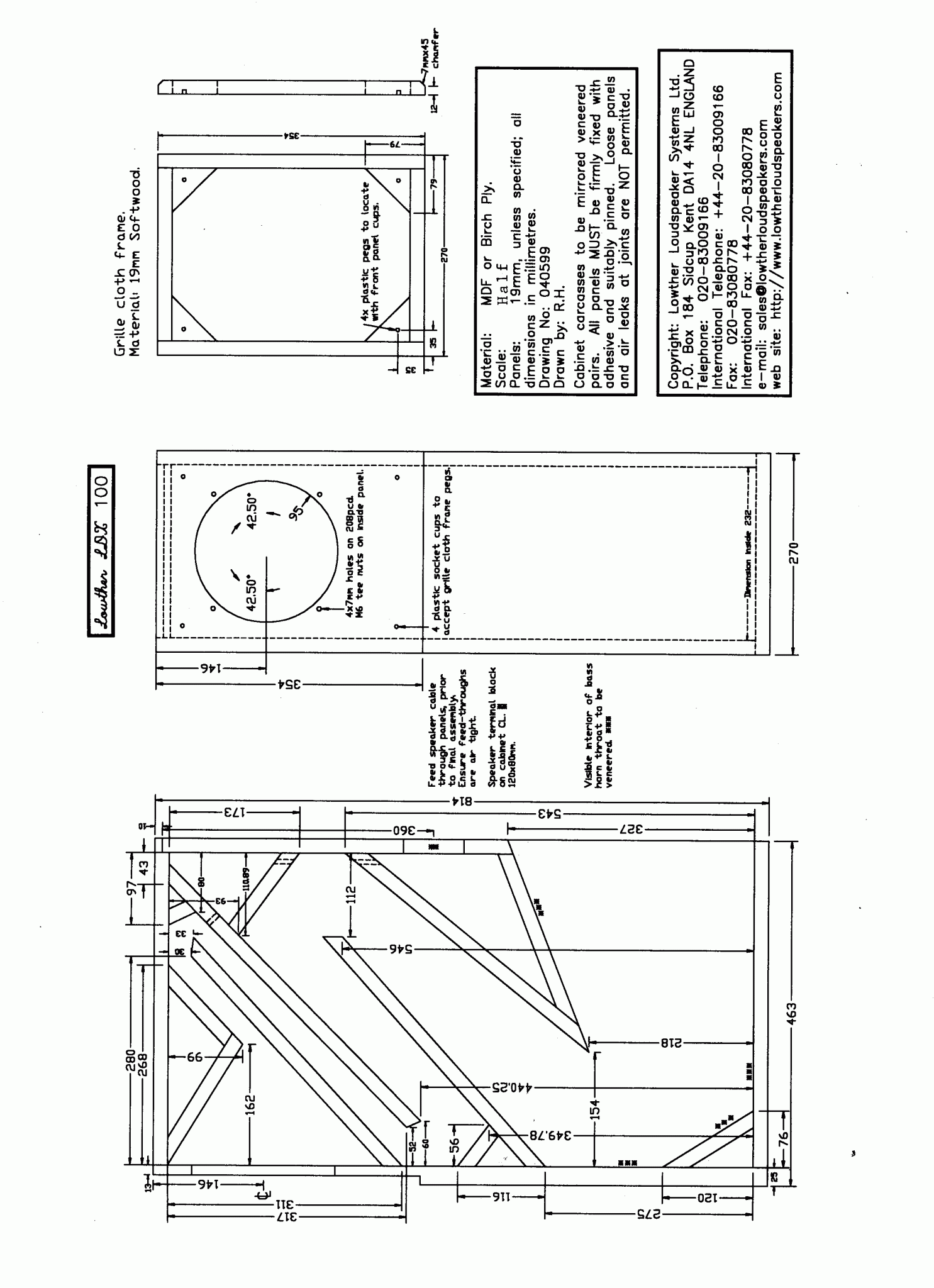

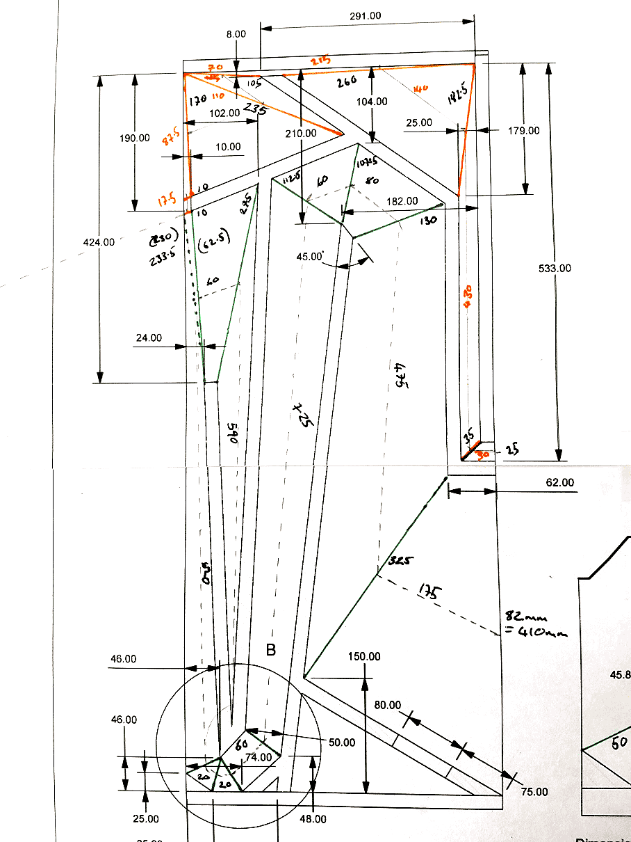

...plans for the Acousta 116...
We built those in 1975. They were sad.
I had a big fold-out drawing. It was not accurate.
Here is what i have archived. I would not build any of them.
dave

Thanks. Are those dimensions in centimeters? The most important for me is the low frequency performance. Whatever box design I choose I need to know first what the bass response will be.
