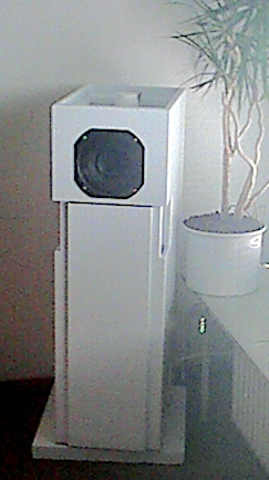

Big will be fine....all i'd like is to get the best possible cabinet for the drivers as there won't be any more cabinets for a LONG time after the next pair!....

I have managed to make it for over 3 years with my old original Dallas horns. Originally i had the 206e driver installed and later went with the 208 sigma with a ribbon tweet. Its been one of the few speakers that i actually put trim on and finished. With the batt P/S GC i have little desire to trade up or build a new system.
I believe ,sometimes, that instead of asking whats the best/newest/ boldest/most advanced, you should ask , what will work for my desires.
If i was going to replace my system , probably the A166 with FHL and a side firing mouth with the deflector placed horz. Either keep the GC or go with a more powerful SET than the SEX amp that i have.A better TT/cart than my old AR /grado blackwould help also.
ron
Or another thought, just keep the 208 sigma/tweet and design another cab (Austin principal), incorporate a FLH, time align the tweet and there ya go.

The horn act as a pressure/movement converter, this meen with proper sealing it act as a compression driver. Is it the case with a tl ?
not directly as loading in a TL is minimul. Its the combined loading of the CC and horn expansion that makes it closer to a compression driver system The TL action is a primary function, but the actions as a whole has to be calculated for. Its the blending (XO) between the TL/horn action thats important.. Thats why ,with loading, it takes a powerful/efficent motor to move the mass required. All you are doing ,with loading, is radically changing the Qms of the driver over a given LF range, this loading is a curve and not a slope, its all related to pressure/volume/mass and hydrodynamics. I have learned to lean towards a great deal of loading in FR BLH systems as without the loading the Xmax is exceeded and as there is , just about always, a different higher frequency signal being superimposed at the same time that distortion of the second higher frequency signal occurs due to the cone being in another later(further away from the field) phase point. I try to keep the loading to a point that the Xmax at the lowest frequency is = to the stated overall SPL of that driver. However i have never designed for corner loading as that is a room requirement.
