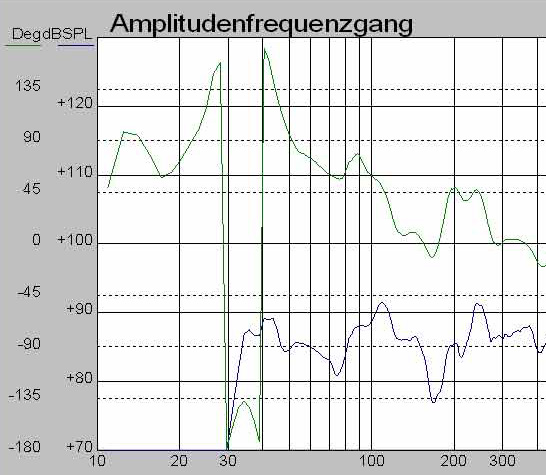

el´Ol,
"hm.
When it only makes 60Hz then it is not much better than your Lure. I simulated it according to Hobby Hifi`s measured TSPs of the Ciare HX201, should work, but only 80Hz. In my case the horn only has to compensate up to 200Hz, since the midrange rise is compensated by the off-axis use. Would you think it is possible to develop a horn that goes really low? And would this have a reasonable size?"
The LURE goes down to 45 Hz with the DDD, tell me your simulations the Cx201 must go down to 40 Hz. Email direct
Low in living rooms is 35 Hz,
do you look at the alphorn?, the smallest back loaded bass horn
the saxophon gets 35 Hz, look the measurements.
marekst,
do you have any not smooth measurements and what happens at 500 Hz,
if the horn works over 250 Hz it sounds coloured,
look my last post the Lowther measurement by AER,
below 800 Hz a Lowther needs help, but you can´t get it by
a bass horn!!

hm,marekst,do you have any not smooth measurements and what happens at 500 Hz, if the horn works over 250 Hz it sounds coulored, look my last post the Lowther measurement by AER, below 800 Hz a Lowther needs help, but you can't get it by a bass horn!!
I am not crazy about acoustical measurements. You misinterpreted them anyway - I remember your imaginary 38 Hz response from 3” driver…
The uneven response is a small disadvantage of BLH but it sounds better than it looks on graph and sounds better than I expected. Nothing bad happens at 500 Hz, there is a small rise at about 600 and up. The coloration doesn’t bother me.
I do not know why, but below 800 Hz things are going quite well all the way down to 50 Hz. Maybe my Lowther got help from less folded horn. Maybe because absorbing material in my listening room was deliberately chosen for increased effectiveness around 2 kHz? Actually, I build and tuned the whole room specifically to compliment the sound of the horns. Also I tuned the horn with wool stuffing.
Below 50 Hz response drops like a rock and there is practically nothing below 40 Hz, but I do not need a sub. I don’t here much above 12 kHz so I do not care that there is not much response there either. With all those problems I like the sound of my horns more than anything I ever heard. To somebody else they may sound colored, but when it comes to taste, there is not discussion.
