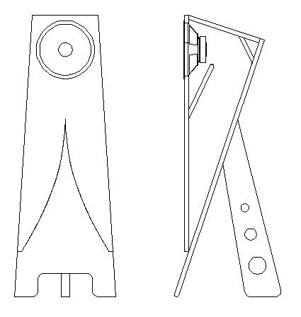

to me it looks great this way
if you have ideas how it would work even better please tell me so?
think you so much!
will you also give the right mesurements in the drawing?

sorry but i have an idea
could you pull the top and back a bit furter back so thre is more space fore the speaker
you can use the lowest point of the split as turnig point
fore example up to 37 cm depth total at the top????

wel then again it is good like it is sorry i realy think its perfect
but i have trouble exepting it so nice like it is thanx

Hi Foirixi
Yes, I really think the speaker has enough room this way;
after all, it's only the tip of the magnet, and it's only in the centre
of the cabinet. To the sides it has enough room...
extra board underneath the driver ?
I think it's better to stuff that triangle with damping material, like they do in
the tip of a voight pipe. It'll help to reduce the high tones from getting into the resonator.
maybe it's best to try and experiment with that.

hi Empee and Foirixi -- looks to me Foirixi's original sketch and speaker-build have the slot on the panel which makes a right angle relationship with the top. Whether that would matter other than appearance - I don't know. It looks nice the way Empee drawn.
Another thought - the vessel's overall airspace volume will have some influence on the low frequency cutoff.

very nice build---i say this especially , as it is indeed very similar to the speaker enclosures im building at the moment, and also it reassures me that my design will balance okay.

if you need a tweeter you can also put it on a wedge shape on top of the cabinet
than you can adjust it backwards for liniar phase (vertical axis)
?? can you isert in red in the drawing a diagonal back panel to make it fit for 8 inch
and make the distance to the back 12.5 cm

the idee of verying the q factor makes the soundbody`s suiteble for many difrent types of fullrange speakers!
i hope you agree!

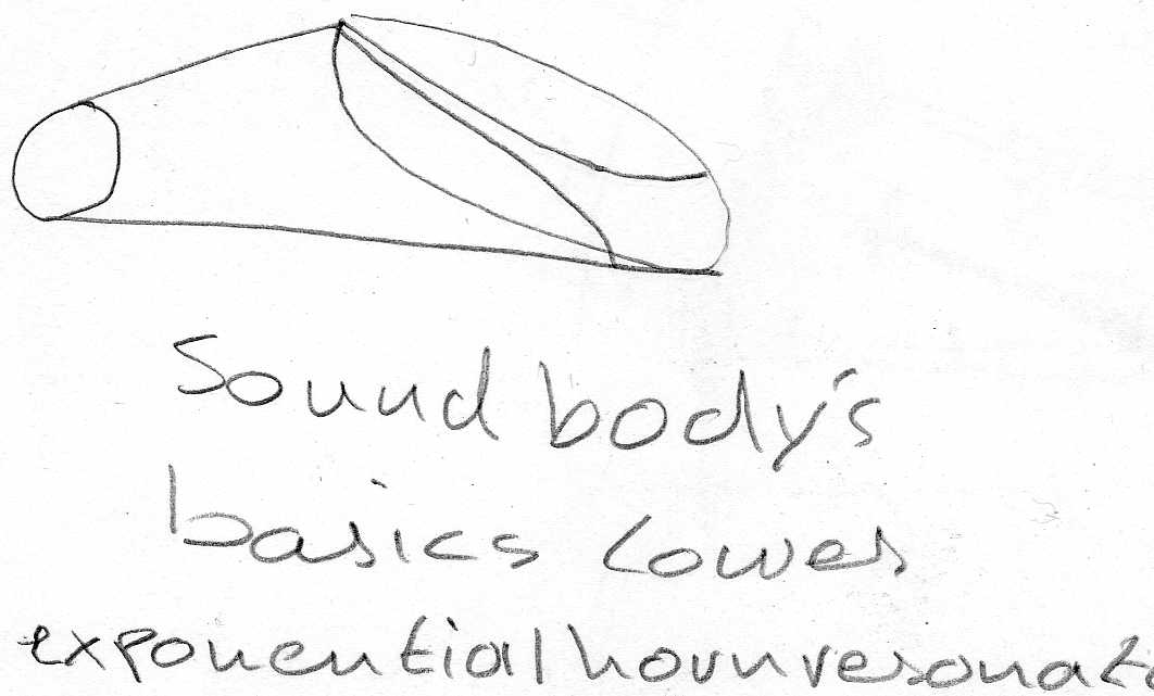

basics of the lowes soundbody`s
here is my tribute to john karlson
the exponential horn resonator
YouTube - John Karlson of Karlson loudspeaker fame speaks - 1964 radio
