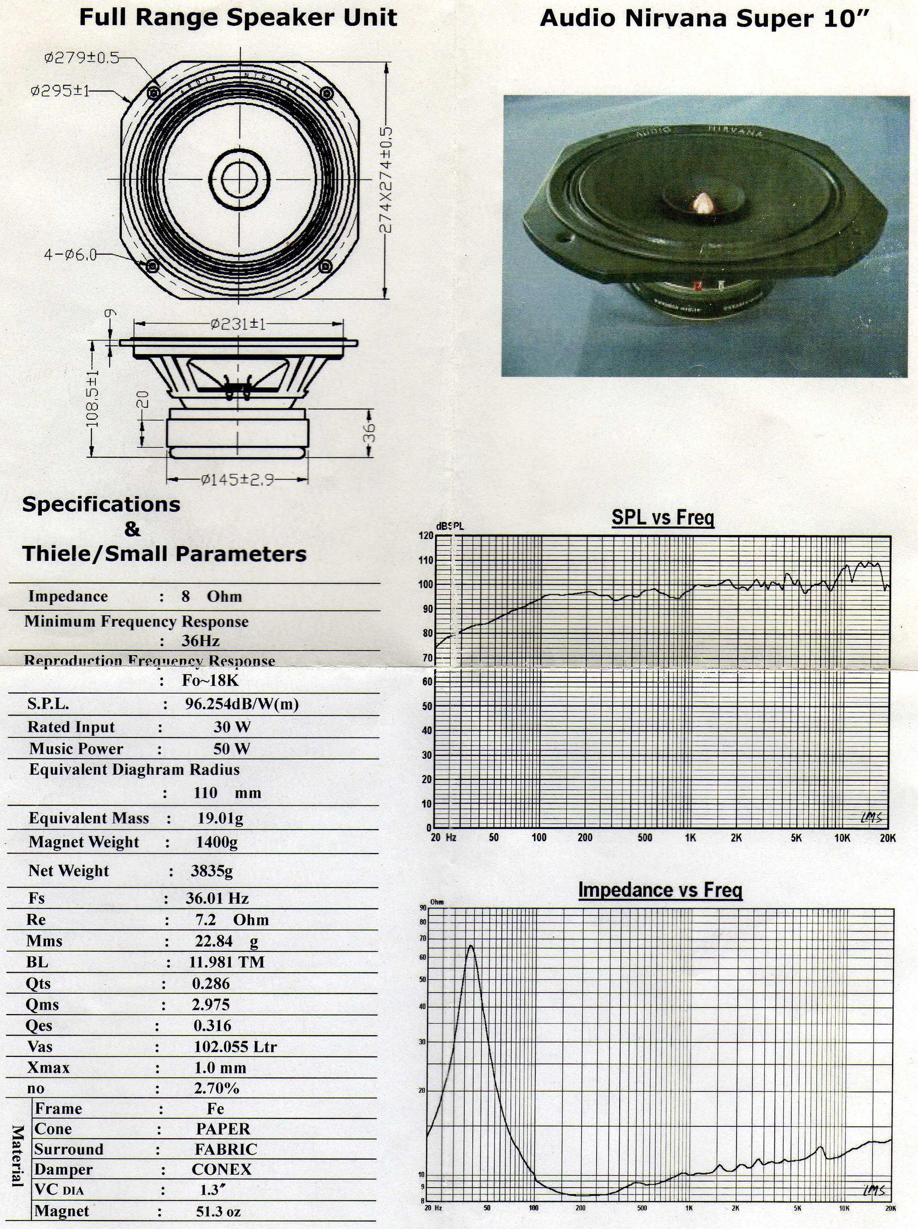

it was only intended for 8 inch
specially for the super alnico from audio nirvana
but 10 inch works aswel
de gap inside must be the netto surfes square cm
of the speaker
and the distance between the gap and the splitbeginning
must be 1/3 as the length of the split in 2/3 than you have
the most rendament and a clear sound

The RCA Fan cabinet created solid bass and seemed to like drivers with a lowish Q, around .2 or so. The best results I've had were with the Fostex 208E Sigma and not any Lowthers. The higher Q driver I tried was the Visaton 8", but the result was too much bass.
My question is what type of driver Q does your cabinet/horn do best with?

lowes sound body`s
with the audio nirvana 10 inch
the speakers have very nuetral bass

Hello, thanks for the response(s).
What type of driver is suitable for your cabinet? Are you looking for a particular Q, fs, sensitivity, etc.?
Or what is the frequency range that your cabinets amplify and by how much (in db)?
they amplify fullrange
and are loud
fostex 206e or audio nirvana
you are right about the q factor
it has to be low
only fullrange
thanx
and are loud
it has to be low
only fullrange
thanx
