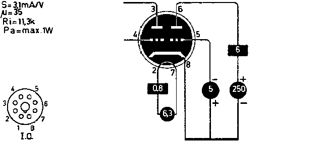

On another note: Once I was at my wits end as one channel had some slight hum whereas the other was dead quiet. In the end I discovered attached document from Philips regarding the ECC83 (12AX7): the triode on pin 6,7,8 has the lowest hum.

I'd suggest that any wiring or valve change you made to modify the pin allocation of the triodes may have achieved your hum improvement, rather than just the lower anode - heater capacitance afforded by one triode over the other due to wider novel spacing between pins 1 and 9 compared to pins 5 and 6.Once I was at my wits end as one channel had some slight hum whereas the other was dead quiet. In the end I discovered attached document from Philips regarding the ECC83 (12AX7): the triode on pin 6,7,8 has the lowest hum.

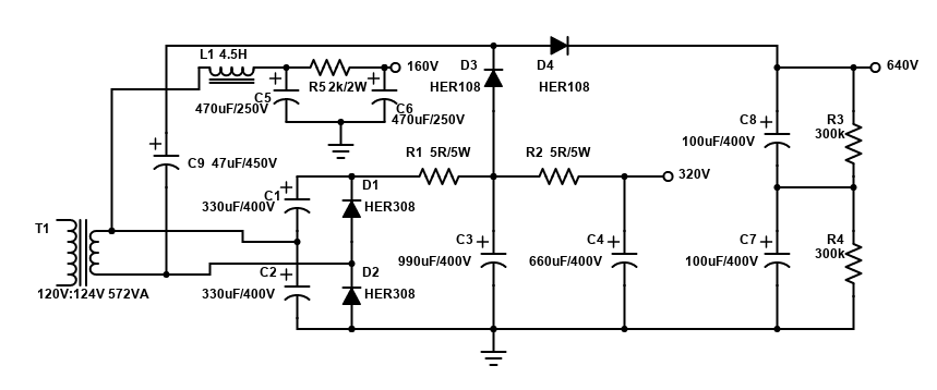

Neat idea. I use doubler and quad circuits to make ~300V for output, / 600V for the front end in my MA-1 designs from 120V transformers but I never thought of geting 150V from it as well since I build triode amps.
Now you have me wondering how it would work compared. It's not like I need more power though but 320V plate, 160V screen and ~2k2 load in push pull AB1 using my interleaved PT for OPT method might mean it'd be crap since the rp is so high compared to triode. Not like it would be hard to rig up though so hear it.
Maybe I should try it. I could just tap the mid point of the caps in the doubler for it.
EDIT: attached schematic

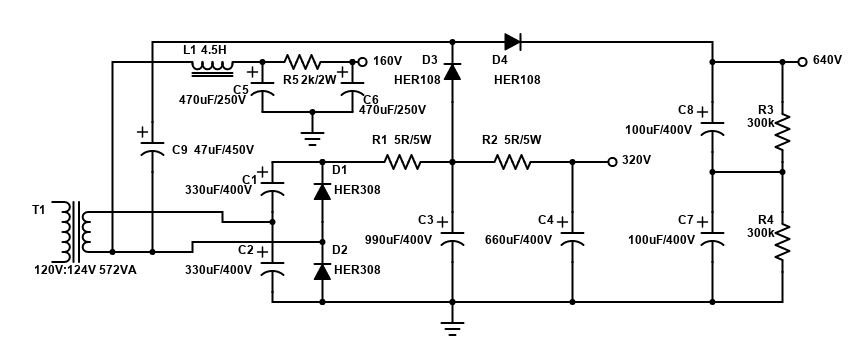

Maybe I should try it. I could just tap the mid point of the caps in the doublers for it.

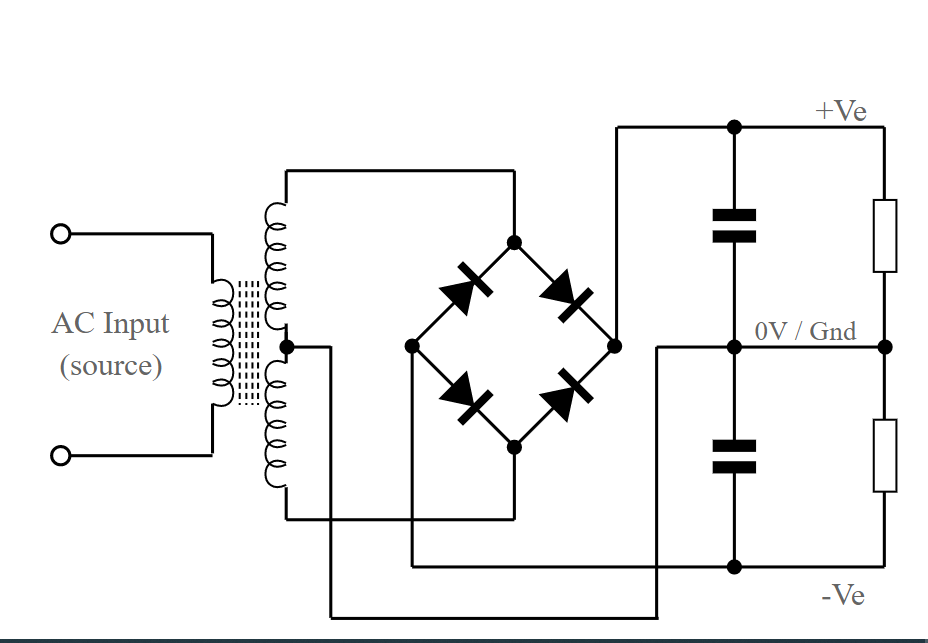

yes, you can even use a center tapped secondary winding, use a full wave bridge and use the center tap point with its own filtering for dc 1/2 of b+..
this is what i mean: if you make the - terminal at 0volts, then you can tap 1/2 B+, this is also possible for existing traffos on the market..
beware though, the schematic i got from the web had the fw rectifiers skewed 90 deg. clockwise.... 😀

I added a schematic to an earlier post, Tony. The 160V, 320V, 640V supply. What do you think of it? 34
EDIT: I think 34 won't work, but this will?
BTW 4.5 Henry choke is there because I have some and they cost me 5$. Probably it can be left out, and the second cap could be a zener network instead, too.
One of them will, damn it!
