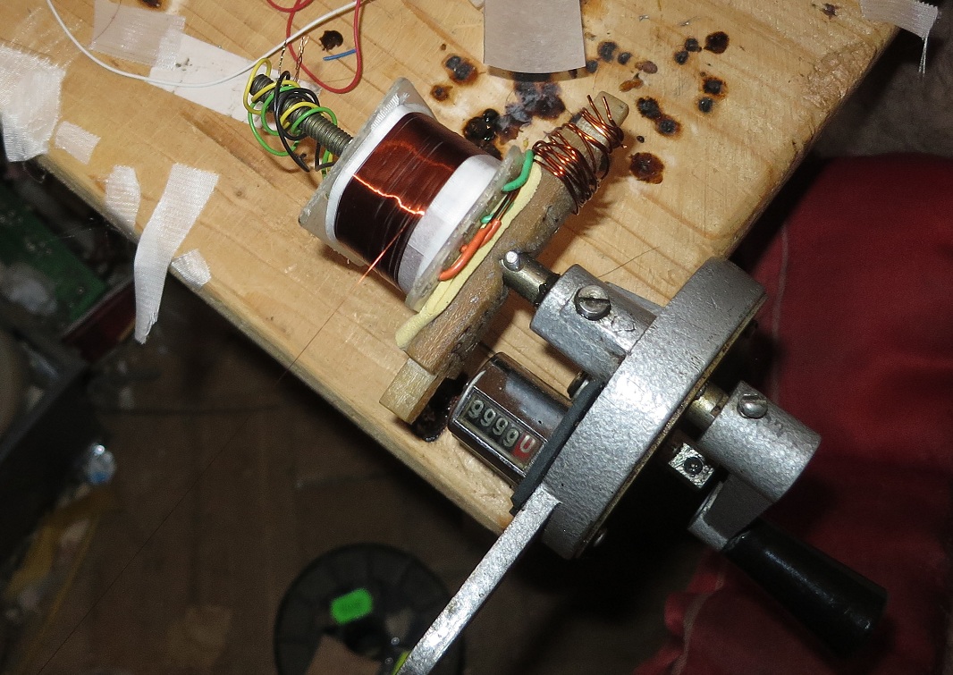

At the same time, they are very easy to build at a good quality as the windings have a minimal amount of turns compared to a tube amped transformer having like 3000 turns, a gap for anode current and thicker wire than necessary in a zero idle current setup. ...It's the usual setup for ribbon speakers and mikes too so he could source it as spare parts for a ribbon speaker or microphone(reversed) system. Xaudia Microphone Blog: Beyer ribbon microphone transformer
just take some of the secondary windings off...
