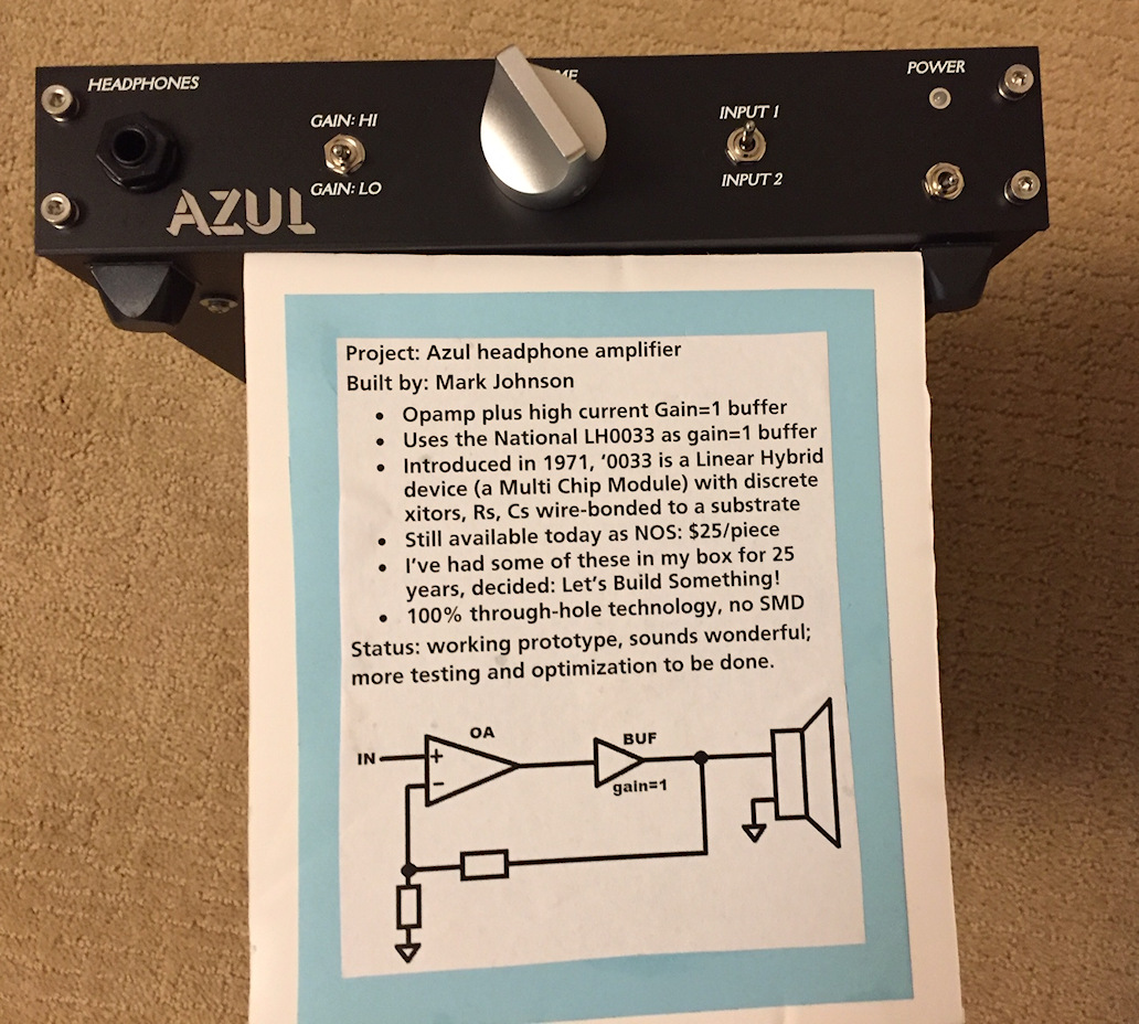

Get a different headphone amplifier which uses a "composite amplifier" design; namely an opamp and a high current booster, all within a single negative feedback loop.

Another thing you can do to the headphone amp is: replace it. Replace it with a different headphone amp whose internal guts includes a composite amplifier built with an opamp and a current booster.
