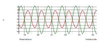

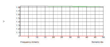

Here is the circuit I am running...it is very simple...but it works.
It is running at 60% volume which is loud enough to fill the house.
In simulation I can get almost full volume without clipping on 48V
140V puts me at +/- 8V without clipping.
The Dynakit ST-35 needs 1V to max it out at 17.8V output.

Here's the circuit- take two
Sorry about any image problems on my previous post...
Here is the circuit I am doing...it sounds good...
My tube Dynakit ST-35 maxes out at 17.8 watts with 1V input. It has 500K input impedance.
I am using BA A100's 90db sensitivity.
In this schematic I have the volume pot set at 60%...enough to fill the duplex to "turn it down!" levels.
Its running off of 24V in this schematic...48V runs clean to 95% for the volume setting.
