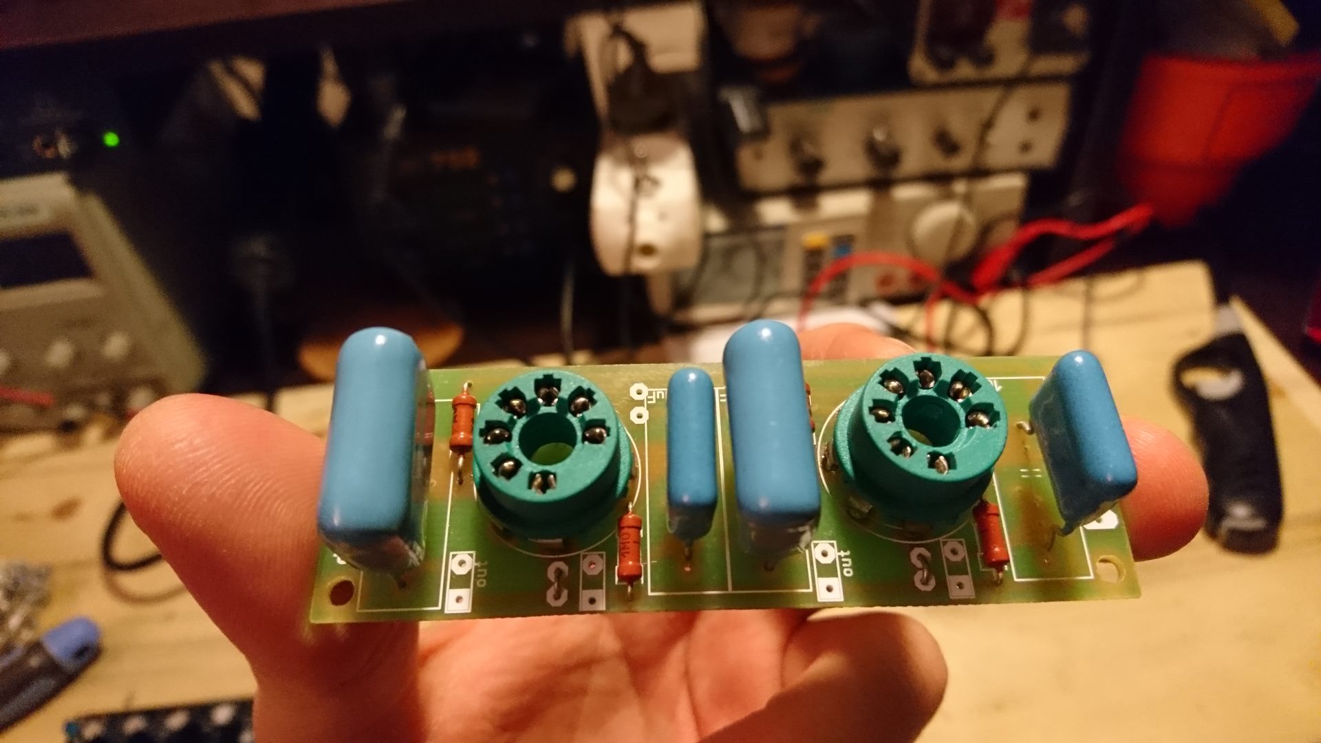

I got to build this one.
Been looking for a simple, dirt cheap and easy to build "tube effects" amplifier and this one seems to fit perfectly. 😉
I'm curious about the biasing though, is there actually any? The cathode is tied to ground and the gate is just -via the volume pot- connected to ground and the input.
bias is an interesting subject indeed. Is it biased because of the differences in potential resistively?
....I'll let you think about it for now...
Bias is zero volt. You can see plate curves on such love anode voltage and see the current and distortions on zero volt bias.
Zero bias valves tend to suck grid current which will slowly destroy any pot which is sitting on that grid. Zero bias should only really be used when the proceeding stage is able to supply ample current to drive the grid current. Otherwise a DC blocking cap is in order and the question is do you want a cap on the input of an amp ?

Guys, than you for your interest for this schematics.
Especially for Shoog.
About zero bias on the grid.
1) Certainly, zero bias is not a good in usual tube schematics. But there - because anode voltage is very low - grid current will be VERY low and will not damage the pot.
And - as right said Shoog - it makes possible not to use split capacitor.
2) Cathode was "grounded" without resistor to get a higher gain of circuit.

No problem, my plan is to breadboard it first, and if I like it I will hardwire it.
The schematic in the ebay listing shows an alternative LED bias, did you find that it sounded better without it or?
LED gave nothing in sound.... But it indicates current flow whet filament heated and flashes on peak 🙂
if it's needless, you can shunt it.
