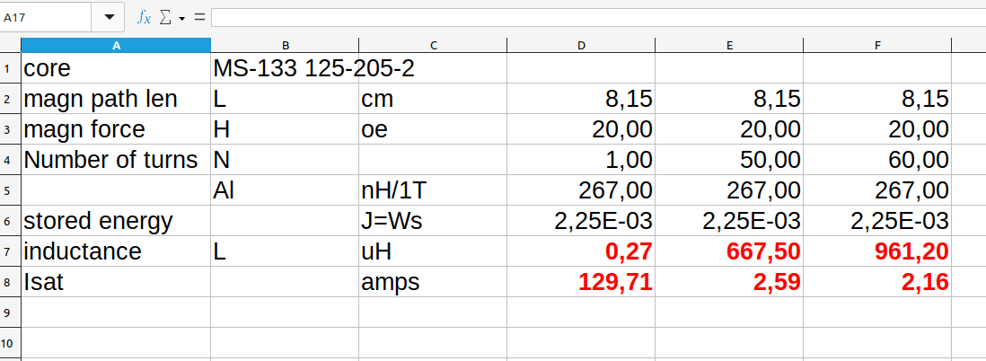

So I took the formula of your link into a spreadsheet and this is what I calculate for 1, 50 and 60 turns.
As expected, the stored energy is independent of number of turns and with <2.5mJ well within expected range.

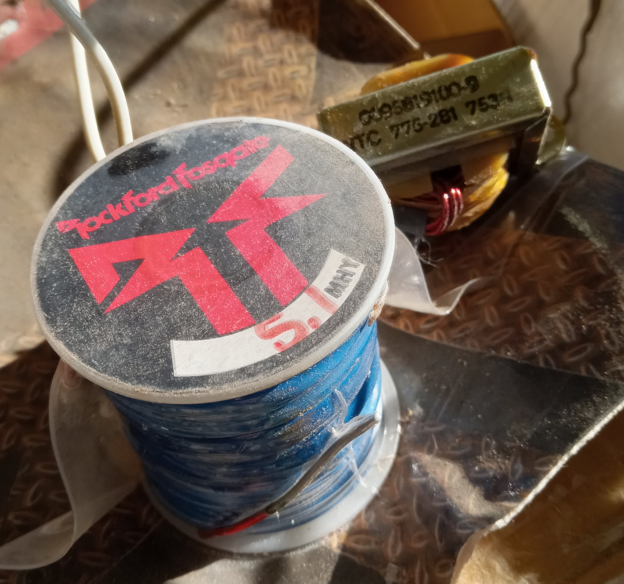

This is not a smoothing choke. The purpose of the first choke in a choke input filter is to provide uninterrupted sinusoidal current in power transformer secondary and improve output voltage regulation. For this purpose the first choke must have at least the minimum inductance value, aka critical inductance. For 2.5 V 4 A, the critical value is about 0.4 - 0.5 mH. The impedance of the first choke at specific frequencies doesn't matter (if we disregard frequency-dependent change of inductance). Filtering should be regarded in conjunction with downstream elements, capacitors and smoothing chokes.
I could do it in PSUD2, but it doesn't have a choice for a pair of 10 A Ge diodes with CT transformer secondary. It would be easier to assemble the circuit and measure. It won't show transients though. Diodes will definitely need voltage and current protection, which I will discuss in a separate post.
Other options for input choke are air core and standard gapped iron EI core. Here are Fosgate 5.1 mH air core choke and small 0.8 mH 6A EI choke. Air core is wound with 14 AWG wire and weighs half-pound, but inductance is independent of DC current.
