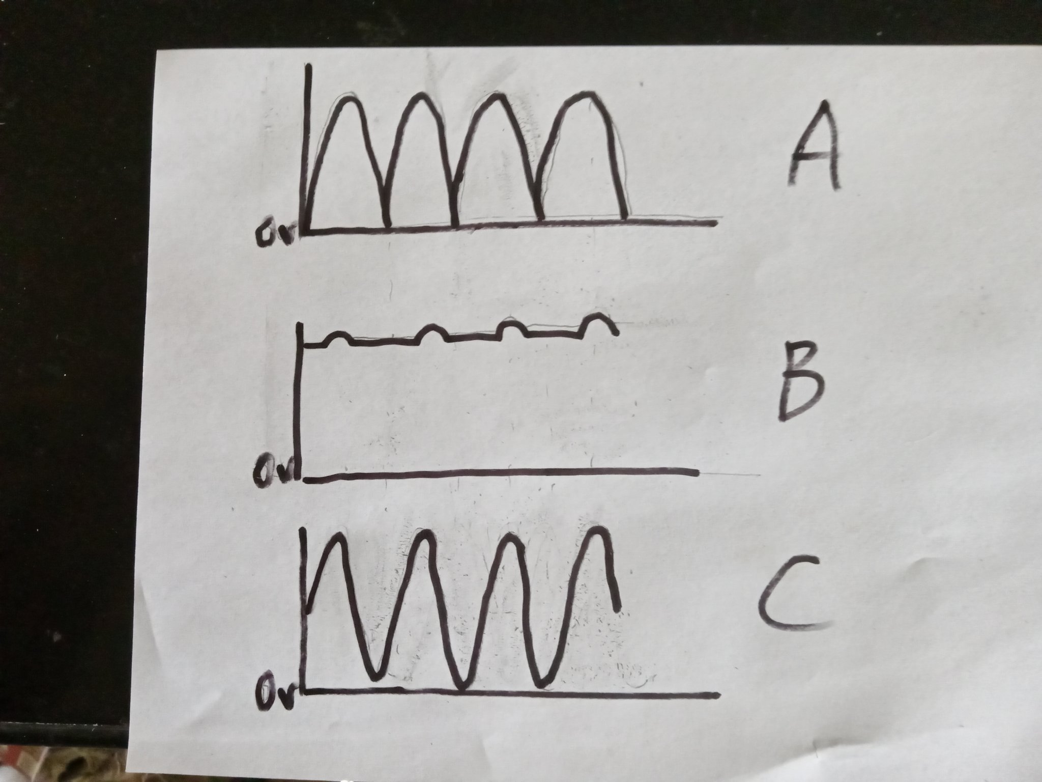

I guess you mean the bottom peaky part of a full-wave rectifier with no filter of any kind, like in A. But with capacitor input (B) or choke input (C) filters, there are no bottom spikes. Please note that voltage waveform at choke input (with choke of critical value) is a pure sinusoid - due to choke's reactance.Some noise is harder to filter than others. The 120 Hz “bizzzzzz” caused by P-N rectifiers working against trafo leakage reactance is among the hardest to eliminate. It’s and RF fundamental gated on and off at a 120Hz rate, making the nastiest kind of spectrum you can dream up.
No, what you can get is a high frequency BURST right at the zero crossing, riding on the rectified and filtered DC. Ground inductances at those frequencies mean “ground is not ground” and it can get into everything. Snubbers on the diodes themselves can often minimize or eliminate it, but not always because the proper snubbing is load dependent. Audio loads vary hugely. If you are running a separate filament transformer it can usually be eliminated from that supply because it can be tuned for that load. On a shared core it can come and go depending on load conditions.
Yes, we are talking about the same thing, but in different words. Zero crossing for a SS diode is crossing the forward voltage threshold. Abrupt current cutoff, as well as abrupt turn-on at the forward voltage excites transformer ringing. Tubes and high current Ge diodes don't have this problem because their zero crossing is smooth.

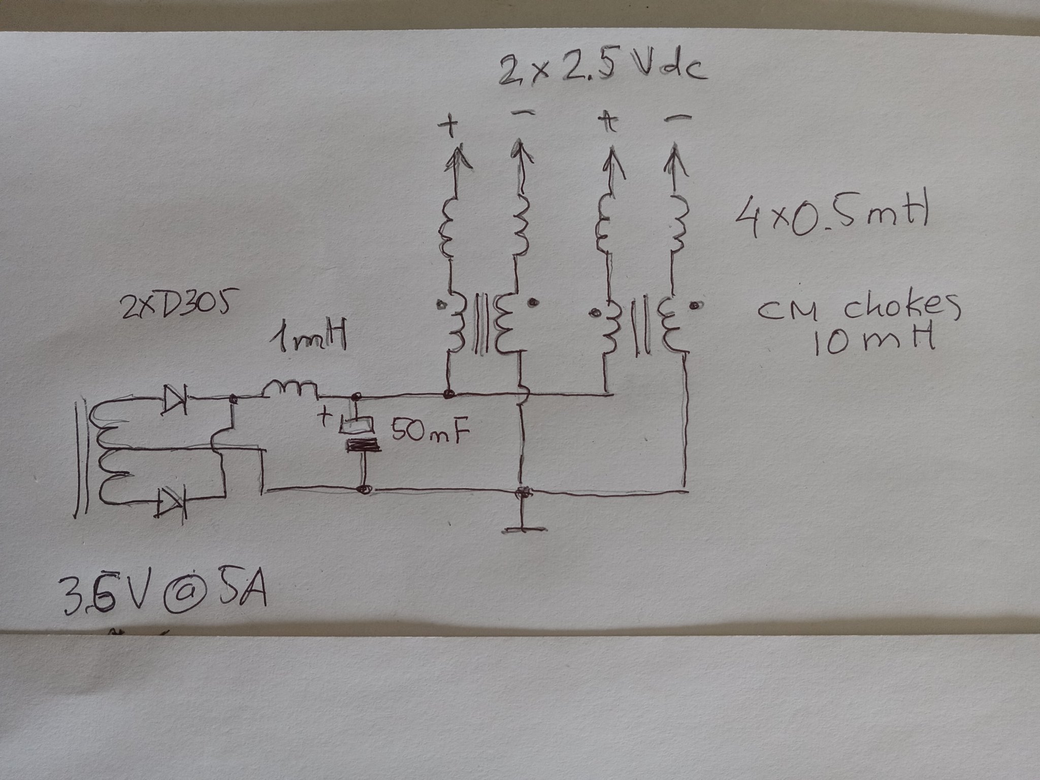

Here is a simple DC heater supply for a stereo 2A3 SET using D205 rectifiers. All inductors except CM chokes could be air core, same as used in speaker crossovers. Could be iron core as well to minimize stray fields, a few turns of thick wire on a small gapped core.
Transformer is 7.2 vct (3.6 x 2). I think better grounding would be at (-) outputs tied together.

This is worth reading. A simple snubber makes quite a difference. https://www.diyaudio.com/community/...rmer-snubber-using-quasimodo-test-jig.243100/
I am well familiar with this thread. As I said, an RC snubber dampens the ringing, but does not completely eliminate it. An analogy is that if you wrap a bell in felt and strike it, it will ring, but for much shorter time.

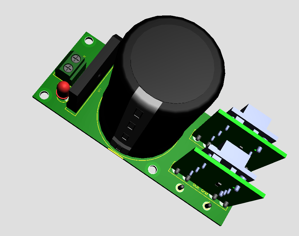

I decided to go with a Saligny active rectifier followed by two TDK i3AW step down buck converter modules for the GM-17 heater which needs about 7.5A at 6.3V nominal. One Saligny can feed two i3AW's for 2-channel. The i3AW output has a bit of hf ripple, I need to see how I need to handle that. If it is needed.

The Saligny means I have minimal losses in the rectifier, which would be appreciably with a total load current of 15A or so.
The use of the i3AW step down controller means I can use any transformer voltage (within reason) and still get exact 6.3V heater, with no change from mains variations. The output ripple is way above the audio band and there is zero chance of hum introduction in the cathode/heater circuit.
