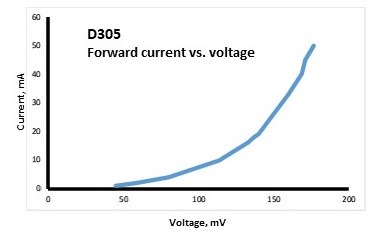

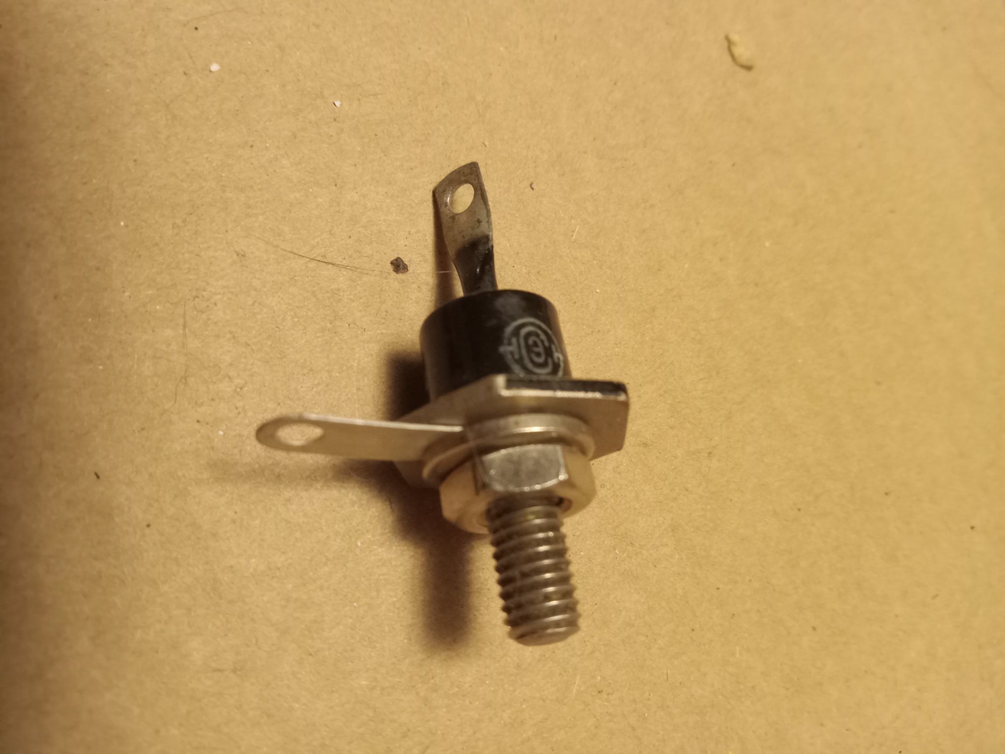

I believe I found the solution to this problem: germanium rectifiers. These have forward voltages of 0.3-0.35 V, but that's not their main advantage. Importantly, their behavior in the low voltage-low current area is similar to that of tube rectifiers. They don't have the hard forward voltage cutoff. Here is a low voltage static plot for the Russian D305 Ge rectifier that I experimentally derived. D305 is a 10 A 50 V diode.

It resembles an exponential curve with a current increase of about a decade per 80 mV (equivalent to an emission coefficient of about 1.33), but it's hard to see with the linear scales. What does the curve look like with a logarithmic vertical axis?
That would make sense if there were data for lower and higher decades, 0.1-1 mA and 100-1000 mA. The value of such data would be purely academic though as 350 mV is forward voltage and 2 mA is data sheet reverse current (which is basically leakage through equivalent parasitic parallel resistance).

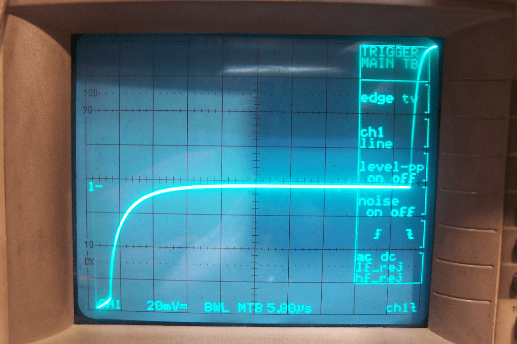

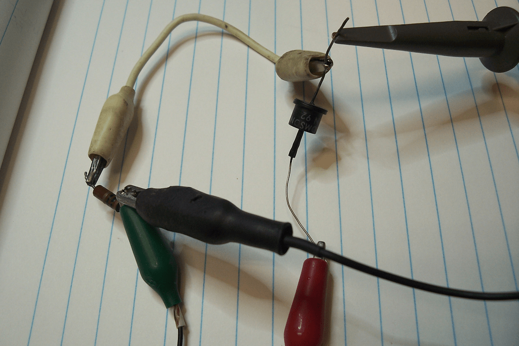

I have tested the reverse-recovery profile of a 1N92 Thomson (the Ge alter-ego of a 1N4003):
This is how it looks:
The p-p applied voltage is 10V, and with the 10ohm sensing resistor + the 50ohm of the generator, it results in a 80mA peak, both forward and reverse.
The trr is in the region of 3µs, and the recovery profile is relatively gentle and soft.
Nothing out of the ordinary, and you could find many standard silicon rectifiers behaving similarly... nothing to write home about...

Ge diodes are not all the same. Small signal diodes, such as Russian D2 or D9 series are fast and have cutoff characteristics similar to those of Si diodes, the only difference a knee at lower forward voltage. The 10 A D305 is very slow by all standards, and it has smooth transition. 1N92 is in the middle between them, that's what I saw with equivalent Russian D7 series diodes.
