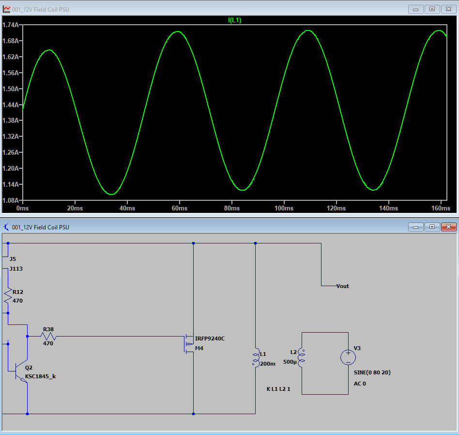

interesting, what is the voltage and current variation observed consider 12ohm Field coil resistance and you are applying 12V on the field coil.
If the back emf as per your above sim take extreme case of 20V on the speaker at 2KHz as I might like to play relatively louder.
What are the voltage and current sags observed on the field coil?

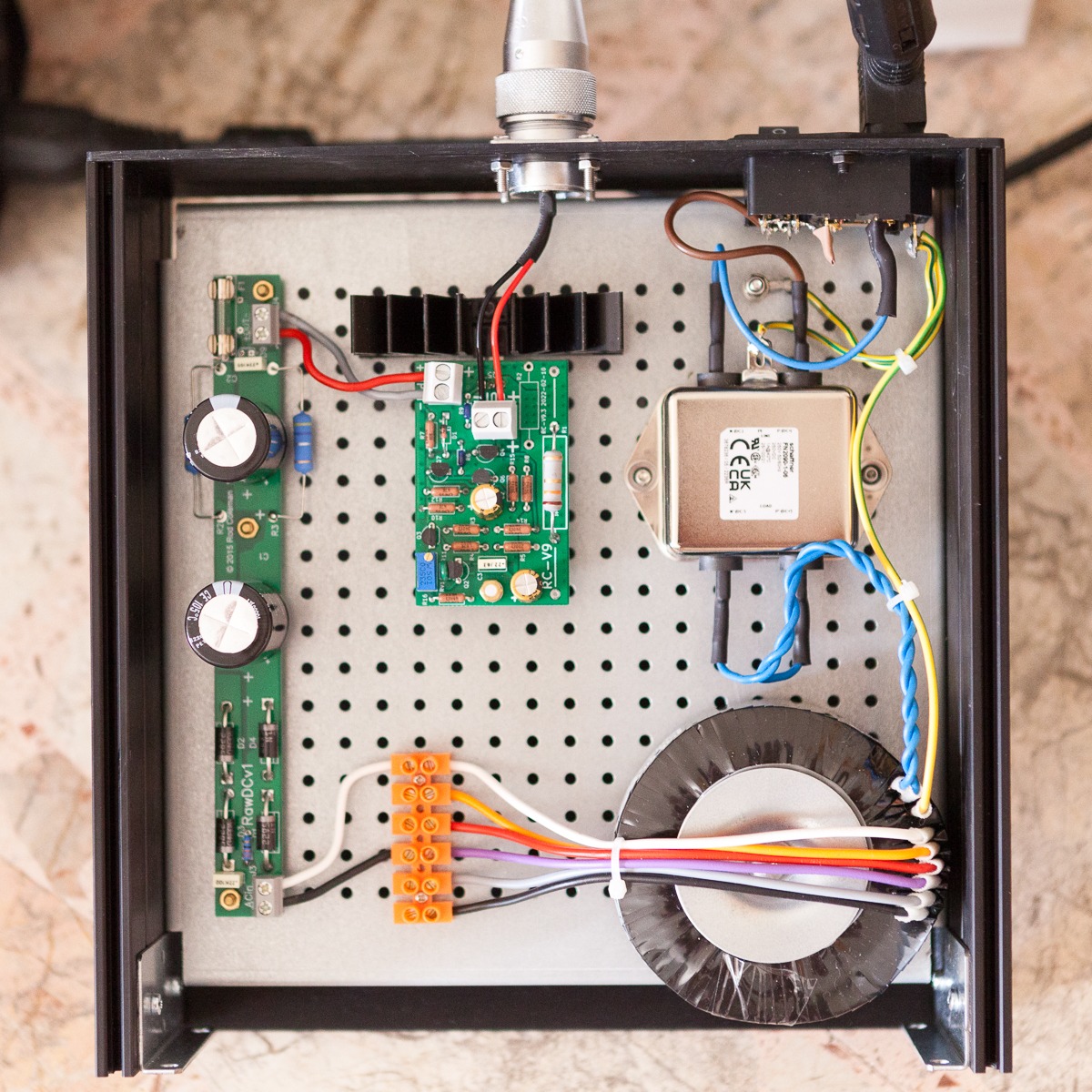

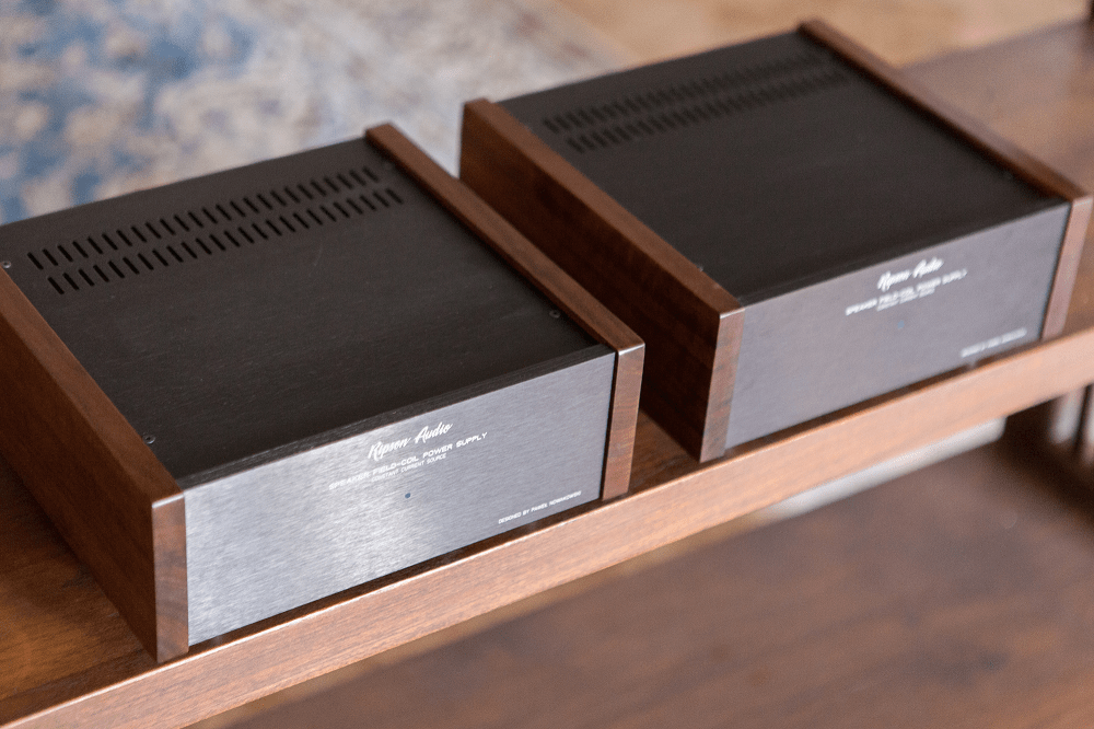

For the details, I recommend contacting @Rod Coleman . He is the best person to provide any specifics you might need.
Thanks @ripson ! - Yes, the Field Coil supply is a stable current-out regulator.For the details, I recommend contacting @Rod Coleman . He is the best person to provide any specifics you might need
Why use a pure current drive to a field coil?
- The B-Field (real magnetic field) is controlled by current - so stable current means stable magnetic field.
- As noted previously, the Coil ESR (coil resistance) comes from the copper of the coil, so it increases with temperature. With the high current in the coil, self-heating makes this is difficult to ignore. A voltage regulator can't tell what's going on, and so the current, and magnetic field droops as it warms up.
- Voice-coil back-EMF from the music-signal will impose some signal-voltage across the field-coil. This should be left undisturbed.
My field coil driver does not sense across the coil at all, and the current is stable, with or without music playing.
But a voltage regulator reacts to signal voltages the same way it does to DC voltage shifts... it thinks there's an error, and throws current at it, to cancel it out. This is undesirable in itself, but consider also that the voltage regulator is not high fidelity - it will add distortion and noise to the "error" current it sends in.
My regulator is a DIY kit that is a special version of the one used to heat the filaments of DHTs (300B triodes, etc). It's been used for > 14 years now by those on diyAudio and beyond, and has a record for high reliability. It's adjustable, so you can easily find the current for best sound.
The Field Coil is a special version, because a current regulator can't simply be loaded with an inductance - it will oscillate for sure.
So the field coil version is designed to frequency-compensate for the inductive load, and can now drive coils all the way up to 10H (or even more !)
Hi Rod coleman nice to see you on the thread. I have a question, now consider the output voltage is about 17V and as I have simulated a standard shunt regulator where I want to drive a 15 inch Field coil driver at full throttle but I see a current variation of about 0.6Amp but at higher frequencies the variation of current through field coil is about 0.5Amp when the CCS of the shunt is about close to 1.8Amp.
Now how much sag is observed in the above case with your regulator where 17V of the Field coil voltage with field coil resistance being 12ohm? at 80V on speaker with 5000Hz of speaker operating frequency
How much at 80V on the speaker with 20Hz as well. Wanted to understand how stiffer is your regulator?
Hi @rhythmsandy .but I see a current variation of about 0.6Amp but at higher frequencies the variation of current through field coil is about 0.5Amp
The current you're seeing in the field coil is a direct result of the shunt regulator action. In signal terms, this is a voltage regulator - so the circulating current is a consequence of feedback sensed at the coil terminals by the FET source.
If you replace this regulator with the RC-V9 Field Coil regulator, the regulator signal-current is near to zero.

I've had a CCS on my field coils for a while now. For one I did measure the signal in the voice coil coupling into the field coil and wanted to break the fc supply current loop by introducing a high impedance node. And as was mentioned a couple of times already B depends on I. The field coil does heat up so coil DCR goes up. With a fixed voltage this means I drops -> B drops. With the CCS B is stable and the speaker's sound doesn't change during warm up. It sounds (and measures...) the same right after turning it on and an hour or two later.
Rant: Positioning probably doesn't matter much in case of a field coil supply CCS but NOT putting a high impedance node like a CCS close to it's load gives me a headache.

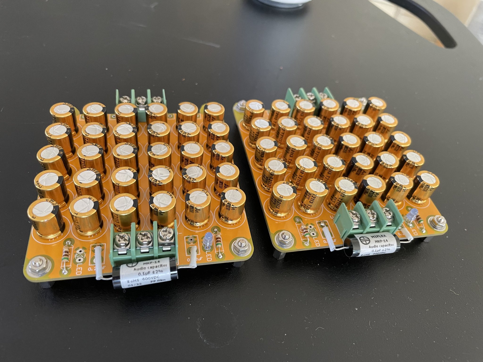

It is just a paralel field of 30 pcs 100uF capacitors with very low esr on each channel, with a 0,1uf bypass
It is intended to be like a small scale spot welding module, capable of delivering very fast small currents
No. A CCS is totally different. A CCS for a field coil supply is not as critical as in other positions and a 2540 cascode is good enough. The most expensive part will be the heat sink.
@bogdanrosca "capable of delivering very fast small currents" doesn't hurt, but for a field coil supply this is not needed. You need a supply that keeps the B field (which is depending on the current through the coil) constant.
For the 0.1uF bypass: I don't think it will do anything in that capacitor bank, but if it was to have an effect for HF decoupling you should try to mount it with leass lead length to not sabotage that. This is where SMD parts shine.
