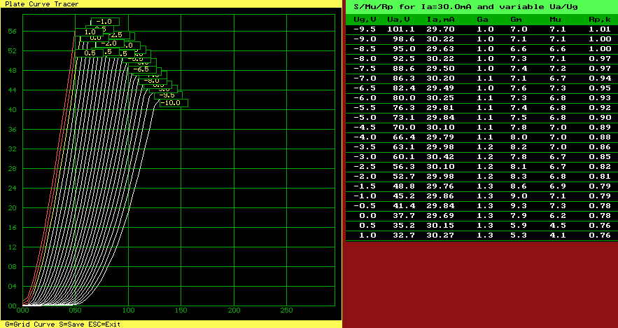

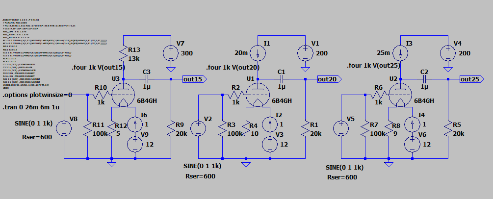

Would a 6B4G or 6C4C really be an overkill? With CCS and about the same Ua(90-125) and Ia (20-25mA) as the 12B4 it looks reasonably linear. But maybe they are microphonic as hell?Bigger DHTs like 2a3/6B4G/6C4C but that would be overkill.

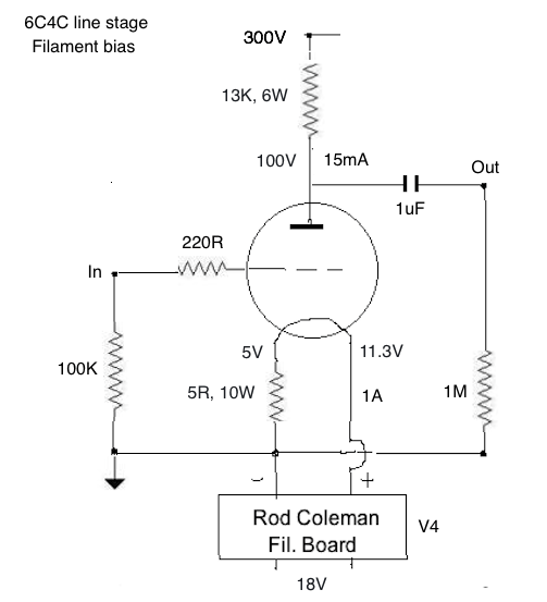

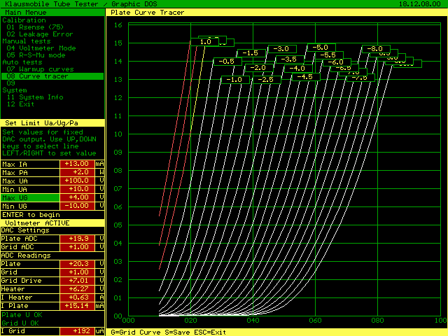

Great! Checked the curves, with loadline CCS and 20k load. At 120V and 25mA it looks quite nice. Rod´s filament bias(Rk ca 9 ohm?) must be perfect for this circuit.I made a 6C4C line stage in filament bias. Turned out pretty big but sounded excellent. No microphonics. Must make another.

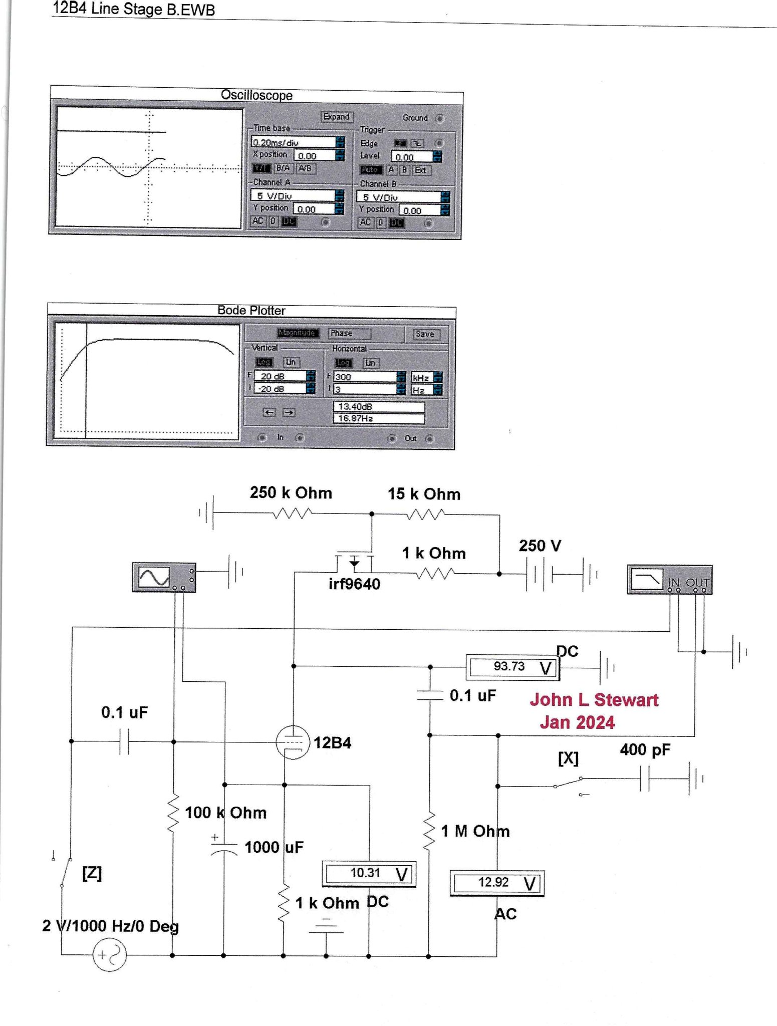

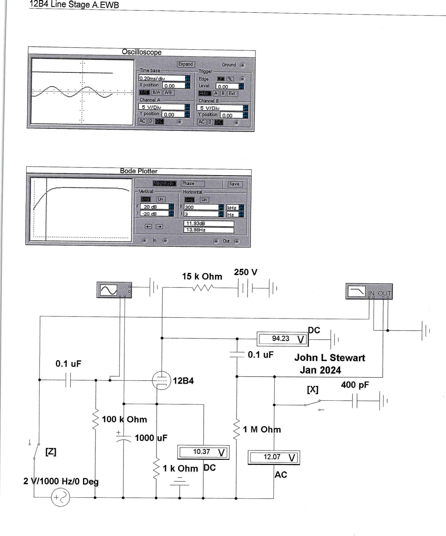

For all the 12B4 as a line driver fans, here Ya are! 🙂
The simulation assumes a 400 pF load in 20 Feet of COAX
with ~20 pF / foot of capacitance. Roll of for the resister
loading is ~300 KHz.👍
10R also good (about 90V, 25mA) ... but Rout not so low: 1k2Great! Checked the curves, with loadline CCS and 20k load. At 120V and 25mA it looks quite nice. Rod´s filament bias(Rk ca 9 ohm?) must be perfect for this circuit.
I could live with that🙂.but Rout not so low: 1k2

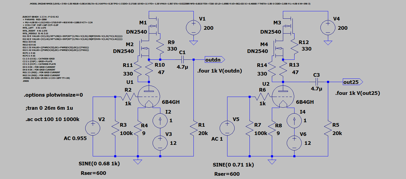

What's the output impedance using CCS for 12B4?
Or better how can calculate the output impedance for different cascode CCS for different tubes?

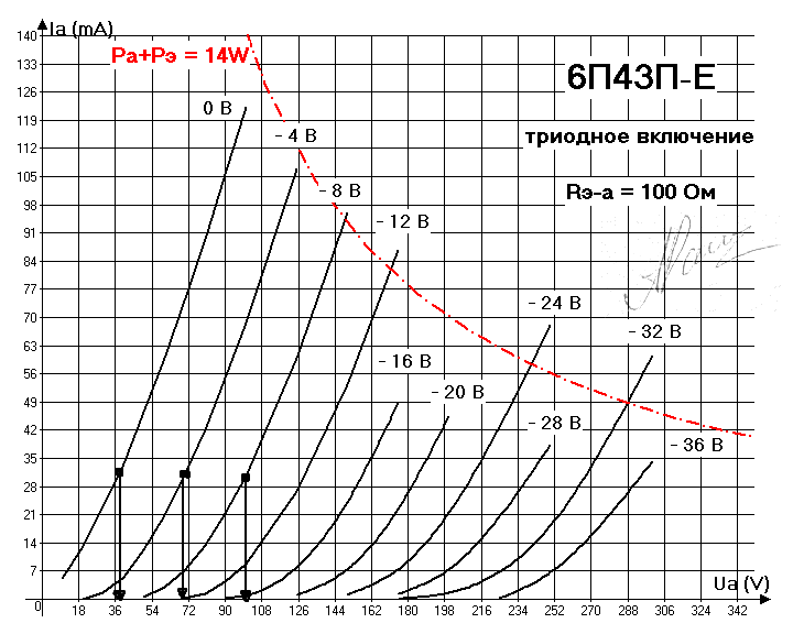

Why not the 6P43P-E in triode mode? mu of ~7, Rp of about 1000 ohms, it's got curves that trade blows with the best DHT, and is dirt cheap. They sound fantastic too- very linear, clear, and transparent. Rivals a 45 or 4P1L at lower plate resistance. Build the Salas 6V6 line stage with a pair and I bet you will be very happy. As soon as I get my shop back together I will finish the PCB design and be actually finishing up a pre using a pair for myself.
