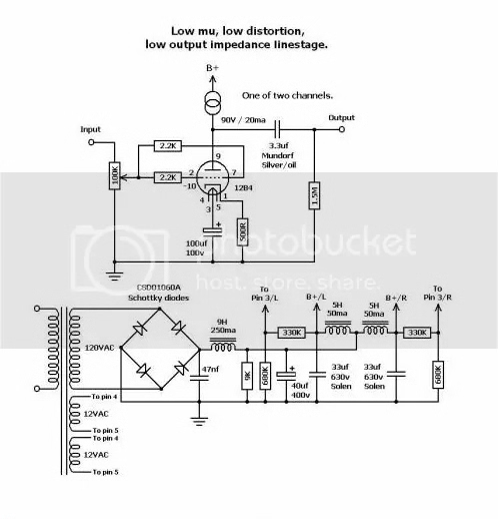

I built a 12b4a preamp, tried multiple iterations and landed on my current version using Ale's gyrator and I have no desire to build anything else.Very pleased with my 12B4 PP preamp. Combined with its output transformer, the total gain is less than 1, and output impedance somewhere in the 50 ohm range. Pick a different ratio of the transformer and you can get half or double the output voltage depending on your amp needs. Distortion of 0.005% of almost exclusively 2nd and 3rd harmonic. Too many negative posts over the years about the little tube that could. Want more gain, go 12A4.

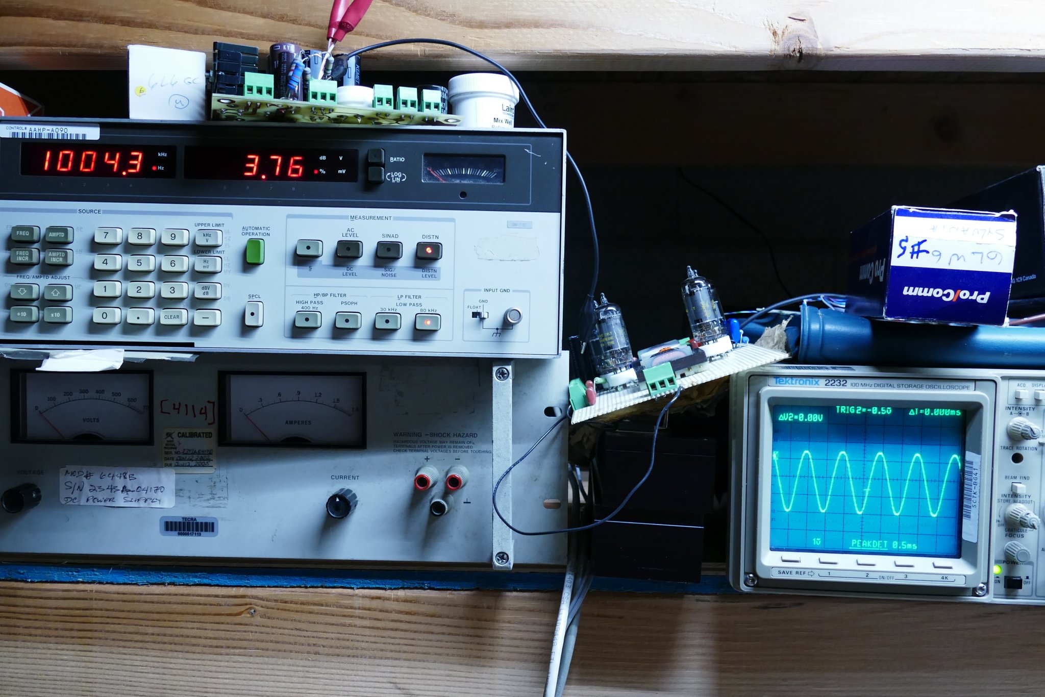

I made a little test circuit on perf board with a pair of fifty see fives. It was going to be a small guitar amp, but it never got finished. Now that I am looking to make myself a new guitar amp, I got the old breadboard out of its nearly 3 year long sleep and fired it up. It still works and still makes 20 watts, but it hasn't seen much use. I remember going through a bunch of tubes to find two that worked, but all were old used tubes. The pair that's in the board are not even the same kind. One has a black plate and the other has a grey plate. I didn't remember that the 12AU6 driver is UNSET wired as well. Back when I built it, I let it run for about 16 hours straight with no observable issues and changes in operating conditions over the extended "burn in test." The UNSET configuration gets triode curves from a pentode. It also frees up the screen grid to be fed from a different supply so that TV sweep tubes can be run at high power levels in "triode" mode. Most Sweep tubes need 150 to 180 volts on G2. The secret to getting high power on any of the 6W6 variants is to run the screen grid at 125 to 150 volts MAX! Let the plate voltage go wherever you want as long as you keep the plate dissipation somewhere close to the spec. I ran the fifty see fives with 165 volts on the screen, 330 volts on the plates and about 35 volts on the cathode into a 6600 ohm load to get 20 watts at 3.76 THD.

The 12b4, does look very appealing - plenty still about and specs are just what's needed.I built a 12b4a preamp, tried multiple iterations and landed on my current version using Ale's gyrator and I have no desire to build anything else.

Thanks for the schematic and heads up for the 12b4
https://www.diyaudio.com/community/threads/12b4-preamp.137771/
For anyone contemplating a 12b4 build this is a must read. Consensus seems to be -20V bias and 15mA. Big point is grid stoppers on both grids need to be at least 3.3K or even 4.7K in some cases. Active load seems to be preferred to a resistor.
I tried several bias, best bias is Elit Dutman schematic, but the best it's diy and get the best SQ you want. Good lucky.https://www.diyaudio.com/community/threads/12b4-preamp.137771/
The requirement seems odd for such a low tube.grid stoppers on both grids need to be at least 3.3K or even 4.7K

Indeed, but those who experimented and measured their setups (Salas etc) were most insistent on this, otherwise the tube oscillates.

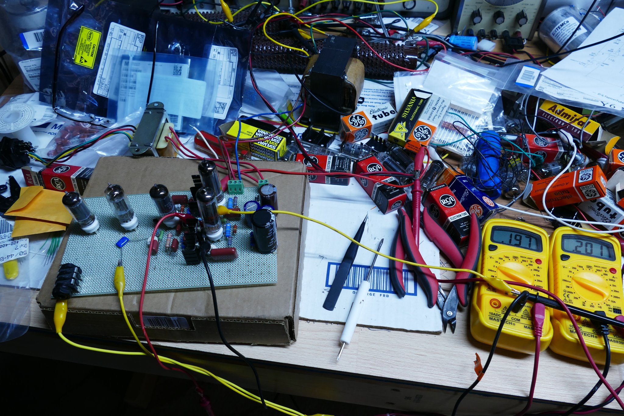

The DH tube that stood out during the breadboard phase for that build was the Russian 2P29L. As I recall, the Rp of the 2P29L is similar to the 1626 so the resulting output impedance should also be similar. I posted a thread here about the 2P29L.

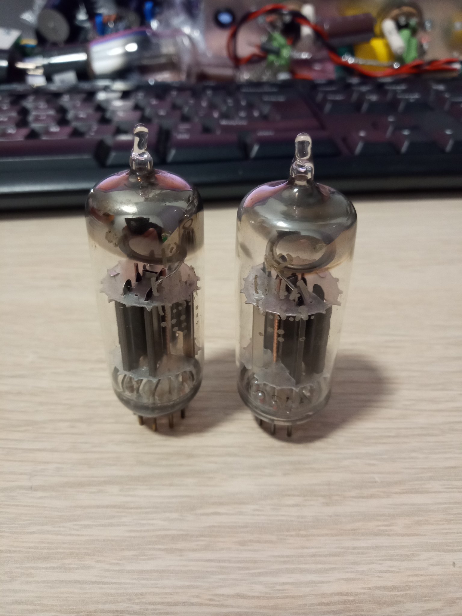

Several years ago I built 12B4a preamp for my friend.
As @FlaCharlie wrote, it was microphonic like hell (I have several Sylvania, but all of them ringing), so took it apart and rebuild it with 801. Gyrator loading resulted fairly low output impedance.
Tried several 12B4 brands and no one microphonic but can be lucky, Just received a GE matched pair black plates. Bela what schematicc & brand did you used?
Sylvania, CCS loaded.
The tube sockets isolated from chassis.
The tone was good, but even on air spring rack was practically unusable.
My buddy likes high volume, so acoustic feedback was a disqualifying factor.
Mine 12B4A aren't isolated, are mounted in PCB and the PCB not isolated from chassis....I use R-Core + SSHV2 + CCS
