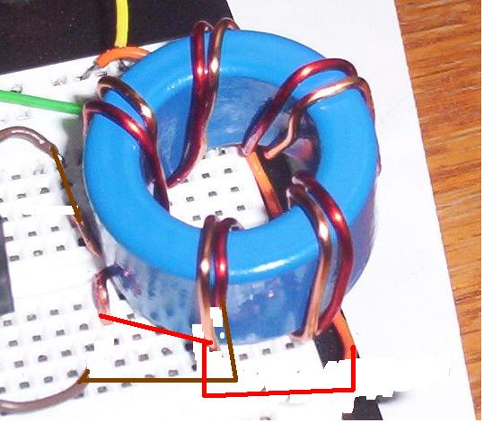

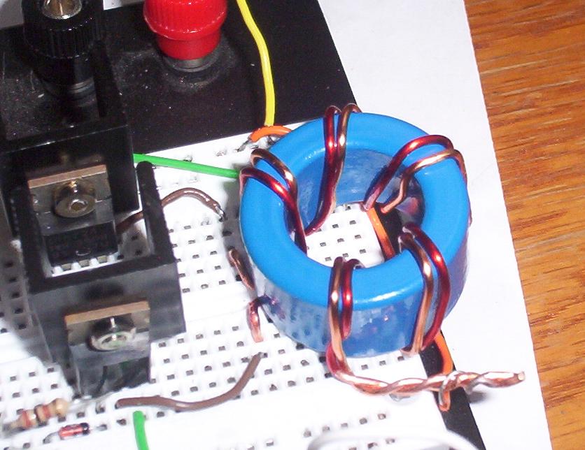

djQUAN, I just made a test circuit and transformer the way it is in ThSpeakerDude88 picture and the mosfets heat up badly and the waveform looks like it got ran over a few dozen times.![]()
The setup
The waveform (See how there in phase, there not suposed to be)
And when I used a different core (with the other winding way that Me and Perry are talking about I get this)
Pic of the setup
And for the waveform: (these ones are out of phase)
P.S the scope is set to the same setting for both test but some reason test #1 dropped in freq.
I was talking about the picture you posted which is the one that should work.
I said I had to disagree because I thought that perry was saying your winding technique won't work. it was ThSpeakerDude88's winding that he was talking about.
yes I figured It had to be the transformer after last nights testing. What I did was since I already had the primary/secondaries wound, I tried it first with both fets ( heat sinked) and the transformer had a high frequency buzz emmiting from it. This lead me to believe " Well the FETS have to be working in phase with each other instead of push pull, that wont work!" I tried running it single ended and the FETS still heated up a bit, but I got 40vdc on the output of one half of the secondary. The wierd thing is that no matter which fet or which driver pin from the chip I used, the other half only read 8vdc. When I attached the smoothing capacitors to the circuit, weird things happened. I got 60vdc on the + leg and 30vdc on the negative leg.
something is wrong with my transformer. I have plenty of magnet wire to work with and with the small number of turns needed its not a big deal to rewind. I will try the one in your pic, how many primary winds would you sugguest? BTW I changed the frequency to 40khz and ran pin 1 to ground to get the fets to stop heating up. ( as bad, they still heat up a bit on the heat sinks)

I think 4-0-4 is a good place to start, just remember to wrap each primary all the way around the core and make sure there not in phase and you should be set.
I have 4-0-4 wound right now to look like ifrythings setup. Xfrmr is still ringing and the FETs are still getting hot. Whats going on here?😕
well what do you know... no ringing no heat at all. Should I go ahead and add the secondary? how many windings do I need for +/- 20v? ( need 22.5vdc rectified)
btw current draw is now 100ma.
To build a +/-20V supply, the turns ratio is 20/13.8=1.5 approx, so wind 1.5 x 4 = 6 turns for each secondary (6-0-6)

alright. I had assumed since 8 was too high that somewhere between 4 and 8 would be correct. I will take a picture of my trafo when finished. About winding the secondarys... Do I have to wind them the same way I wound the primaries, out of phase?
I have it working finally! I have the transformer underwound right now because I think I have about 6 turns on the primary, and 8 on the seconday. I am powering a TDA2050 with it right now and its working great! I reverted back to the original schematic I had with the 30khz frequency. The fets are on sinks but their not getting even warm. My power transformer is getting mildly warm, and I think that might be due to the fact that I have only 22g wire on the secondarys. I will rewind the xfrmr tonight with bigger wire. Its surprisingly noise free as well 😀
