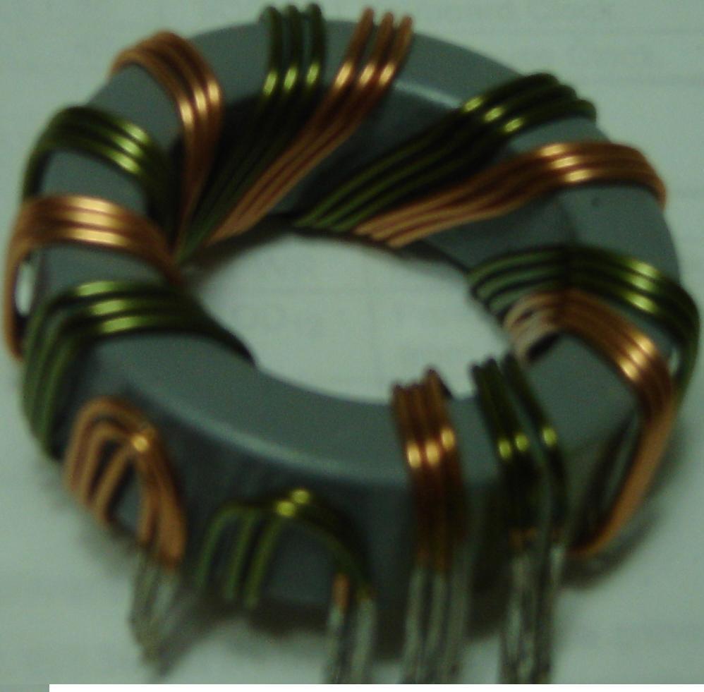

Do you have your primary windings laid down approximately like those on the transformer shown in the attached photo?
You can try changing the dead time on the 494 but if the FETs are heating up, there is likely another problem. The drive circuit you are using works well with no additional deadtime (2-3% deadtime is built into the IC).
sort of..I have 4 winds and then a center tap, and then another 4 winds. The primary leads that are driven by the FETS end up next to each other back at the starting point, while the CT is on the opposite side. Same goes for the secondary.

That seems to have the primary windings in phase instead of out of phase. I don't think that will work.
Wind a set of primaries onto the other core you have using a layout like the one in the photo I posted. Don't wind a secondary.
Perry Babin said:That seems to have the primary windings in phase instead of out of phase. I don't think that will work.
Good observation ther Perry Babin, I missed that. Being in phase will cause the core to saturate in a cycle or two, it will have to be re-wound.

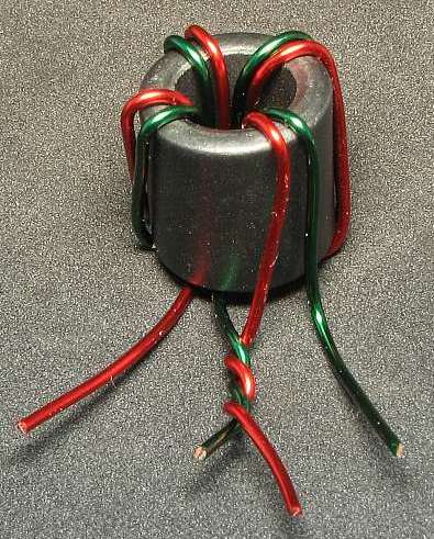

I may have to disagree.
if you notice, there are four terminals on the resulting transformer primary, if you have observed, the two near the middle are joined together and acts as the center tap. the two at the sides are connected to the fets.
if you follow the wire colors and turn direction closely, they are opposite and not in phase. I wind my transformers exactly the same way (and so does most car amp manufacturers) and they all work. 🙂
an advatage here is that they are almost bifilar wound and that is a good thing. 😉
