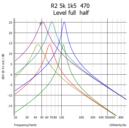

This circuit allows the variation of resonance without changing the gain.
The 1k5 canbe replaced by a 5k pot with 470R in series.
With C1.2 =200n (150n in parallel) you get these curves
the level pot also has some impact on the resonance, you will have realized that. I depicted the most (50%) and least (100%) cases
no need to change the output caps
