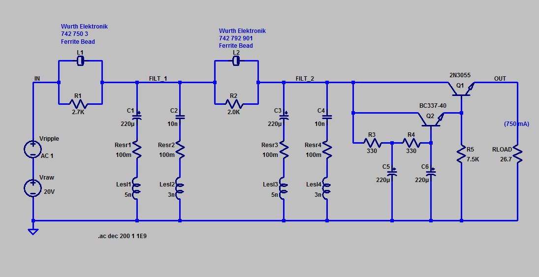

If you insist on connecting a DC/DC switchmode power converter to a microphone preamp, I recommend installing a LOT of RF filtering between the switcher and the downstream circuitry. If you have LTSPICE you can use the giant array of presupplied inductor models* from Wurth and others, to simulate your filters and quantify the amount of attenuation you'll get between 20kHz and 10 MHz. I suggest you aim for at least 100dB. Then, when you've got an RF-clean raw supply you can apply it to a modern, low-noise-in-the-audio-band, voltage regulator IC. The regulator output supplies power to the LME49990.
A low cost way to get even more RF attenuation, pretty darn good RF attenuation, is to build a capacitance multiplier stage out of a low-fT darlington. Make the RC lowpass cutoff frequency at the base node, equal to 2 Hertz. R is set by required-base-current at min-Beta, while C is set by (R*C > 80 milliseconds). Toss in a couple protection diodes to give well behaved startup and shutdown, done. The BDW42/47 complementary pair looks like a wonderful choice. (datasheet). One dollar american money @ qty=1 @ digikey.

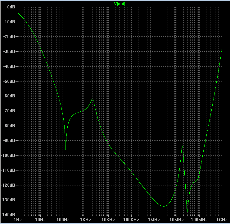

Here's a back-of-the-envelope sketch of the idea, slung together between my first and second cups of coffee this morning. Although it illustrates the basic concept, I'm sure there have got to be at least a half dozen places inside where it can be improved, optimized, polished, and superceded. But even this modest little caffeine-hallucination, mows down quite a bit of SMPS high frequency noise.
This circuit is upstream of the analog linear regulator. SMPS ---> this idea ---> analog voltage regulator.

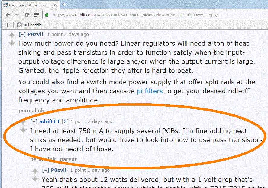

In his other thread on the other website he discloses that several boards are connected to this supply and the total current is more than 750 milliamps. That might require large batteries, frequent recharges, or both.

They don't have to be connected. They feed into a NI with 24-bit ADC/DACs. The ADC/DACs can be set to differential mode, so all the devices can float relative to earth ground. So, I could buy a bank of batteries (one for each device).
The devices are:
* Dual speaker drivers (to a headphone speaker). Requires up to 250 mA per speaker.
* Single microphone amplifier. Probably does not require more than 50 mA.
* The extra current was overhead just in case I need additional circuits to be integrated later.
