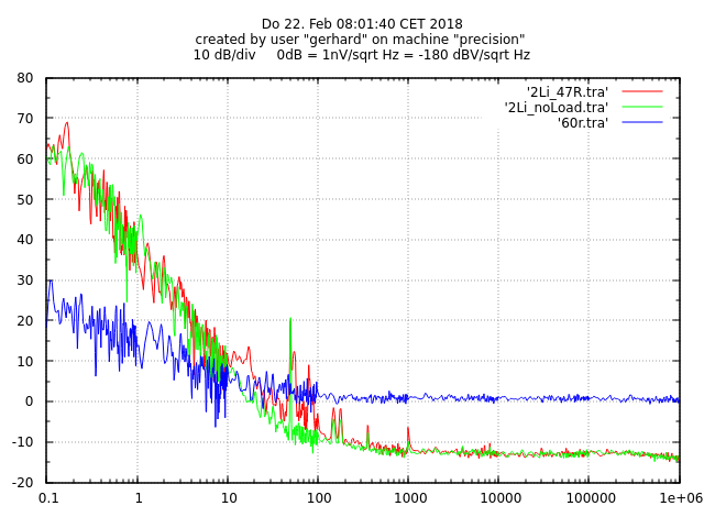

2 Panasonic 18650 Lithium batteries in series, abt. 7V, in the state as bought last week,
they might not be completely full.
Noise behavior of the batteries is excellent. The blue line is the measured noise of
a 60 Ohm resistor. That is 1nV of thermal noise at room temperature.
The 60 Ohm resistor is on the amplifier side of the coupling capacitor.
There is one trace without load and one trace with a 47 Ohms ceramic load resistor.
It got a little bit to hot for my fingers. :-(
The input capacitor is only 100uF foil. The batteries are on the far end of the
coupling capacitor, as seen from the amplifier. That leads to the steep rise
of the noise at low frequencies since the noise of the bias circuit (10K)
cannot be shorted through the capacitor & low impedance DUT.
This is an artefact of the amplifier. It could be healed by using a bigger cap.
I tried organic polymer electrolytics, but they had to much leakage current,
they messed up the bias system. There is a lot of gain involved.
I have some wet slug tantals, but they do not fit mechanically.
There are no facts, only interpretations. (F. Nietzsche)

The interpretations?
All fat batteries seem to be quite good, the NiCd, NiMH in my test report and also
the Li Ion measured this morning. Led acid has to wait until it is warm enough
outside so I can work on my motorcycle.
The effort to measure that is quite high. My personal interest is measurement amplifiers
and there it is a definite plus when they are an order of magnitude better than the
devices under test. Batteries make life easier here, alone for the elimination of ground loops.
I need multi level metallic shielding, and even then a ground loop in the innermost box
is easily seen in the spectrum.
There is no need for this performance level in audio. The perceived need could
"at best" be justified by incompetent amplifier design. DIY and "Hi End" designers
seem to flock to circuits that have no power supply rejection, for simplicity, ignorance,
tunnel vision or fashion. For me that's wrong from the start, more a symptom than a feature.
The LT3042 is 40 dB better than the rest of the crowd like LM317. If that is
not sufficient, something else must be wrong.

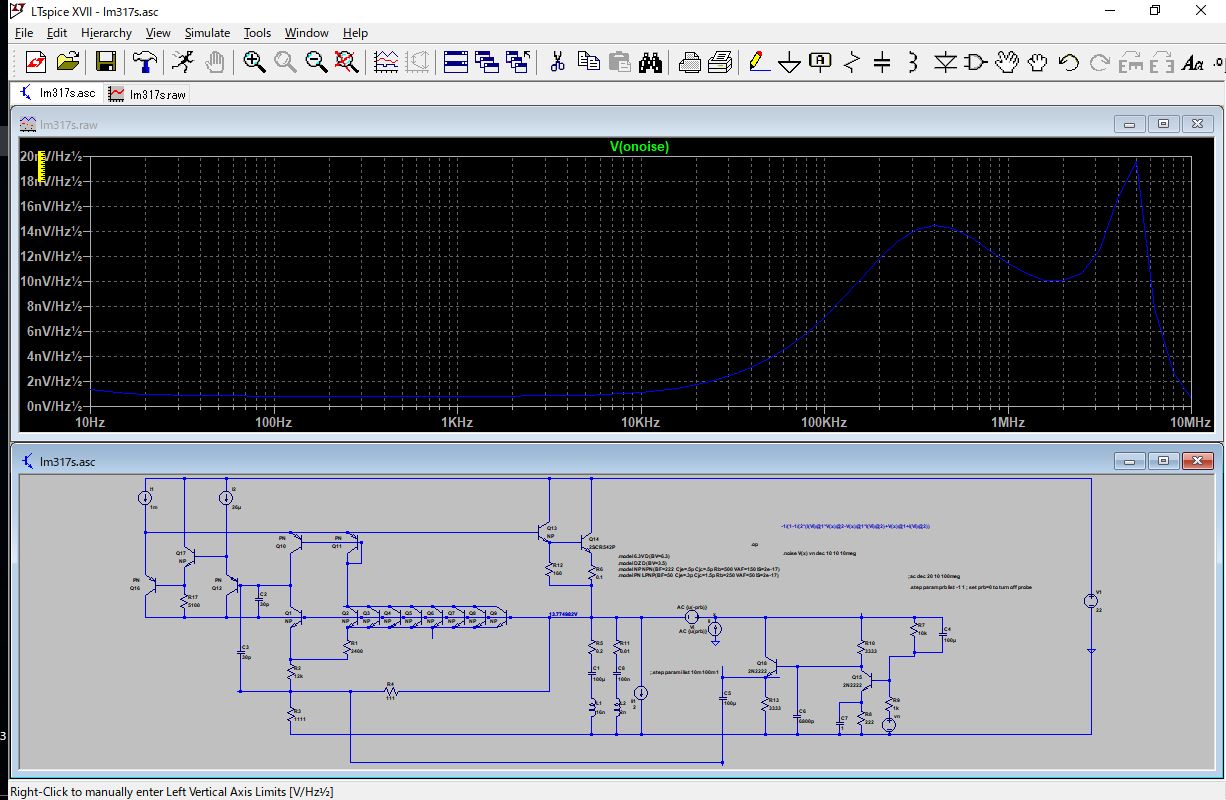

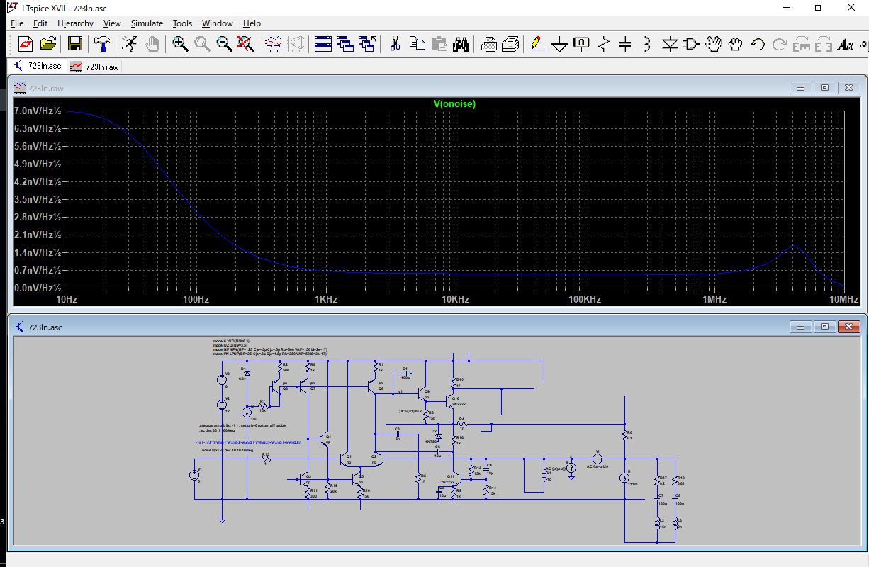

Gerhard, thank you for your excellent measurement. My power supply for an OP amp is usually four LiPO(+8V and -8v) without a regulator. A voltage reference is LiPO with the LT3042. I sometimes need a negative supply for passive I/V stage to keep compliance voltage. Problem is no negative supply like LT3042. Direct usage of LiPO without a negative regulator is possible in this situation because compliance voltage doesn't need accuracy. It works well without degradation of SNR though I haven't measured LiPO noise performance so far. I'm sure now without a regulator is a better solution in this case.
But LiPO and other battery have an incredible high current capability which can cause a fire easily. Protected type(the additional circuit is cheap) is necessary. I usually disconnect them from a board when not in use for safety. You must keep it in mind battery is dangerous.
Low noise application is where discrete transistors have advantages over ICs, regulators are not exceptions.(Gerhard, you must have professional knowledge about them.) So paralleling LT3042 or even one LT3042 are a bit extravagant I think. Pictures below is I am simulating, discrete + uA723 or LM317. They exhibit below 1nV/sqrtHz in audio frequency and DC tolerance and stability of ICs. Though this is not complete circuit, no discharging diode for caps yet.
BTW I agree to diyralf's opinion, I know circuit like this or LT3042 are objectively overquality to typical audio circuits but it is fan to be a audiophile.

It Will cost more money and time to build a circuit that performs equally well. LM723 is very good but at the cost of higher component count and it is not LDO.
I don’t see an objection to choose the best available part for 5 Euro. At least one area of the design will cause no sorrows.
