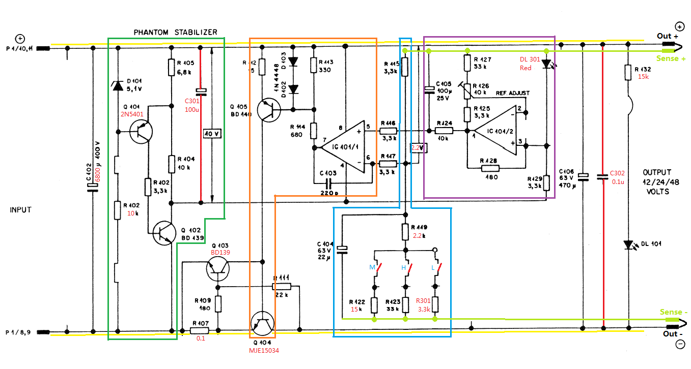

Regarding to 1.5A limitation, with further investigation one can see it is because D102, D103 serve as limiter, so the circuit is designed to maximally provide 1.5A output current.
With D102 & D103 removed and continue the simulation, now the circuit can provide up to 2.5A and fail again before 3A.

(1) Just removal. Since D102 and D103 are in series, removal of anyone will do the trick.
(2) R107 also serves as current limiter, it is used to turn on Q103 to drain base current from bypass transistor Q104 when current through it exceed 0.6V/R107, 2.2 ohm will set the limiting current to ~270mA. In my module, it is 0.1 ohm, which set limit current @6A.
(3) So yes, you also have to check R107 to see if it is appropriate. e.g if you want to supply maximally 2A from the module, other than removal of diodes, change R107 to 0.3 ohm/1W too.
If you look at the circuit, there is a current limiting resistor R407 in the return line of 0.1 ohms, and a current limiter transistor Q103 that siphons off base drive for the pass transistor when the current reaches about 6A.
The two diodes limit the base current into the pass device but because the ratio collector current to base current of the pass device can vary all over the place, it doesn't make for a dependable current limiter. It may be 2A but then again 5A or 1A with another pass device. The diodes mainly limit current into the pass transistor base and also protect Q105 of course.
The better way is to set R407 for the wanted current limit, that is better defined and dependable, limiting current when the voltage across R407 reaches about 0.65V.
BTW R109 and R111 modify that current limit somewhat to make it limit at lower currents when the Vce of Q404 is high. A good precaution.

Thanks Jan for clarification. Yes, the original value of R107 is 1.65 ohm which will set the current limit @ 400mA, way ahead of D102, and D103 start to kick in.

Yes I think this supply should be good for an amp or two? Like 0.33 ohms for the CL R? More than the Jung/Didden superreg is rated for.
I noticed that there are wire stubs in the drawing on the inputs of the ref opamp, were there opposite diodes there for protection? Also on the error amp; often horrible things happen at switch on and seitch off.

To clarify: To enable 2A, may be best to replace R407. Do you have a recommended value?
Also mentioned was R109 and R111 as a precaution. Any values here?

(1)
Going back to the original Studer 900 circuit might give a little more inside how R107, R109 & R111 work togather to limit the current & power consumption of
Q104 & load.
Vbe_Q103 = R107||R108 * I + Vce_Q104 * 180/(22k+180), where R107||R108 = 1.65
Q103 will be turned on when Vbe_Q103 = 0.65V, or I_limit = (0.65 - Vce_Q104 * 180/(22k+180))/1.65
Power comsumption of Q104, P_Q104 = Vce_Q104 * I_limit = Vce_Q104 * (0.65 - Vce_Q104 * 180/(22k+180))/1.65
The maximal power comsumption occur when 2 * Vce_Q104 * 180 / (22k + 180) = 0.65, or Vce_Q104 = 0.65 * (22k + 180)/(180 * 2) = 40.047V
Below list some values for reference:
Vce_Q104.I_limit............P_Q104......P_load = (52V - Vce_Q104) * I_limit when Vin = 52VDC
0_______ 394mA_______0W
4_______374mA_______1.497W___18W (48V)
5_______369mA_______1.847W
7_______360mA_______2.517W
10______345mA_______3.448W
28______256mA_______7.174W___6W (24V)
35______222mA_______7.763W
40.047___197mA_______7.888W___2.4W (12V)
45______173mA_______7.767W
50______148mA_______7.401W
65_______74mA_______4.826W
80.094_____0mA_______0W
Here I assume fixed Vin = 52VDC, and a switch change output between 12, 24 & 48 volts.
So the original circuit is designed to provide 200mA@12V (2.4W), 250mA@24V (6W), 370mA@48V (18W) at load, and also limit power consumption <8W at pass transistor Q104.
If you don't want current limit vary with Vce, the easiest way is to remove R111 and short R109, then R107 will simply be 0.65V/2A = 0.33 ohm regardless of Vce.
then choose a heat sink big enough for worst case Vce value.
If you want to keep R109 & R111 intact, then use worse case Vce to calculate the needed R107 value. e.g. if biggest Vce is 7V then R107 = [0.65-7*180/(22k
+180)]/2A = 0.3 ohm.
(2) It is not directly related, but Vce will depend on AC input & V_load.
Vin_DC = Vin_AC * sqrt(2) - 2*sqrt(2)*Veff
Vin_DC = V_load + Vce + I_load*R107 ~= V_load + Vce
=> Vce ~= Vin_AC * sqrt(2) - 2*sqrt(2)*Veff - V_load
Now in worst case, Vin_AC = Nominal_AC * Lr * Tr, where Lr is line regulation & Tr is transformer regulation
assume Lr = 1.1 (230V -> 253V) and Tr is 5% @2A then Vin_AC = 12V * 1.1 * 1.05 = 13.86VAC
assume Veff = 1V @ 2A, then Vin_DC = 13.86 * sqrt(2) - 2*sqrt(2)*1 = 16.77
lets say your intended dc out value V_load is 10V, then worst case Vce will be 6.77V
It is very complicated to calculate Veff. Under light load it will approach diode forward voltage, but will increase if load increase because of diode bulk
internal resistance, usually I just measure it.
Using Tslema 35VA transformer Veff ~= 0.7 @0.5A & ~= 0.87 @1A.

You can check the original extract from Studer 900 circuit from post #39, "regulator studer900.pdf". I modified that circuit to reflect where the kit I bought is different from the original design. The wire stubs is deliberately left there to indicate removed parts. The missed part in the ref op is a 22p cap.
One thing I like about this design beside its potential to provide higher current is separating op power supply from the output voltage, so for 5V output it still can use 10V op. I know it might not perform at the same level as superreg which uses clean output voltage to power op and related circuit, but it is very convenient to design this way.

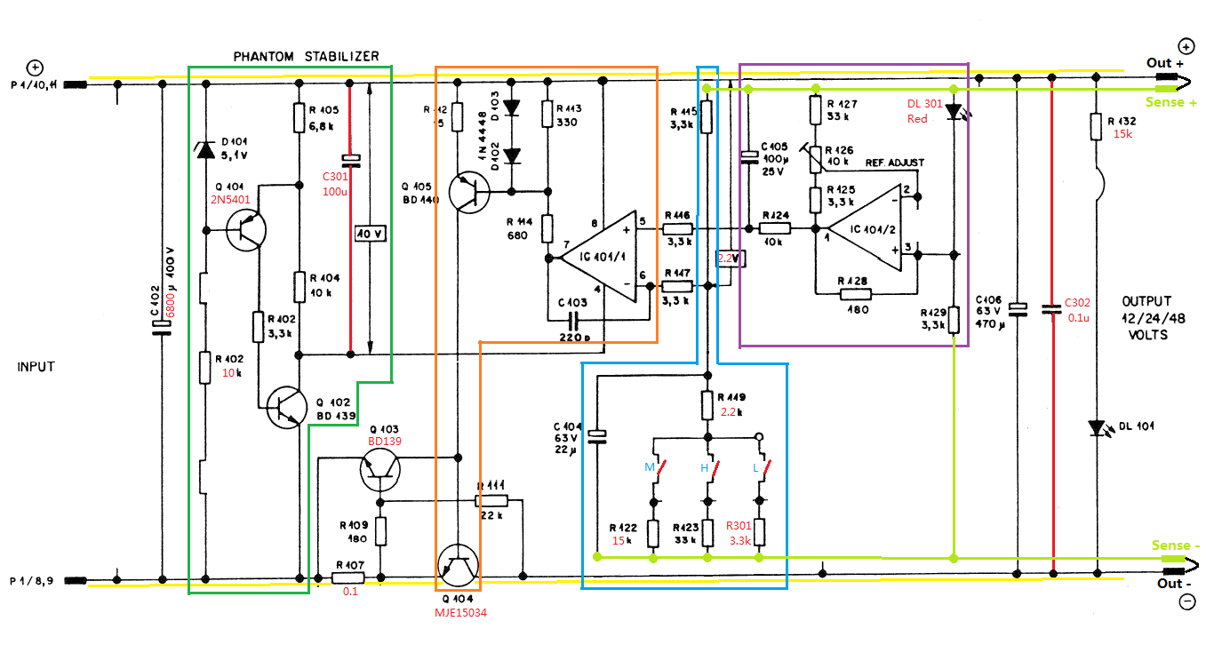

For those with experience, the attached diagram show you how to modify the board to do remote sensing. Also you can power the reference led with clean output ground instead of dirtier 10V virtual ground (~0.4mV ripple @ 0.5A load).
