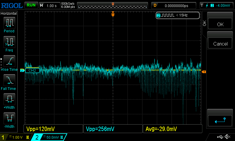

I don't understand what you say, nor I want to. See how LM4562 looks on a scope screen.
a). I'm happy with my 830 board;
b). My setup is the simplest way to differentiate an IC for undocumented feature
c). I do know what the issue, but it's illegal topic and already deleted by moderator.
I 'm asking again, plz, I don't need any advise.
My test results with NJM2122 shows, that IC outperforms OPA227 & OPA2202 !
And it's even competitive with AZ MCP6V97/87 , MAX44251 on low frequency end 0.1-10 Hz

Instead of continuing with these invalid generalizations you should just state what you actually found out which is that NJM2122 seems to work better with your test circuit on a 830 protoboard.
Reactions: dkfan9 and ejp
The damn metal to metal contacts of those protoboards produce more low frequency noise (sub 10 Hz) than most op amps, let alone “good” ones. Drift (which is very low frequency noise) measurements can’t be trusted.
And just because something doesnt outright oscillate in a poor grounding/decoupling environment doesnt mean that it’s achieving the best performance that it can. You leave capability on the table.

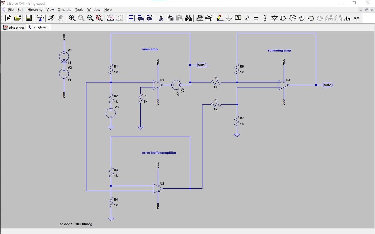

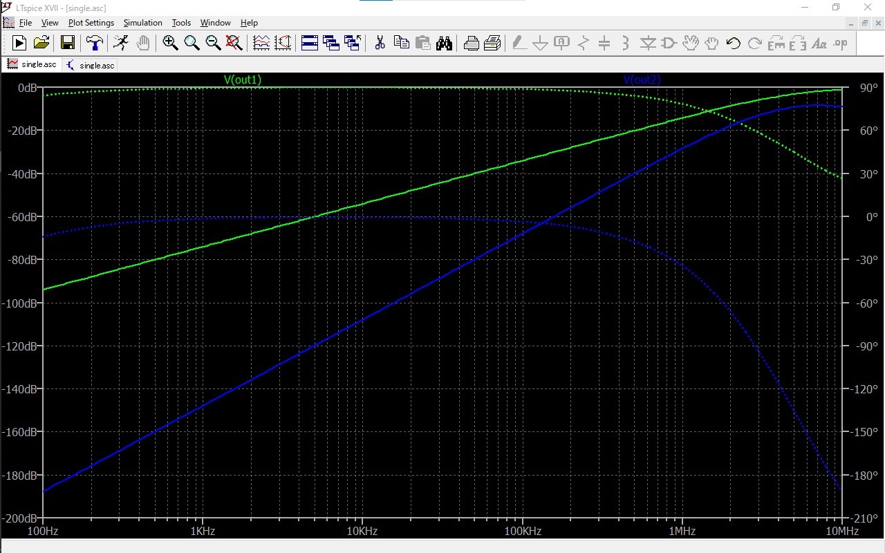

Unfortunately, NJM2122 is planned to be discontinued.
They are good opamp for some applications such as microphone amplifier, but a unique example, Accuphase uses them in the line level error feed-forward circuit ANCC.
It senses inverting input of the inverting amplifier where are 1/(1+Aβ) of the distortion, then amplify them to -1/β time and add the first inverting amplifier output resulting error correction.

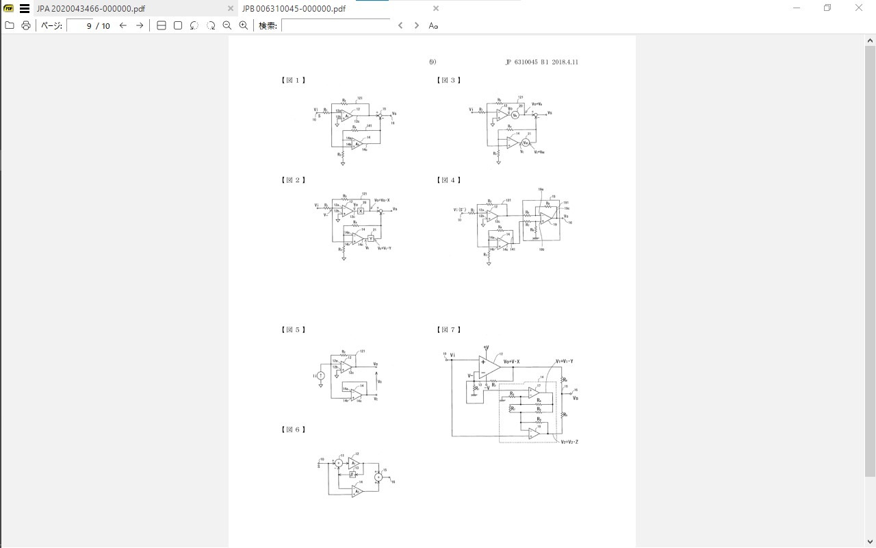

Well, maybe 1% tolerance resistor? The schematic is not actual circuit from their products as you see the error amplification amp is 2 of closed loop gain, which is not applicable with NJM2122.
I had replicated it from pictures of PCBs but yesterday I found it had been patented in Japan, then confirmed the circuit topology is correct.
