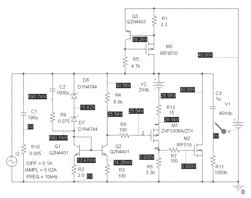

I've been poking around with the "Amplified Zener" shunt reulator (the second shunt I presented here), and found that a couple of small tweaks greatly improved the output impedance and THD.
Please note the attached schematic. I added a voltage drop in series with mosfet M1. Ideally, this should be a voltage drop with as low an impedance as possible, so as not to add too much degeneration to M1. In this schematic I used a 2V voltage source and 15 ohms in series to approximate a GaP yellow-green LED. I've found that a small mosfet like the 2N7000 or BS170, etc. with gate connected to drain works pretty well, too.
Adding the extra drop in series with the source of M! allows me to increase the value of Resistor R4, increasing the loop gain of the regulator. To get the desired 30V output, I used two 15V, 1W zeners in series, as for some reason, Orcad/PSpice doesn't have the model for the 30V device.
The last thing I did was to increase the bias current in the current source feeding the regulator by reducing the Value of R1 from 4R7 to 3R3. This increased the bias current from ~150 mA to a little over 200mA.

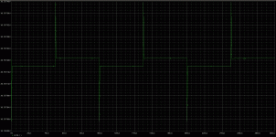

This first slide show the response of a current step from 50mA to 100mA, 50usec wide, with 100 nsec edges and 100usec rep rate. This is quite a rigorous test, a much more severe load than any audio preamp would represent in normal operation.
The output transient response at the leading and trailing edges is dominated by the ESR of the output capacitor (190 uF, 0.005 ohms, equivalent to 4 X Nichicon 47uF, 50V polymer caps in parallel).
The transient settles down to a DC response to the load step indicating an output impedance of 0.6 milliohms.This will be hard to realize in an actual circuit simply because the amp/regulator has to be a finite size, and the traces hooking the parts together don't exactly have zero resistance

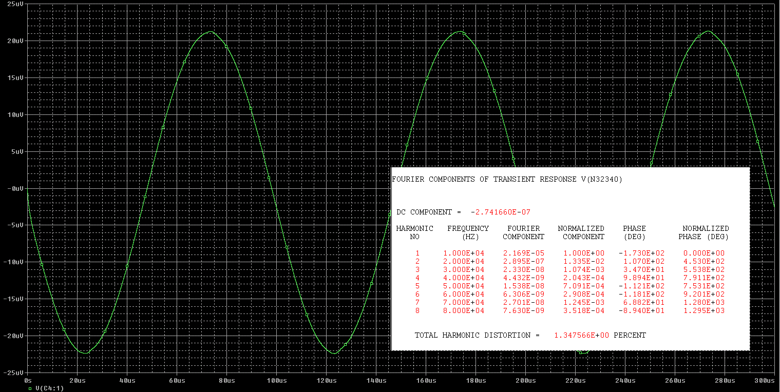

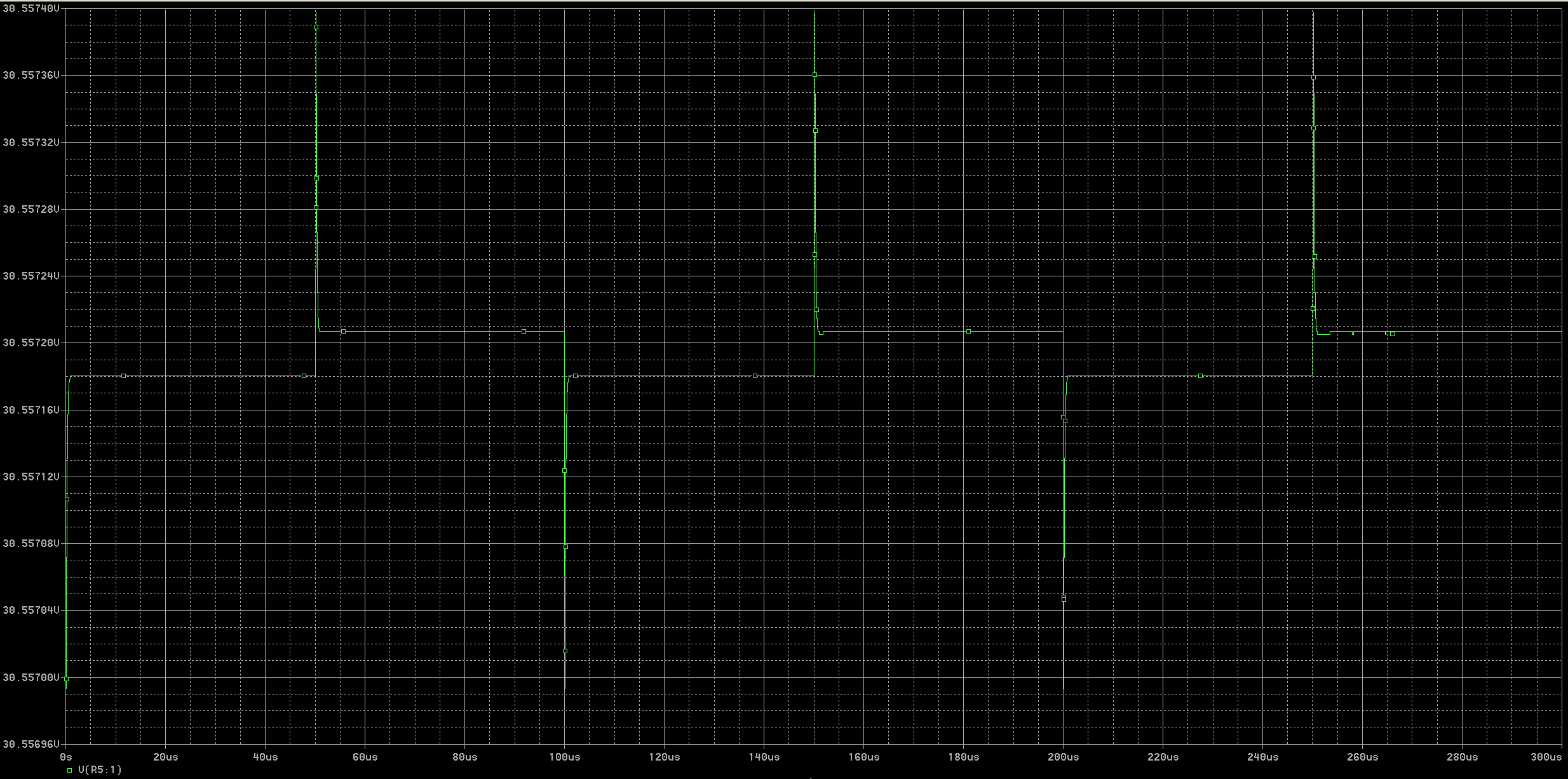

Finally, here's the response to a 20mA, 10kHz sine current source superimposed on a 100mA static load. This is a much more severe load than would be represented in practice by a normal preamp circuit (what would your preamp be doing to draw 20mA at 10kHz?). The voltage excursion induced by the sine current is small, and the THD has been improved by the changes.
It appears that the family of shunt regulators shown here (and I expect others as well) benefit greatly from extra loop gain, and more importantly, increased bias current.

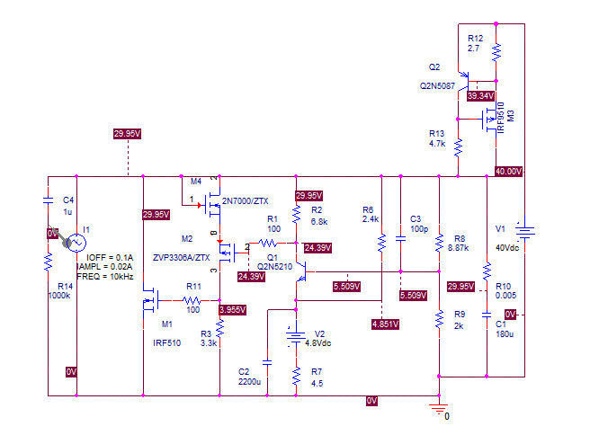

Attached is a schematic for an improved version of shunt regulator #3 presented here previously. Adding extra voltage drop (in the guise of a 2N7000 with drain connected to source) in the pmos gain element allowed me to increase the load resistor in the previous stage, increasing the loop gain of the regulator. Increasing the bias current (2.7 ohms vs. 4.7 ohms for the current-setting resistor in the ring-of-two current source feeding the shunt) also improved things quite a bit.
This is in line with some observations made in passing by Salas in his "Simplistic RIAA" regarding improved lisenability with increased bias current in his shunt regulator. I'm not going to even try extracting that information from that sprawling pile of a thread - if someone else feels eagar enough to dig for it, they can have at it. Maybe Salas will happen by and help out - it's been known to happen... At any rate, the improved THD with higher bias current may point to a reson for the improved listenability.

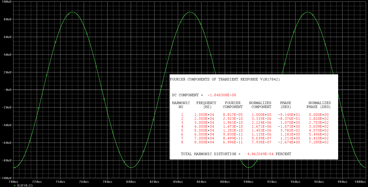

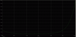

Here is the actual 10kHz sine response and THD. Keep in mind that this is for a 20mA sine excursion on top of a 100mA load - a far more severe test than one would encounter in normal operation. The sine is clean, and the THS is low. There should be correspondingly lower THD with a smaller current excursion, but it's hard to demonstrate in simulatiion, as the results get grainy with smaller excursions.

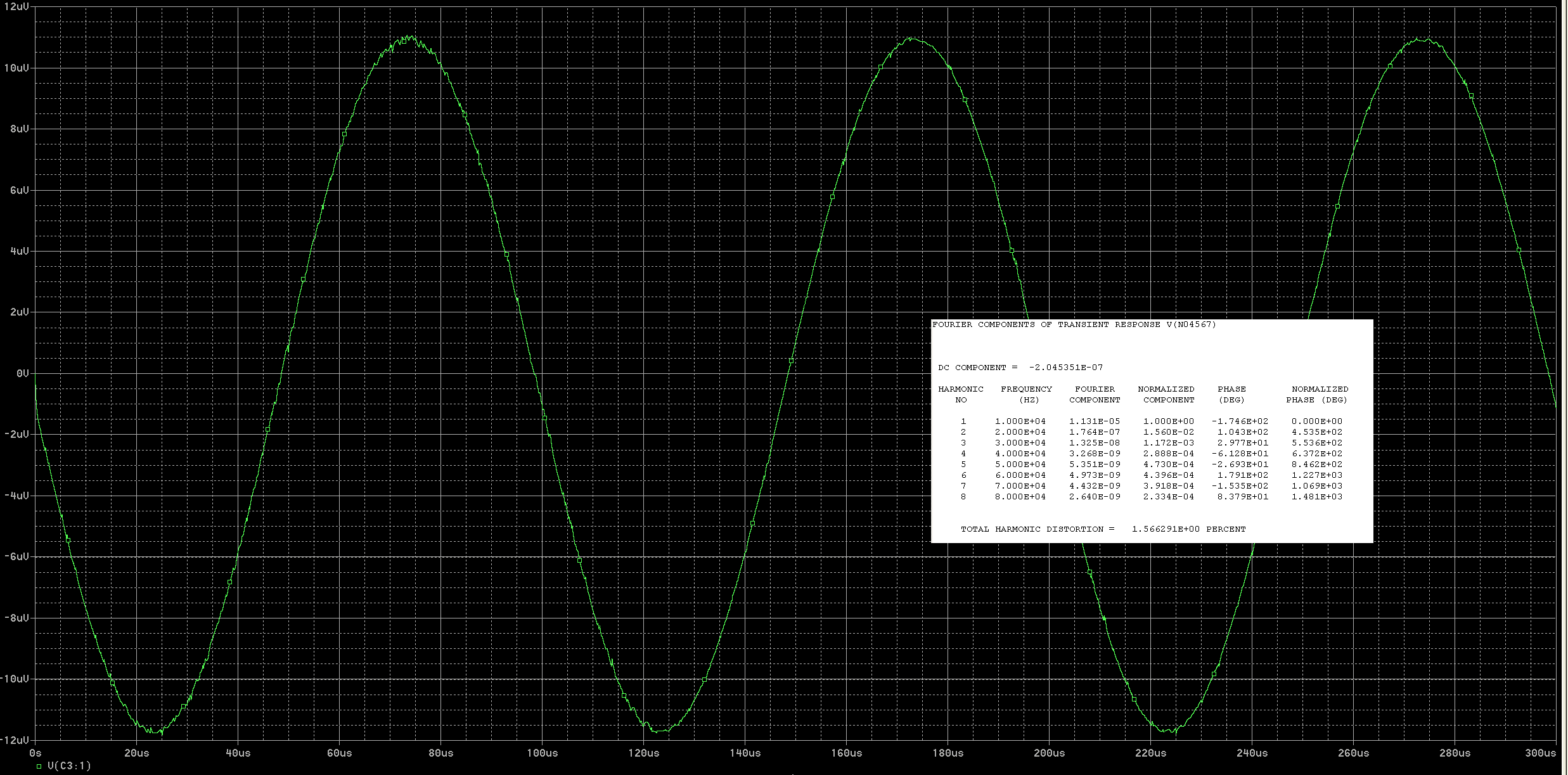

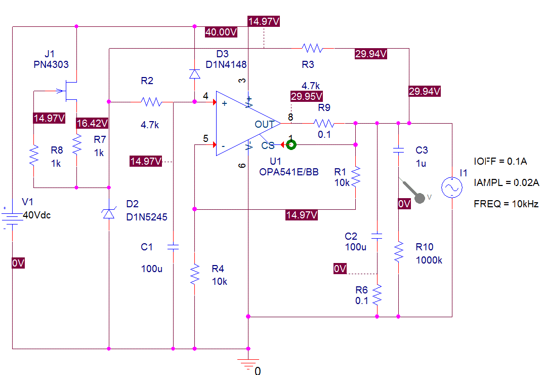

Just for grins, I ginned up a simulation using a OPA541 power opamp as a series-pass regulator that can both source and sink current. It needed relatively few parts to get going, and its response to a 10kHz sine current load was clean. It may be that the key to cleanliness is the ability to source and sink current. I'll find out when I compare that solution to a conventional opamp-based regulartor that can only source current.

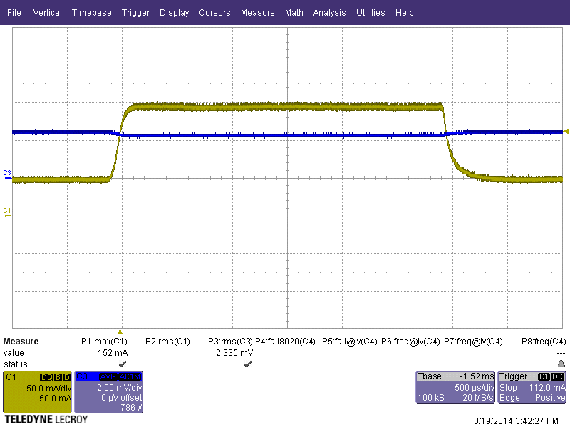

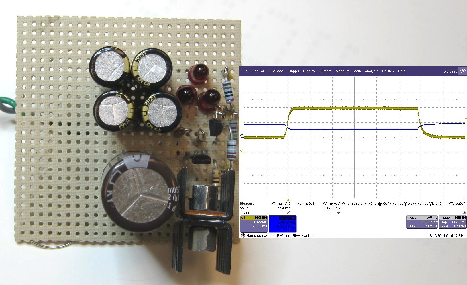

Last night, I built up a grubby perf-board prototype of the series-pass regulator shown in post #17 of this thread, though without C4/R14 and C3/R13. I also used an IRF9610 rather than an IRF9520 for M2.
The supply regulated nicely at around 30.2 VDC for a 40 VDC input. At work today, I loaded it with one of our Kikusui electronic loads and gave it a dynamic load step, while monitoring the output voltage with an AC coupled 1X probe. The output response to the load step is very well-behaved. You can't see the output noise of the power supply over the self noise of the digital scope (the trace with power supply is no thicker than the thickness with no supply connected). The supply shows a ~0.8mV excursion for a 100ma load step, which works out to 8 milliohm output impedance. If I changed my monitoring point to near where the output voltage is actually sensed by the regulator, I may be able to better that.

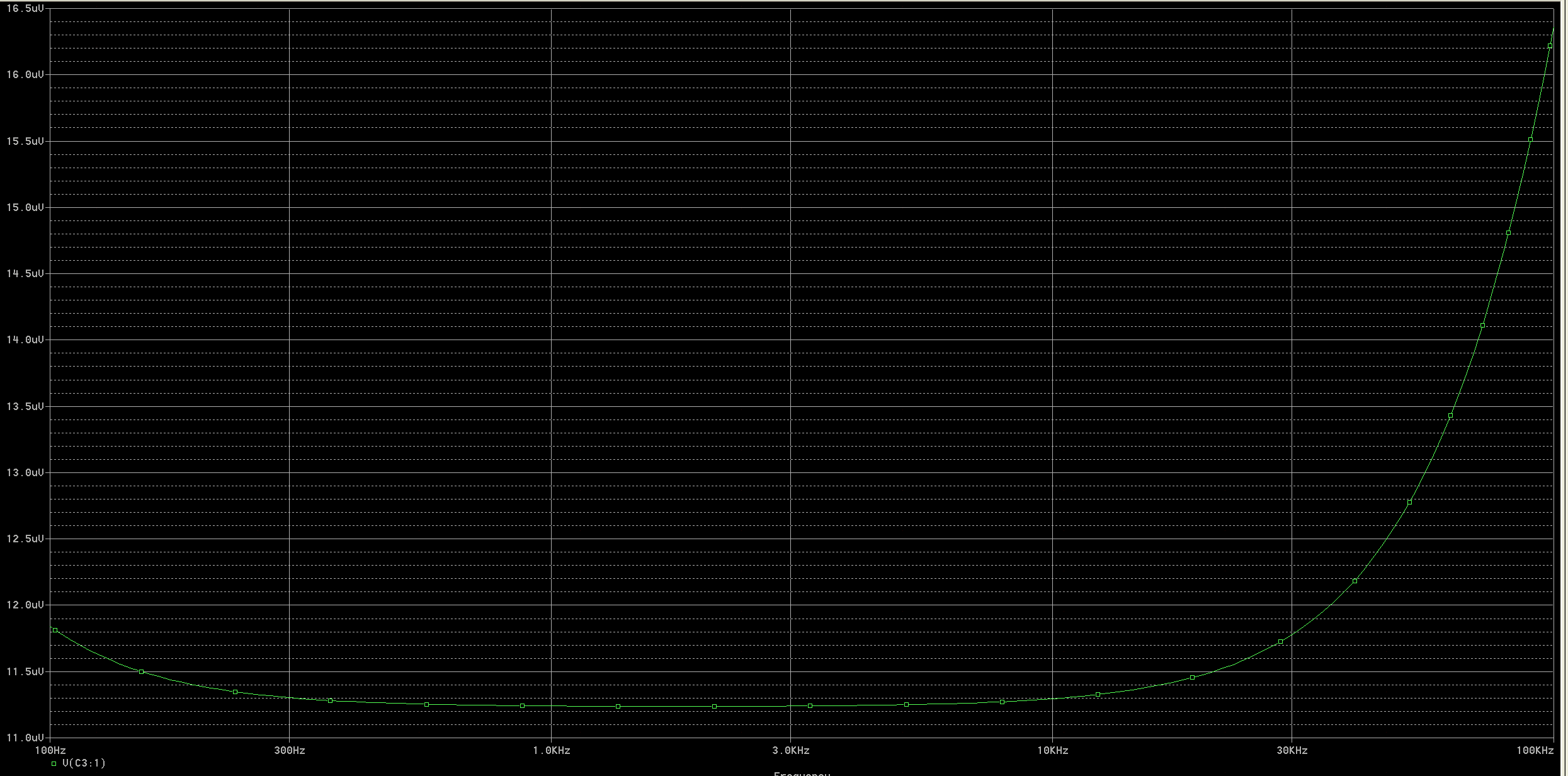

For grins, here is a regulator based on an OPA541 power opamp. I'd expect similar behavior out of an OPA549. This is quite possibly the only way I'd let one of these things near my audio gear... At any rate, the parts count is not too extreme, and it behaves itself, though more tweaking of the output capacitance may be in order. The error associated with the current sense node doesn't appear to be affecting the operation.
THe output impedance of the regulator as presented is nothing particularly shecial (~4.5 milliohms). The response to a sine wave current source load (20 mA with 0.1A DC bias) is pretty pure, no doubt helped along by the fact that the opamp is running Class A, and the fact that there's all that open loop gain to be had...
