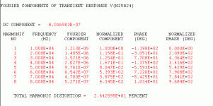

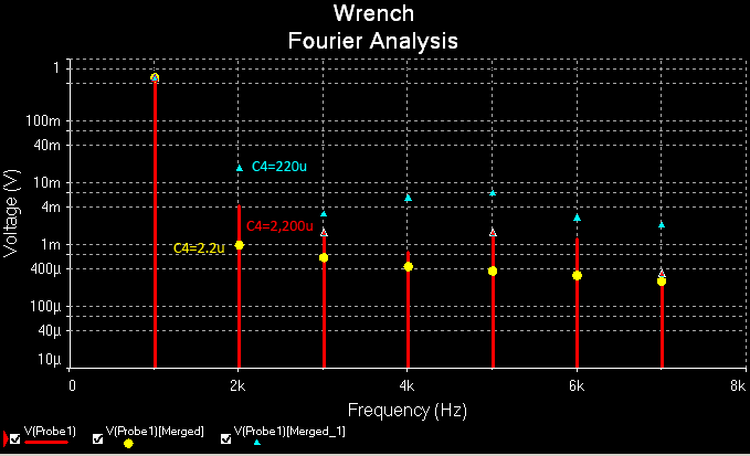

If you apply a small sine signal to the ouptut node, look at the FFT simulation of non-linearities with various values of C4:

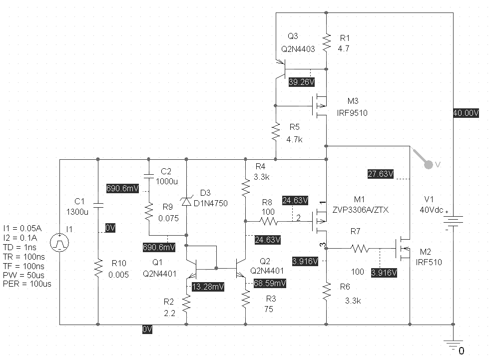

It would help if you described your test setup a little better, along with the circuit you tested. I might try a scan with a modulated current source to look at output impedance vs. frequency. I'd like to keep the low ESR caps at the regulator output, but no one says they have to have a huge capacitance associated with them (good high current polypropylenes or stacked-film polyesters come to mind). Easy to simulate, anyway.

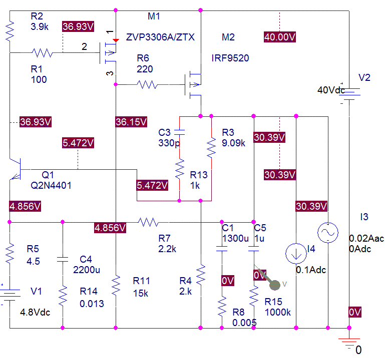

The circuit is the one you proposed in post 17. It appeared to me that value of C4 significantly over-damped the response, so I used a sine wave to look at the non-linearity - in simulation, of course. The idea wasn't original to me, but suggested by one of the folks corresponding to the regulator shoot-out article in Linear Audio.
Here's an output impedance scan taken by placing both a 0.1 A static load and a 0.02 A sine wave load on the output of the series-pass regulator. It looks like next time around I could use just the sine-wave current source, as it has provision for DC bias. I kept the 1300uF output capacitor with 5 milliohm impedance.
The schematic is attached for reference. I used a 1uF coupling capacitor with 100k (1M) to probe the output voltage excursion.

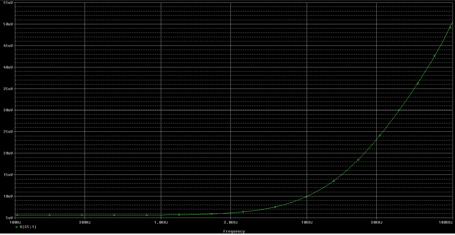

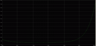

Here's the output scan - divide the results by 0.02 to get the effective output impedance. The loop is still working to reduce the output impedance at 100 kHz, as you still don't get the full 0.02A X 0.005 ESR X Current signal at 100kHz. Next up would be to try this with some nice simulated film caps (Lower ESR) to look at both this plot and the time-domain transient response. I have a bunch of 2 uF Evox polypropylene caps that may be just the ticket.

Here is the variant of the series pass regulator used for time domain pulse response, output impedance vs. frequency, and fourier /THD analysis. The output capacitace represents 4 pieces of a Nichicon 47uF, 50V polymer capacitor, 22 milliohms ESR, so the composite capacitor is 190 uF, 5 miliohms. A 1uF coupling cap in series with a 1M (1000k) resistor is used as an output probe.

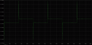

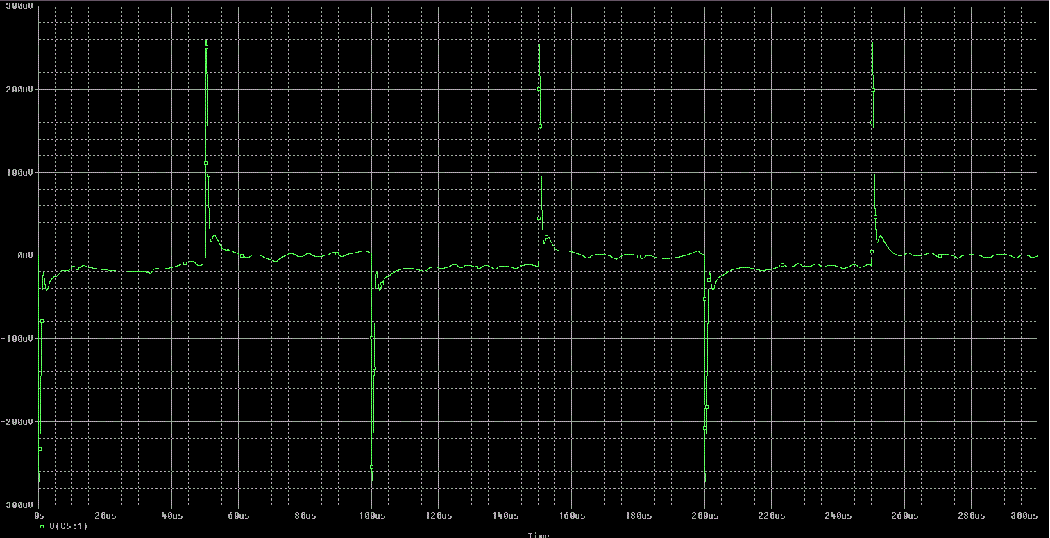

Here's the time domain pulse response to a fast 50 mA current pulse. The regulator responds cleanly to the current pulse, but there is also low level "squiggle" between whacks. Is this important? Maybe - we'll see later. You don't see the low level garbage with #2 regulator, the boosted zener.

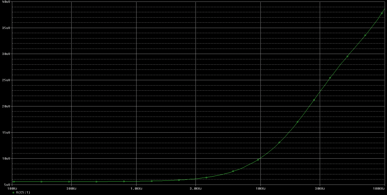

Hese's a an output impedance scan using a 20mA swept sinewave current source superimposed on a 0.1 A DC load. To get the output impedance, divide the voltage shown on the graph by 0.02. This scan looks benign, but it doesn't tell the whole story, as I have mentioned earlier.

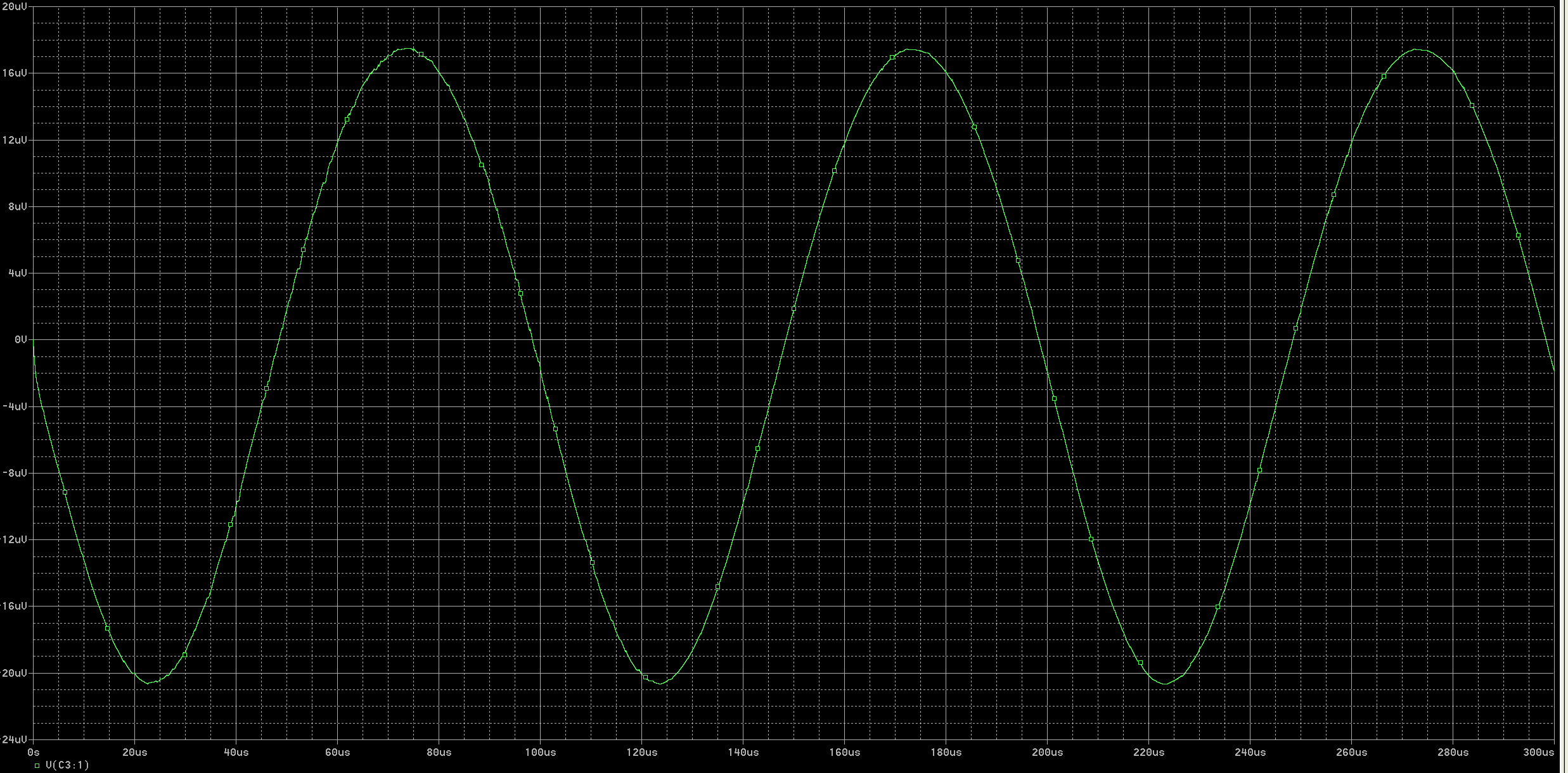

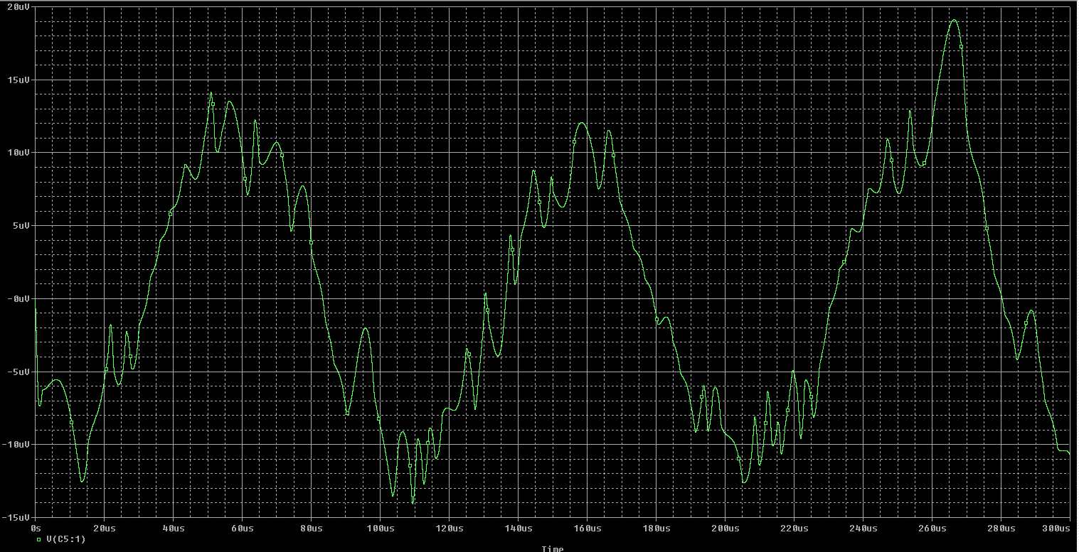

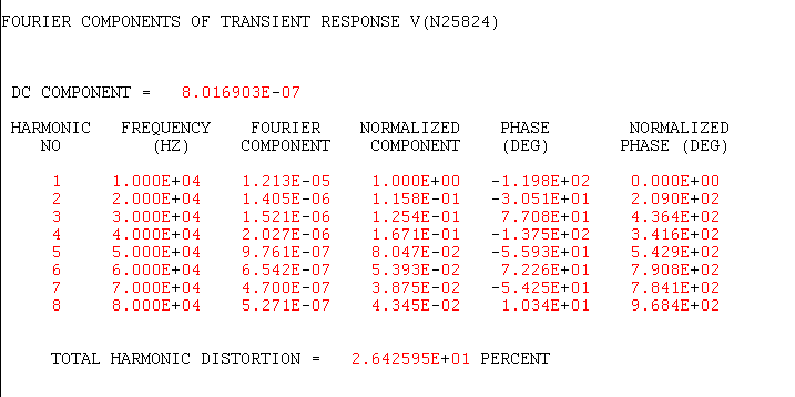

Here's the response to a 10 kHz, 20 ma sine current source superimposed on a 100 mA DC load. You would expect to see a relatively clean-looking sine response, so what's all the crud riding on the basic waveform? Keep in mind, this regulator hasn't been built yet. It looks like there's some fixing left to do, probably in the realm of improved compensation.
Here's what that crud does to the output THD, pretty much in line with what jackinnj observed a few posts ago. The more telling plot is the previous one showing the response to a clean sine wave excitation. I suspect that the crud shown in that picture is similar in nature to the stuff that shows up in the pulse response. At any rate, something still needs fixing. I'll post the results when I figure things out, but I won't promise when...

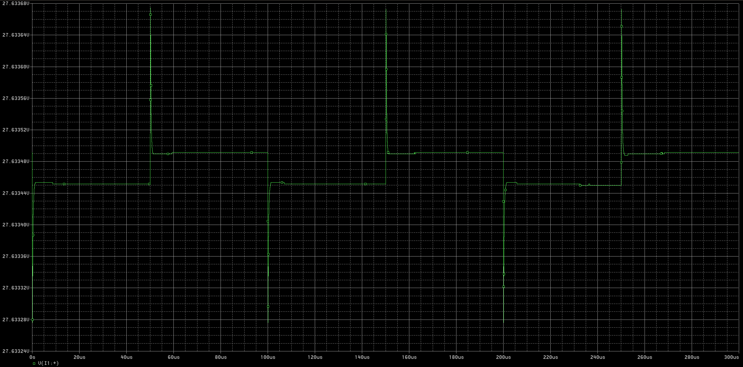

OK, this is a repeat of the aforementioned zener diode-based shunt regulator scheme, with a 190 uF, 0.005 ohm output cap representing 4 X 47 uF, 50V Nichicon polymer capacitors. I may try a pulse response using film capacitors instead to see if this regulator fares better with small value, low ESR caps than the series regulator did.

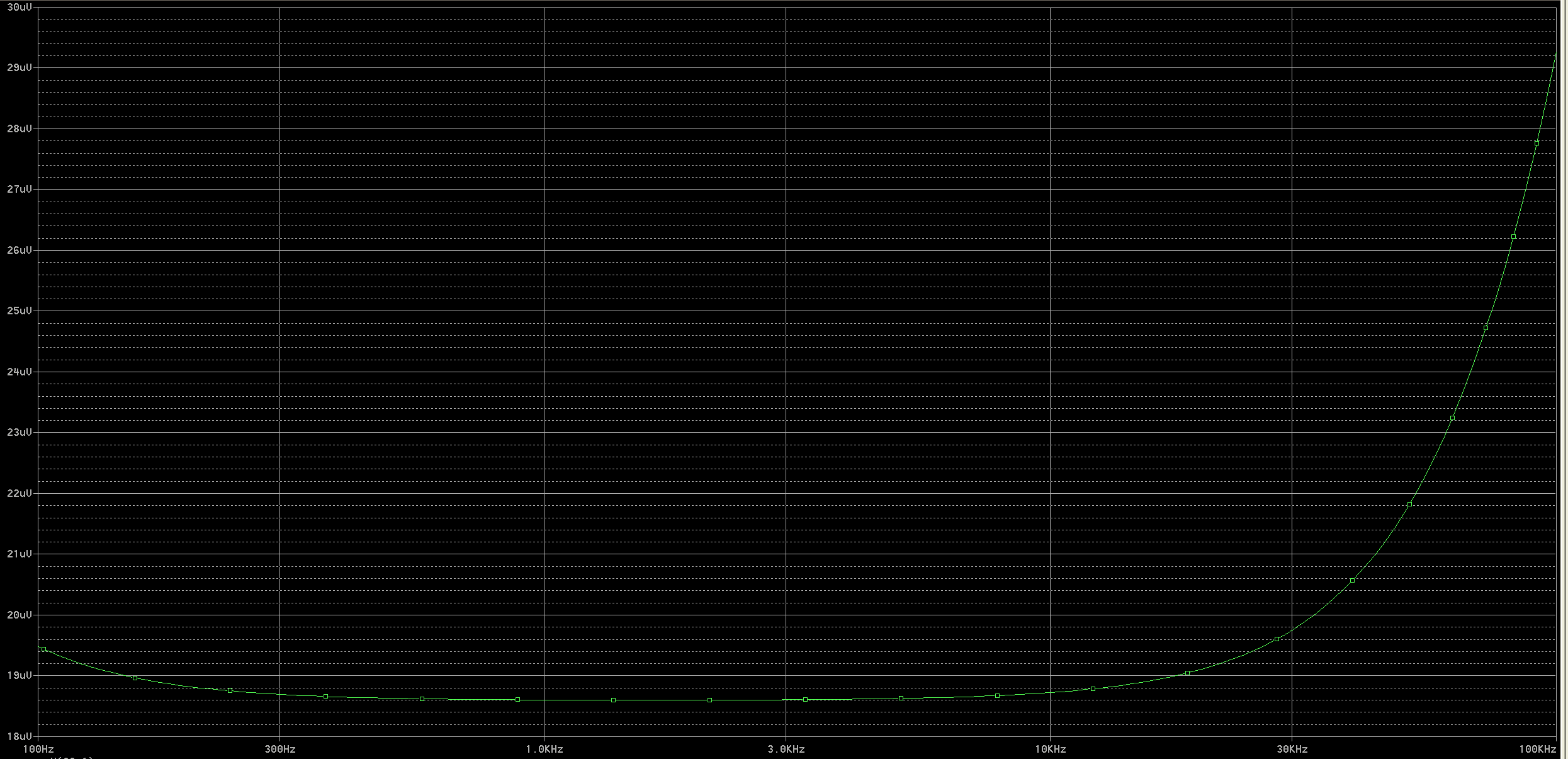

With the pulsed load replaced by a swept sine current source with 0.02A AC component and 0.1A DC bias, here's a plot of the output voltage excursion that can be used to calculate output impedance vs. frequency. Divide the voltage excursion by 0.02 to get output impedance. This regulator starts with higher output impedance than the series pass regulator, but is lower impedance at high frequency.

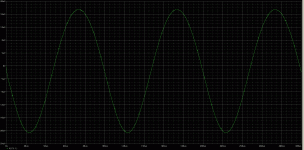

Here's the response of the regulator to a 10kHz sine wave current source at 0.02A amplitude and a 0.1A DC component. Note that this response looks much cleaner than the series regulator response shown a few posts back.

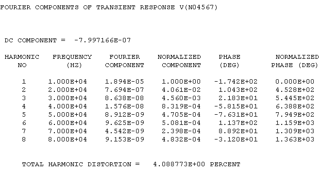

Here's the THD of the response shown in the previous post. I'm not sure what this data really means, as the output excursion is so small to begin with. Perhaps I should check out the regulator shoot-out article in Linear Audio cited by Jackinnj. At any rate, the visible dirt shown in the linear regulator's response to sine wave excitation is absent here, and the THD is less.
