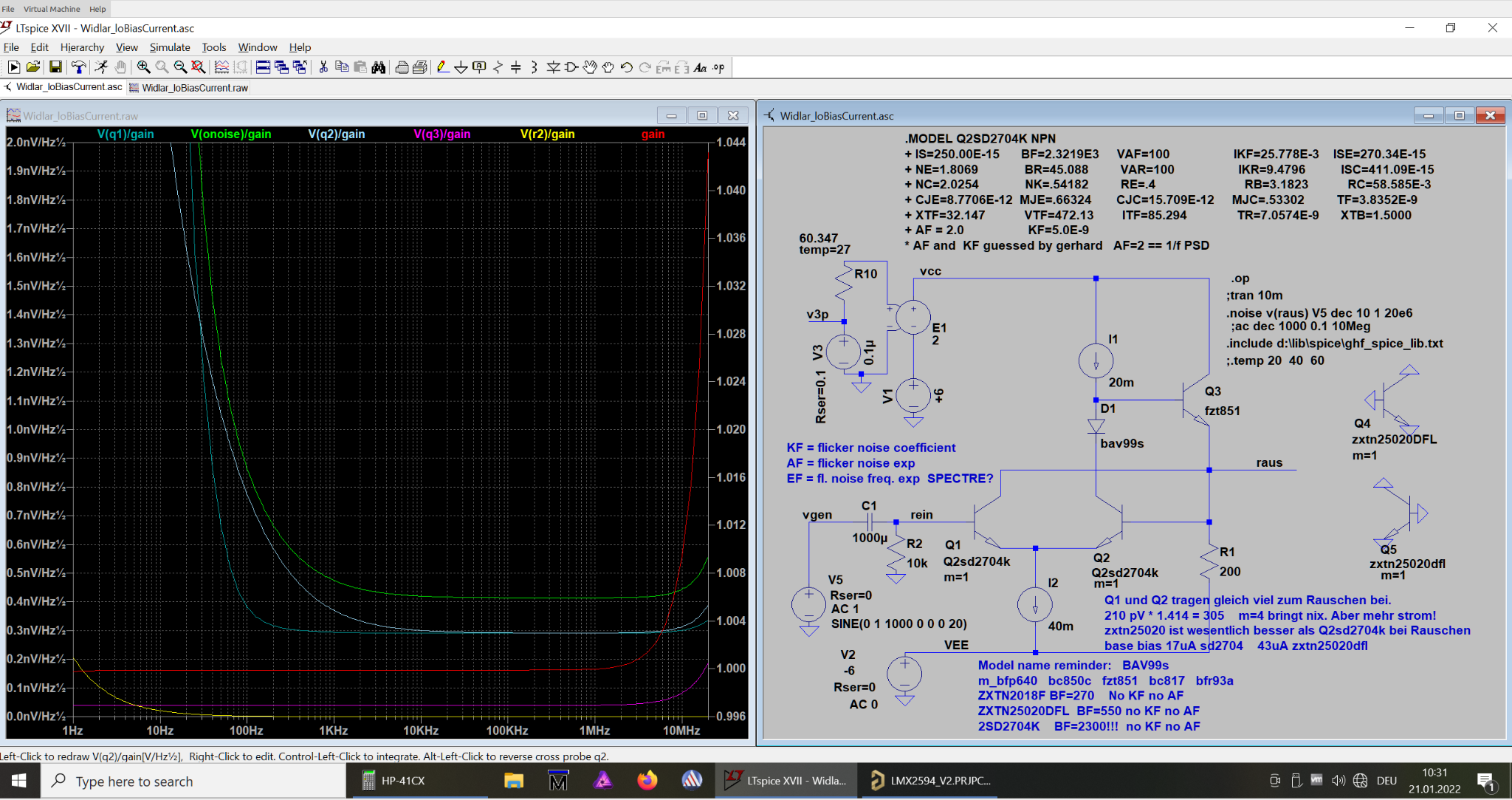

Nobody likes this one?
One of the few remaining options for Bob Widlar's FET input replacement circuit.
It really needs super-beta transistors.
Q4 and Q5 are only parking lots.
cheers, Gerhard

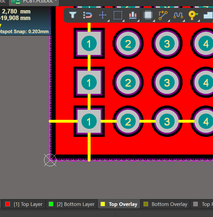

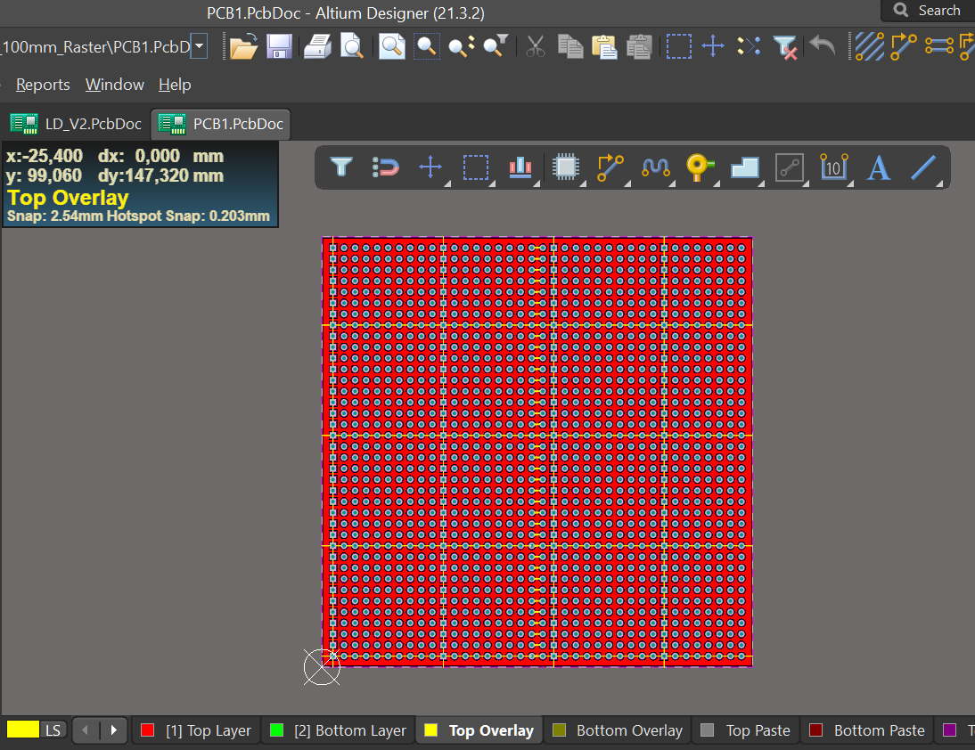

I have made a 100*100mm prototype board with GND and VCC planes.That used to be the home of some RF electronics made by Kathrein.
I bought half a dozen from ebay and emptied them. Top and bottom
plates are from steel. The proto board with ground mesh:
www.segor.de
That's even cheaper than the power plane boards available from Segor,
let alone BIC-Vero. Gerbers or Altium available.
JLCpcb did not even complain b/c of the many bore holes.
I would only use the ZTX devices in an MC amplifier. Current noise is a big issue in MM amplifiers so a better choice is a JFET IPS.I've read that chapter, but still not sure if I got this right - ZTX851 has lowest noise with a current around 10mA. So probably circuit shall be altered to that. Also, it seems that the whole ZTX series is very low noise. I can get ZTX450 locally for reasonable price, what do you guys think about them?

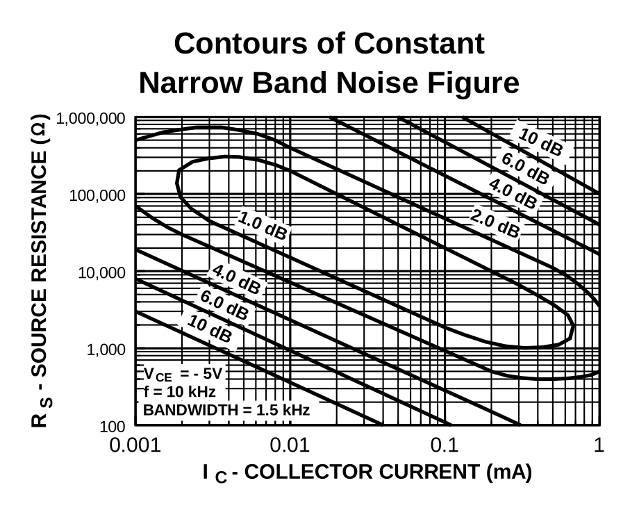

I am building a microphone preamp, so I presume current noise will not be a big deal?I would only use the ZTX devices in an MC amplifier. Current noise is a big issue in MM amplifiers so a better choice is a JFET IPS.
For a single-ended common-emitter type of input stage, neglecting 1/f noise, the following equation gives the optimal collector current. At this current, the voltage noise due to collector shot noise and the current noise due to the base shot noise have equal impacts.
IC,opt ~= (kT/q) • √hFE/(|Zs + rb|)
kT/q ~= 26 mV at room temperature
rb is the base resistance, which will be small when you use a good low-noise transistor
Zs is the source impedance, probably around 200 ohm for a typical dynamic microphone
For, for example, hFE = 625, the optimum collector current would be about 3.25 mA.
For an amplifier with differential input, you have to calculate with half the source impedance, so the optimal current per transistor almost doubles. For a single-ended amplifier with a differential pair as input stage, the optimal current per transistor is roughly √2 times the value that comes from the equation.
Mind you, noise optima are usually very broad, so when you are off by a factor of two, no one will notice the difference. You just shouldn't be off by decades.
Unless its a condensor mic high impedance buffer of course! Those are in the gigaohm range. Fortunately all condensor microphones incorporate a built-in buffer so you only have to worry about this if making your own microphones from scratch.I am building a microphone preamp, so I presume current noise will not be a big deal?
For optimal noise performance you want the ratio of voltage noise to current noise to be the same as the source impedance (or rather the absolute value of the complex source impedance to be precise). When a device's noise figure is quoted it is for a particular source impedance and standing current. Many devices have a plot of noise figure against current and source impedance which is useful for setting the optimum current for a particular situation (but little use for comparing devices). For comparing devices noise spectral density plots are more useful.
