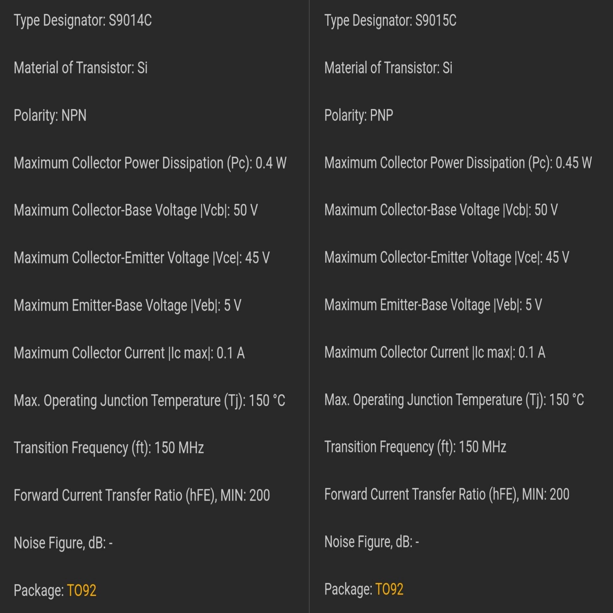

Bc549c/550c/560c all these r low noise, with higher hfe , 👍 I have bc549c germanium transistor old but has performance very nice 👍 in India not available also if available that will b fake or too high price, but s9014c/15c everywhere available and and if I compare with ktc1845/992 at voltage range wins otherwise everything is same , but BC series r also good 😊
Anything that is “available anywhere” may or may NOT be what you think it is or what they say it is. Unless it comes from an authorized distributor you simply have to take what the seller says ON FAITH.
If you are REALLY worried about noise performance I would not take it ON FAITH. For power amp input stages probably anything they sell you is probably quiet ENOUGH. But is it what they say it is? Use it in a mic pre or MC phono stage and find out. You may get lucky, you may get HISSSSSSS.

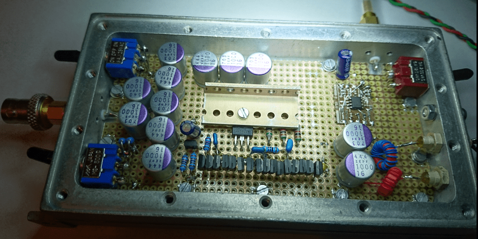

Yes. And their ribbon mic preamp works as they write.
I built a single ended version of it with only 16 instead of 64 transistors
and got the promised 75 pV/rtHz noise density.
I pay with a lot of input capacitors for the missing 48 transistors, but
I needed it single-ended anyway and the measured signals usually
ride on a DC. And the current noise is less.

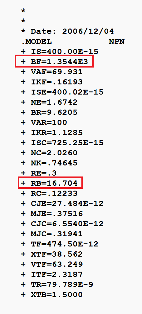

I used a whole bunch of BCM56DS and BCM53DS dual transistors in a low-noise bandgap reference some time ago, with quite good results. Yesterday I measured the noise of a BC639 and BC640, which are supposed to be single TO-92 versions of the same transistors, and calculated a base resistance of about 3.5 ohm for the PNP and 6.1 ohm for the NPN from the results.

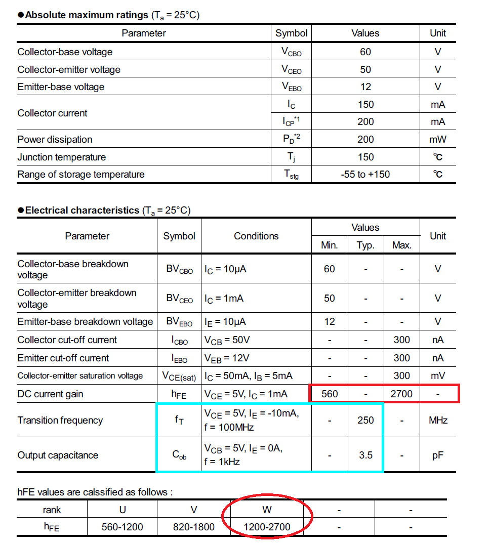

Nothing wrong with 2SD2704K either. Rb only 3.18 Ω.
.MODEL Q2SD2704K NPN
