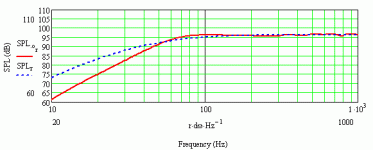

As you seem to favour the idea of a large 12in driver, here's one way of using the AN 12in CF in a smaller (these things being relative) box.
40in x 13.5in x 10.5in (HxWxD). Zdriver 16.375in. Zvent 37.5in. Vent 3in diameter x 6in long. Stuff cabinet & vent 0.5lbs ft^3 of hollow-fibre damping. Gives a quasi aperiodic damped vent alignment. The vent would need some form of grill at either end to keep the damping material in place. Basically, this is what those Seas vents are; just larger & tuned for a specific box / driver. Just cross to a pair of subs to support the LF.

Nihilist said:As it stands , it fared pretty well, but not as good as the 100% fibreglass or foam filled testboxes (regardless of fill density used).
With 100% fill of fibreglass at a density of 2lbs/cu.ft. Z goes from empty box : 38.96 ohms to 15.8 ohms. Resonance shifts from 84.54hz to 79.37hz and Qtc goes from 1.22 to .88
I've found that any damping right behind the driver -- and certainly as one gets anywhere near those densities ....
Scottmoose said:suck the life / dynamic / transient response out of it in the process.
The context of the "q drops by 0.3" is right where i'd expect it -- a box that is far too small to start with.
Ahh, but a sealed stuffed enclosure has no vent, therefore it has more linear airspring/internal box pressure. Couldn't this be advantageous ?
