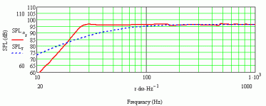

Also, I just came across this from an older post from ScottG . Looks to me like this is why aperiodic isn't as good for a large FR whereas - say, Planet10 can benefit from it because there he's using smaller full rangers:

Conversly the aperiodic enclosure significantly reduceds this back emf by reducing the box air pressure, but not enough in a typical design that it doesn't interfere with the lower excursion potential of higher bandwidths that the driver might be used for (i.e. a bass driver that operates into the midrange). In otherwords though the aperiodic enclosure does reduce back pressure which ultimatly effects excursion, it rarely is enough to NOT interfere with driver excursion at higher freq.s because those higher freq.s rely on comparitivly small excursion levels which are more easily altered due to back pressure. (and again in a normal aperiodic box the back pressure is NOT "averaged" and is effectivly dynamically "related" which is more "distortive".)

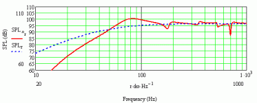

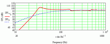

And finally, the AN 12in CF in a traditional pre T/S aligned cabinet (assuming no volume reduction & vent compensations made).
Volume is 22ft^3 -the assumption with these alignments, BTW, was that you would want maximum efficiency at Fb.
There's basically no such thing as a quirky driver that works in something it's not supposed to, because when you get back to basics, it doesn't. No driver is exempt from the laws of physics. What can happen is that some peple find response imbalances preferable to something more accurate, which is fair enough, but it doesn't alter the fact.
FWIW, these plots do not show room-gain, & assume a light quantity of damping in the respective cabinets.
