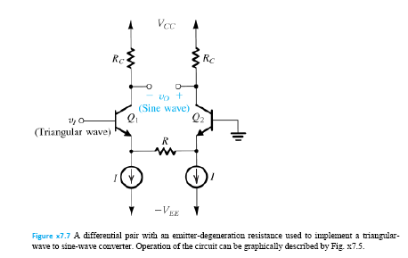

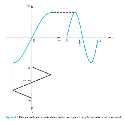

Using a PTAT current source in a tri-wave oscillator along with a sine-wave shaping circuit (Courtesy: Adel. S. Sedra, Kenneth C. Smith, Microelectronic Circuits) would give stable low distortion sinusoidal waveforms at any frequency. The oscillator capacitor can be any stable kind like polyester, polypropylene etc. and switching between different capacitors would give different frequency ranges automatically, much like function generator.
