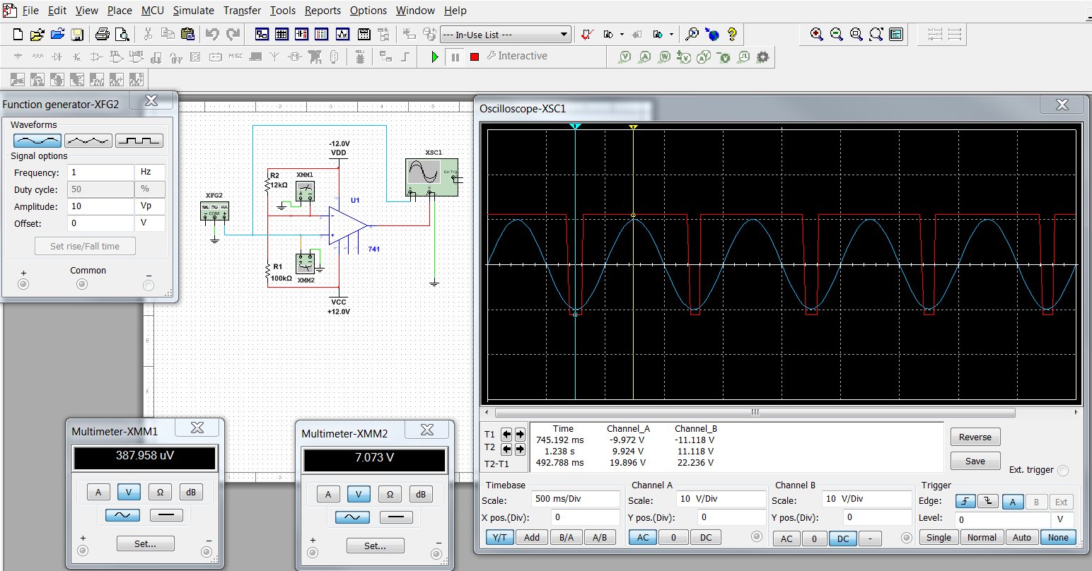

more than that actually, I had to back it down to 5Vpk to get it to be 10Vpk. The simulator show the 2nd one as 20Vpp...not the value that I entered.
This version of NI Multisim is buggy. When they released V14...it has errors. They, NI can't seem to get it fixed. Or maybe I have to use one of the vendors function generators on it.

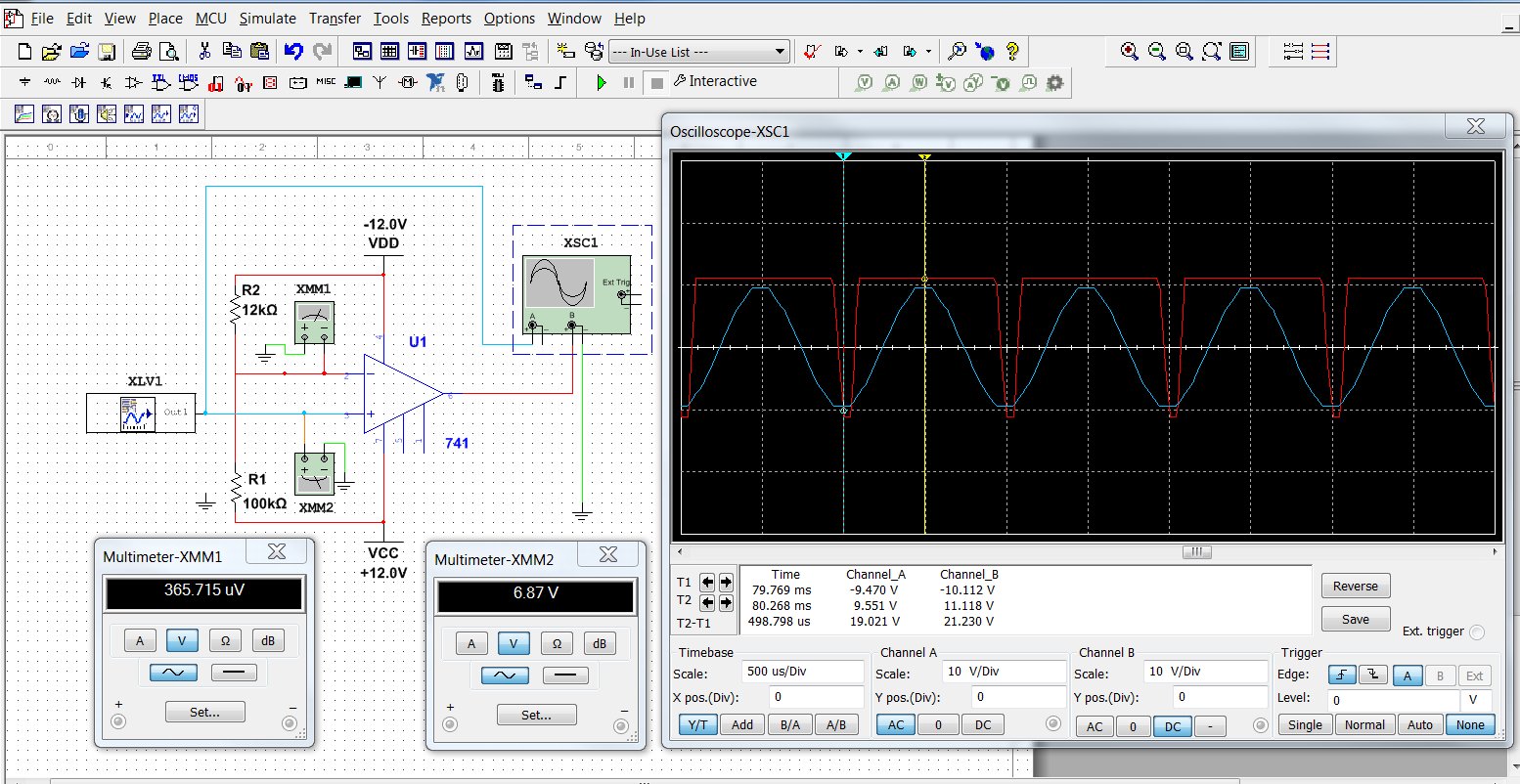

Seems to work okay with the "Labview" Sig Gen. Imagine that.
Let me see if I can change the generator impedance.
Nope I cannot change the impedance of the generator. I tried another gen an Agilent but it only went up to 10 Vp-p and wouldn't trigger the output. I don't know why as the -10Vpp sine should have as it was greater than -9.43 volt point. 50 Ohm load didn't make a difference. Input is still 20Vp!
Ah I think I see a clue in the siggen you're using - it has a balanced output. You're taking the output between the two phases - to halve the output voltage connect 'GND' on the schematic to the centre of those 3 pins (marked 'COM') not the left-most one. I reckon this'll fix it.
