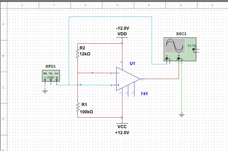

Woops, I forgot to upload the schematic.
The output of the function generator is completely different than a simple AC sine input.

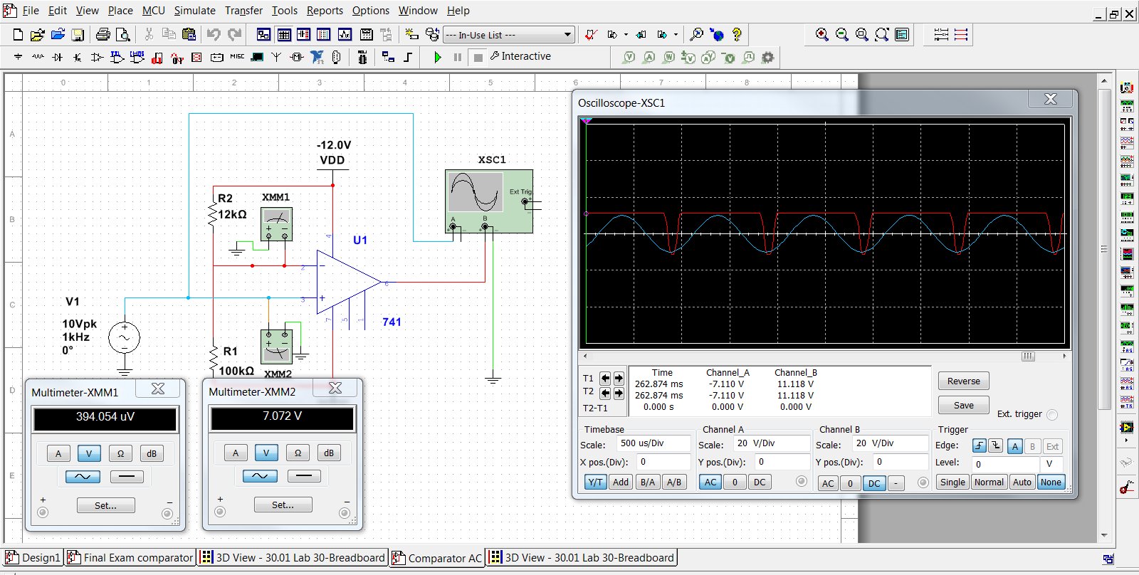

I'm in the process of trying to recreate this Comparator question. It's one we haven't seen before, but it was on the final that I just finished.
Here is a schematic that I drew up from memory and Aol=120,000. The standard method of find the Vref doesn't work.
Vref = V*R2/R1 + R2.
Looks like you forgot the brackets - V*R2/(R1+R2) for a potential divider which assumes R2 is connected to GND typically. Which you haven't got on the schematic but you can still use the same equation. Just pretend that the -12V is GND and then at the end compensate for that sleight of hand.
With the VDD = GND then VCC becomes +24V. Then you get 24*12/(100+12) = 2.57V. The 'fix' at the end is to realize that this 2.57V is more positive than VDD at -12V so add it to VDD giving -9.43V. That's the Vref I presume.
Next up the Aol for a 741 is strongly frequency dependent so the gain of the 'comparator' depends on frequency, descending at 6dB/octave above the corner freq. If you go by TI's datasheet the corner frequency is around 3Hz and the Aol = 106dB (200,000) but that's with a 2k load. If you're only feeding a 'scope the gain will be higher.
Abraxalito,
I calculated with the brackets...just left them off here I think...it was late. Here are two full simulations of the circuit on the scope. Now, let me read what you wrote. 🙂
I think I got that -9.43 also, but wasn't quite sure how. I thought originally output would swing from -11V to +11V. But somehow I think I changed Vout and got the 0 to +11V swing. Voltage gain I thought = Aol and had 120,000

XMM1 is showing a Vref very close to GND so something's looking wrong. I reckon that with 10V p-p input the output shouldn't change at all as the Vref is never crossed by the oscillator's signal (-5V -> +5V).
XMM1 is showing a Vref very close to GND so something's looking wrong....
The "~" button is blue. Could that mean AC volts?
Ah yes - good catch. And also I've now noticed I misread the oscillator output, which is 10V peak, not peak to peak. So yes there is enough swing to trip the 'comparator'.
I reckon the voltage gain for 1kHz will be around 60dB (1,000) and so you'd need at least 10mV to swing the output to the rails.

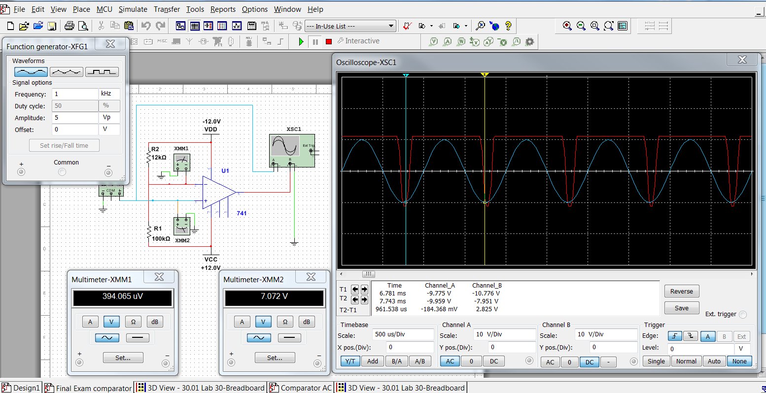

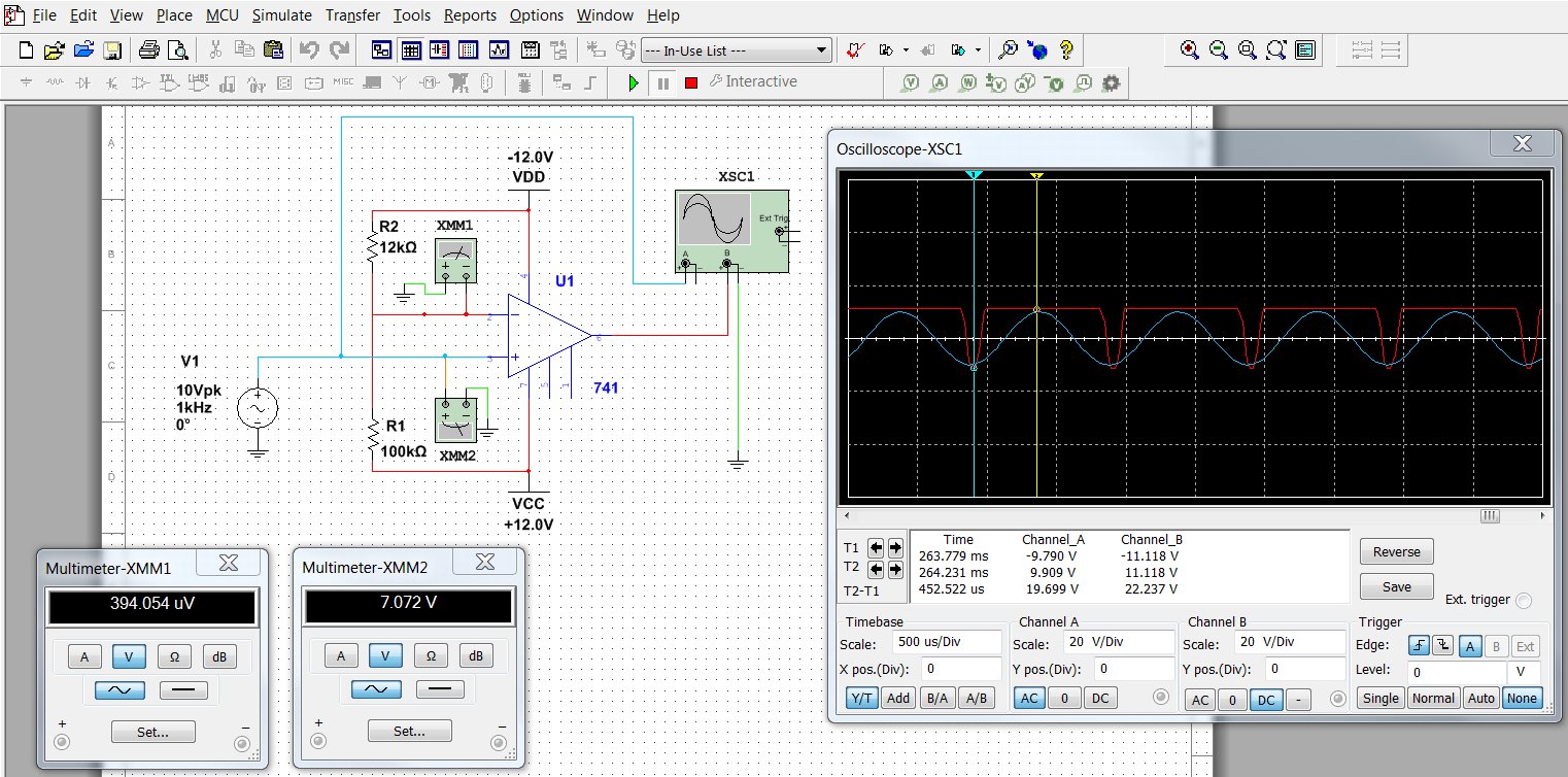

Comparator Vs is AC and Vs is Function Generator
I placed this with both side to side so they are easy to click and review. I'm still not sure why they are so different with what should be the same inputs.
One using an AC source the other an FG source. Everything else is equal.
I recall reading that w/o feedback referenced to output, the voltage gain (Av) = (Aol) Open Loop gain even though the device is actually limited by the supply voltage.
Color is what I chose to make them look different so they show up on the scope better.
AND, the function generator is not correct. It's cranking out 20 Vp-p NOT 10Vp as specified.
Okay here it is with FG set to 5Vpk
The second image is showing an input voltage going beyond the common-mode input range of the 741. All bets are off then as simulators are unlikely to handle erroneous circuit conditions in the same way as the real silicon. Some opamps exhibit phase reversal of the output under such conditions for instance.
