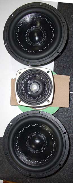

I am nearing completion of the drivers for the MTMs and laid the drivers out last night to get a hint of what they'll look like.

planet10 said:Ben,
I thot you might also like to see how my set of the woofers (like yours) turned out.
dave

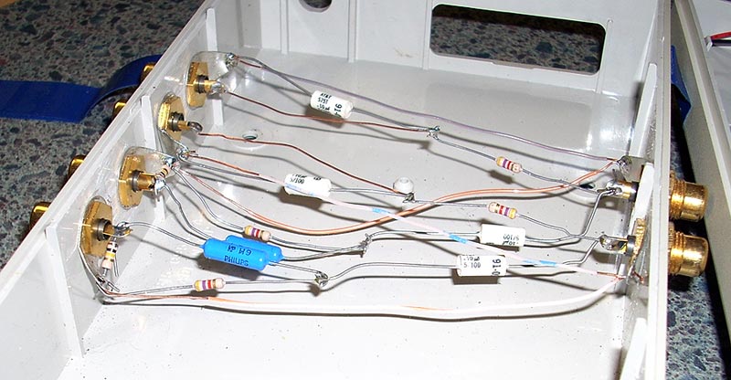

Here is a pic of my Tysen XO. Fonken + extened range woofers could be 4 parts simplier (and if you could install the HP cap in the amp you are using even less.
dave
planet10 said:
That is a decent looking one to keep in mind... dig you get the op-amp upgrades?
dave
