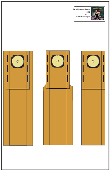

I really like the aesthetics of the middle design. Looks like it would be a nice way to go if you needed to increase the volume of the cabinet.

An update and a couple of questions
With a lot of assistance from Dave, I've decided on an enclosure and drivers. I'm building a cabinet similar to the Fonkenwoof with two 7 inch drivers per cabinet in a push push configuration. The cabinets are being made of 3/4" baltic birch ply, are approx. 1 ft^3 and are vented with a single rectangular port at the top of the enclosure which is 1" tall, 7.25" wide and 11" deep. Modeling the cabinets in winISD I come up with a -3db of 43.4hz. The crossover I'm using is one I bought as a kit from audio-kits.com; it's a Linkwitz-Reilly 4th order active crossover set at 120hz.
Now the questions:
Should I line the interior of the cabinet in any way? When I built the Fonkens I used 3/4" thick polyester batting on the walls; it is my understanding that this is done in a full range speaker to reduce reflections that may come back out through the driver's cone. Is that also necessary in a bass only design such as this? If the batting isn't needed, I was planning to spray the inside walls of the cabinet with sound damping paint to minimize cabinet resonance. Is this a good idea or not?
There is a driver brace in between the two drivers, meaning it runs from one side of the cabinet to the other width-wise. Should I place the brace so that it is not at an even fraction of the distance from one side of the cabinet to the other? Meaning, should it not be exactly 1/4 (or 1/3, or what have you) of the overall depth of the cabinet from the front wall of the cabinet? My thought is, as was the case in the Fonken cabinet, that if it were at an even interval in the cabinet it would tend to amplify a certain frequency. Am I thinking right?

Re: An update and a couple of questions
I would. Just as a matter of course.
Yes you are thinking right. A tiny bit trickier but more effective yet would be to place it at an angle so that it divides the braced panels into unequal trapezoids.
dave
strider75 said:Should I line the interior of the cabinet in any way?
Should I place the brace so that it is not at an even fraction of the distance from one side of the cabinet to the other? Meaning, should it not be exactly 1/4 (or 1/3, or what have you) of the overall depth of the cabinet from the front wall of the cabinet?...Am I thinking right?
