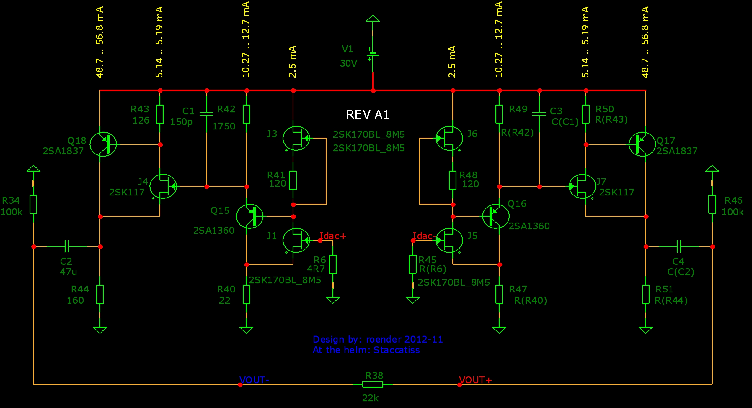

Would it be possible to get 4 Vrms output instead of 0,6 Vrms?
If so, how?

I use a line amp in between the IV converter and the power amp. And all my gear follow the standard output voltage, ie 2Vrms single ended and 4Vrms balanced. Makes life so much easier. Having only 0,6Vrms is far to low.
Some extra heat is fine, and a higher rails is OK. I often use 24 - 36VDC myself.
With this in mind, how would you change your design to get 4Vrms output voltage?
/S

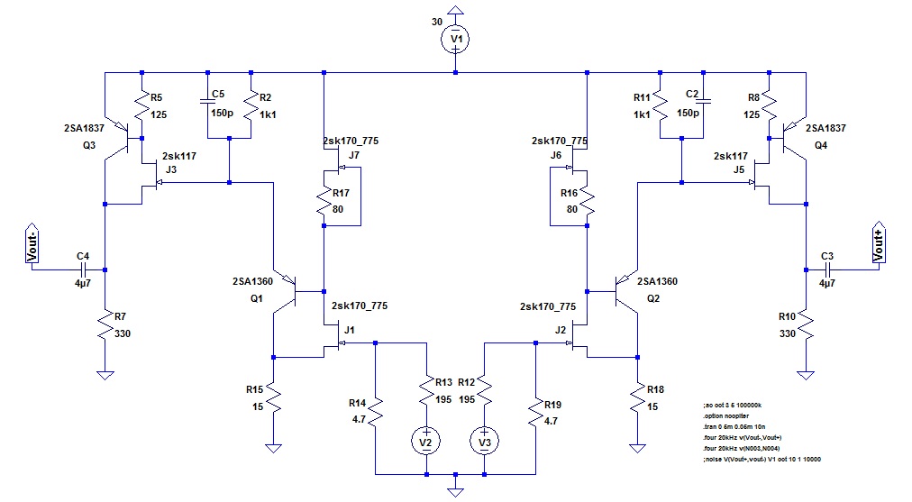

This are the results for 4V rms analog output at 0dB digital output.
The power supply voltage was increased at 30Vdc, hence R7 and R10 dissipates now around 1W, Q1 and Q2 dissipates 250mW and were upgraded to 2sa1360 (must be placed on a small heatsink)
You need to supply a very clean power voltage, preferably from a shunt regulator capable to give 30V/150mA per each channel.

Please find below the requested values:
I(R8 = 5.14 / 5.19mA
I(R10) = 48.7 / 56.8mA
I(R11) = 10.26 / 12.7mA
The above min and max values are for full output swing.

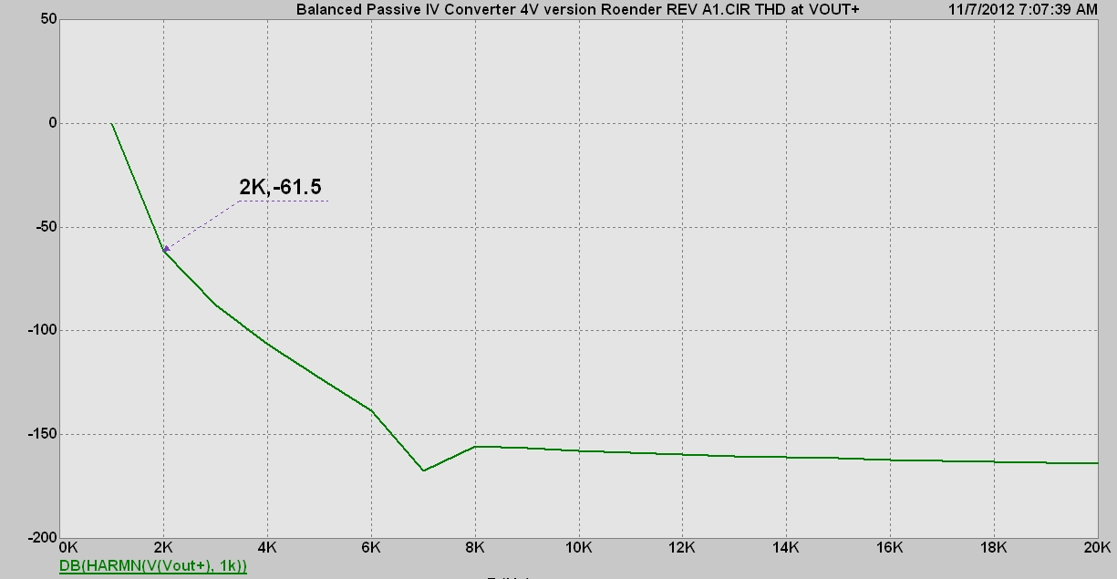

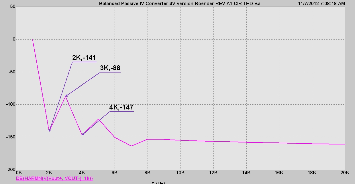

To get 4,0Vrms output, and have the currents you wrote down, I had to change a resistor value into half what you suggested, and I had to increase the 1k1 into 1k75.
THD is about -88 dB in balanced mode as the even order harmonics cancel out. In the real world, where an amplifier does the balanced to single ended conversion, even order harmonics will not cancel out as well.
In SE mode, THD is rather high at -61 dB simulating at 1kHz and 2Vrms out at 0 dBFS (16mAACp-p).
See attachments.

If you are using Buffalo II or III DAC the output current is actually 17.2mA pp.
Better use the same source as in my simulation, a voltage source with 1.715V DC offset and 1.69V swing at 0dB output followed by 195ohm series resistor.
I should haev told you about my source. It uses 195.3128 resisors which are inseries with the sine generator, and also in series are 1,65VDC batteries. I use an inverter so that only one sine source is used.
So, we are using the same system except that I use the (recommended) 3V3 instead of Twisted Pears 3V5.

Do you mean 2V rms single ended, because 4V rms is pointless for a single ended preamplifier?!
I get -59 dB THD20k at 2Vrms output voltage which is about 20 dB worse than you get. I have tried the design with both your values for the 4V version, and also with my values. You vales give me only 3,6Vrms (balanced, 1.8Vrms single ended) using 16 mAACp-p signal input.
Not sure what the discrepancy is caused by.Might be the models.

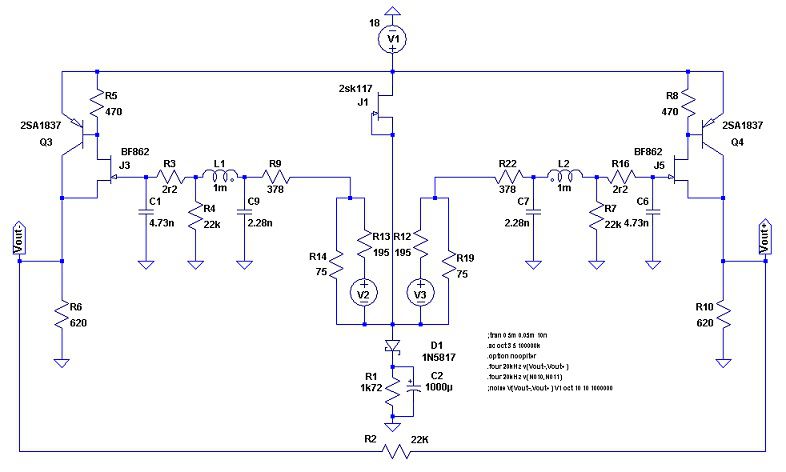

I understand your latest output stage has evolved into the one below.
http://www.diyaudio.com/forums/digital-line-level/117238-ess-sabre-reference-dac-8-channel-246.html
So you now prefer it in voltage mode with higher output that gets filtered before going to a unity gain buffer while previously you had it in a sort of forced current mode then to a microphone preamp...
Could you describe the sonic differences? Is the filtering very important?
And would it be even neater to implement a common mode filter going into the buffers? Thanks roender.
