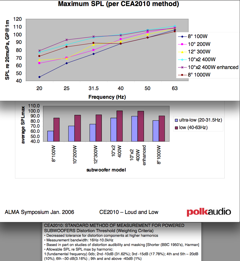

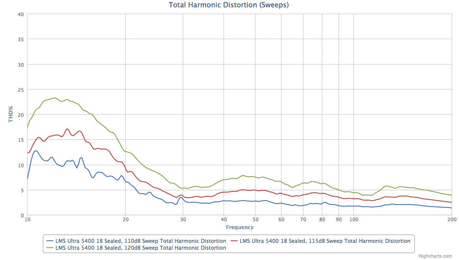

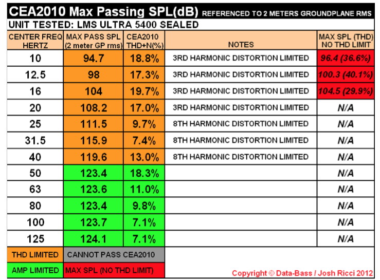

Ben,
I have extensively tested various subwoofers using sine waves, which make it far easier to notice harmonic distortion than music.
Doing those tests I have found that although 10% distortion is noticeable, I can't really notice low frequency distortion of fundamental frequencies below around 80 Hz when the distortion falls below around 5% in a normal fashion, that is each higher harmonic is less than the previous.
The only subwoofer distortion standard I know of, the CEA2010, allows up to 31.62% 2nd harmonic distortion.
http://personal.inet.fi/private/zipman/starobin_CEA2010.pdf
David's motional feedback system appears to make what would be an audible difference on the loudspeaker under test that he "would not recommend .. for HiFi use" though it looks like it would pass the CEA2010 without it.
Josh Ricci's sealed LMS 5400 exceeds the output level of the lowest distortion sub in the Jan 2006 CE2010 paper by some 28 dB.
Whether one uses an inherently low distortion sub or a high distortion sub with MF applied to achieve similar measured distortion, it seems illogical to pay more for something that does not make an audible difference.
As David wrote in post # 92 "your LMS may not need much feedback at all 😉".
Art
