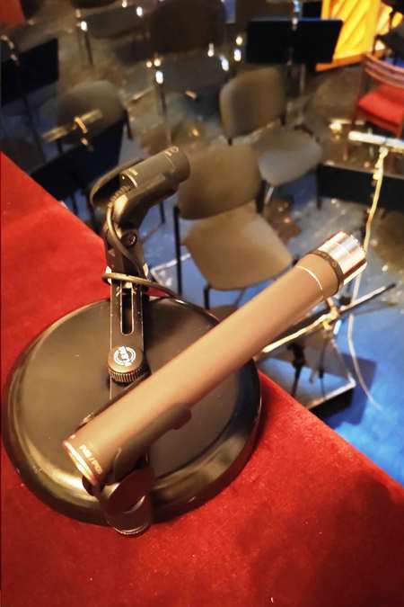

Notice the orchestra pit behind the blind test of the 2 microphones.
attachment.php
My friend then blind tested me on the microphones, which one was in use in the mix, (Mozart) and why.
I didn't give a rat's A, about his psychology, I just wanted to know how we could improve on the astonishing difference in the 2 microphone characteristics which were in exactly the same places, (& after successfully identifying them blind by the sound.).
The makers were as interested as us, because nobody had ever given them a proper test in a live environment, and there we are talking about one of their clients being Austrian radio!
Both microphone manufacturers thanked us for our help, and really improved the product.
btw:-
One of them (the long one) is supposed to be a copy of a DPA (B & K).
'nuff said,- dunno why I bother really.

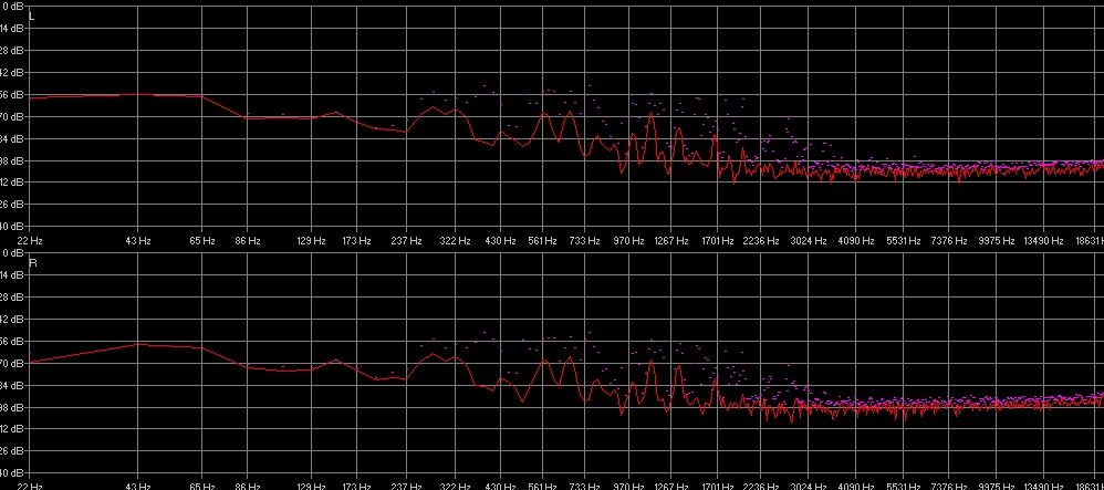

Can you please explain what is being measured in the two plots, and highlight the key differences between them?
Ah yes, that is the FFT graph for FR using a sweep trace from 20hz-20khz with a Neumann KM directly compared with a Nevaton microphone, both of them in exactly the same spot, kind of a bit like the live music test we did at the opera house, but with FR traces.
The source is my own studio monitor system.
This is all OT, but shows empirical data is king, not "touchy-feely" stuff ie. most of the things here I criticised so it's worth reading the details, and answers the previous poster quite well.
It's a "quick and dirty" test to explain, we can measure what we hear, and display why it sounds different.
It's not scientific and doesn't use REW.
What you see is what you get.
Here it is again:-
https://www.diyaudio.com/forums/att...-neumann_bottom_trace_v_neva_music_woofer-jpg
Some remarks,-
The valve amp used to power the speakers is highly unusual and displays no roll off into an inductive load at full power right down to below 20hz.
There is good correlation between the 2 mic curves.

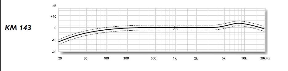

It shows in great detail, a sharp rolloff at LF below 43hz on the Neumann which is the bottom trace.
It correlates well with the manufacturer's graph shown.
However,-
the normal -4dB roll off which the Neumann mic should display 100hz>45hz is not visible instead we see a +14dB rising rate below 100hz on the Neumann, and a flat reponse of +14dB on the Nevaton giving similar levels.
Being as almost all speaker systems display a -10dB roll off from 100hz down this would imply the monitor system has a gain approaching +20dB compared with anything I ever saw in a "high end" shop.
This would imply high sensitivity more expected of a large horn system.
+20dB at LF is a bit like comparing a system with 100s of watts with another of only 2-4W, because LF is where all the energy is.
This is why I am with "Brinkmann" on this.
Make a system which approaches the needs of Fletcher-Munson, especially at decent sound levels, and you are half way there.
Being as the system is designed to be able to reproduce organ recordings ultra cleanly, and dissect live recordings, it has met its target.
It still struggles with my live recording of Tchaikovski Francesca da Rimini which not a single hifi system I found can reproduce. haha!
On the upper trace the Nevaton shows a noticeable drop in output from 1,7khz up compared with the Neumann, which has a rising output from 8khz up.
If you compare the actual results from the studio system with the manufacturers graph for the Neumann, 3 remarks would be obvious.

We have to differentiate between the performance of the monitor system and the performance of each individual mic in order to be able to get some idea why they sound so different.
1/ Observing the general trend regardless of the actual positioning of the mics in front of the large array, the bass response of the system is enormous, and that the Nevaton does not have an extra -6dB roll off below 45hz.
This came as a suprise.
remark-.
It's extremely rare to see substantially flat bass reponse down to 22hz, proving such testing impossible in any "hi end shop".
The idea was to produce a sound system similar or better than Altec / great plains.
It appears we succeeded.
2/ A peak at 250-350hz is observable which cannot come from the microphones, with another at 550-700hz. This equates to the behaviour of the mid range array which are actually "full range" drivers.
This confirmed my observation that full range drivers tend to be peaky but add clarity in the mid range.
3/ The Neumann is such a superb microphone, that my own favourite use for chamber music makes sense.
For us all it was a "revolution" discovering this one back in 2001 while recording a music festival.
It's no longer made.
I had numerous offers from people WTB.
The Nevaton microphone in our own words was "muddy" at anything over mid - to HF, but superb clarity at LF. We used it in pairs to bring in the double basses of the orchestra.
Compared say with a DPA, it was coloured and warm.

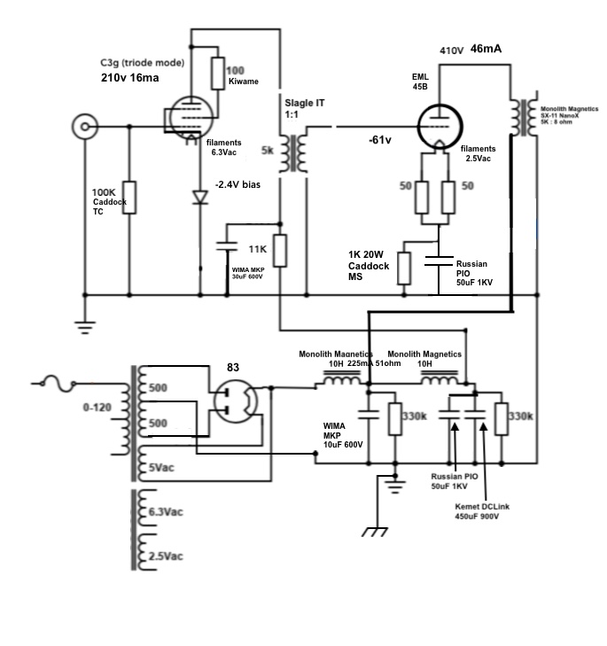

No chokes were used in the PSU of the amp delivering this performance, but the PSU transformers are oversized.(2 large ones in parallel).
In effect paralleling the large power supply (PSU) of 2 monoblocs works well, (connecting them together) but you will never see it done.

The 2, US made mono blocs had seperate power supplies which were fed with a monster 1kW step down transformer 230-115V.
They are actually 70yrs old with old fashioned L-C and C-L-C PSU.
We were concerned that the amps didn't somehow sound right unless driving complex loads of 4 speakers instead of 2.
This turns out to be an anomaly with this amp.
I could hear a difference between the simple and bi-wiring as well as deliberate mismatch in impedance.
The test system with FFT above could SEE a difference each time superimposing before & after.
Ie. If you can't measure something, you are not measuring it right!

According to this product information the Neumann KM143 is a combination of the AK43 transducer and the KM100 output stage: https://www.vintagemicworld.com/afbeeldingen/Neumann_KM100Brochure.pdf
The smaller microphone in the picture in post #91 would than be the transducer without the output stage. Although the picture isn't very detailed, I don't think the transducer is the same as the AK43 transducer shown in the Neumann product information.
I don't use KM100 with the active cables, (but you can and it would look very similar) so NO, -
The small microphone in the post is Nevaton. (LHS)
The large one is our Russian DPA clone. (without the XLR connected
RHS).
The curiosity with the Nevaton, is the class A circuit which drags a lot out of the phantom PSU.
It's one of the features they agreed to modify.
Nevaton is basically a small friendly company that picked up the pieces of the outstanding Lomo microphone range, one of which we have used.
It was impressive, I would say far superior to Schoeps, but with a weird plug on, that I believe was used in something military.

Thanks Blitz, this is the kind of information / response I have been looking for.
Have you tried a power supply with a 2 staged LC design: L1C1 --> B+ OPT, and L1C1L2C2 --> the IT for the driver tube? see schematic below. In my simple mind, the L2C2 will filter any noise coming from L1C1 and the output tube stage / OPT.
Well, why not? Started that way.
I dont do this anymore...each stage has its own PSU now....
...i just wonder how much voltage swing you try to get and why / what comes next.
I would always try to avoid
-83...the worst sounding Mercury rectifier. Go 866. or rgn1064 mesh.
- avoid autobias, go fixed bias or sic biased
- challenge the 45 stage...one stage less will sound much better...how much amplification do u really need?
- if you go DHT, which I recommend, but only one stage, go for a very quiet filament supply.like rod colemans regs and yoi dontuse the artificial resistor pair at thecathode anymore...they destroy musical energy as well.
Each part is audible. So, use as few as possible but of highest quality. If you thoight a 6sn7 is linear...have. alook ar the curves of a 801a or rs242...try to avoid distortion where they will be generated
