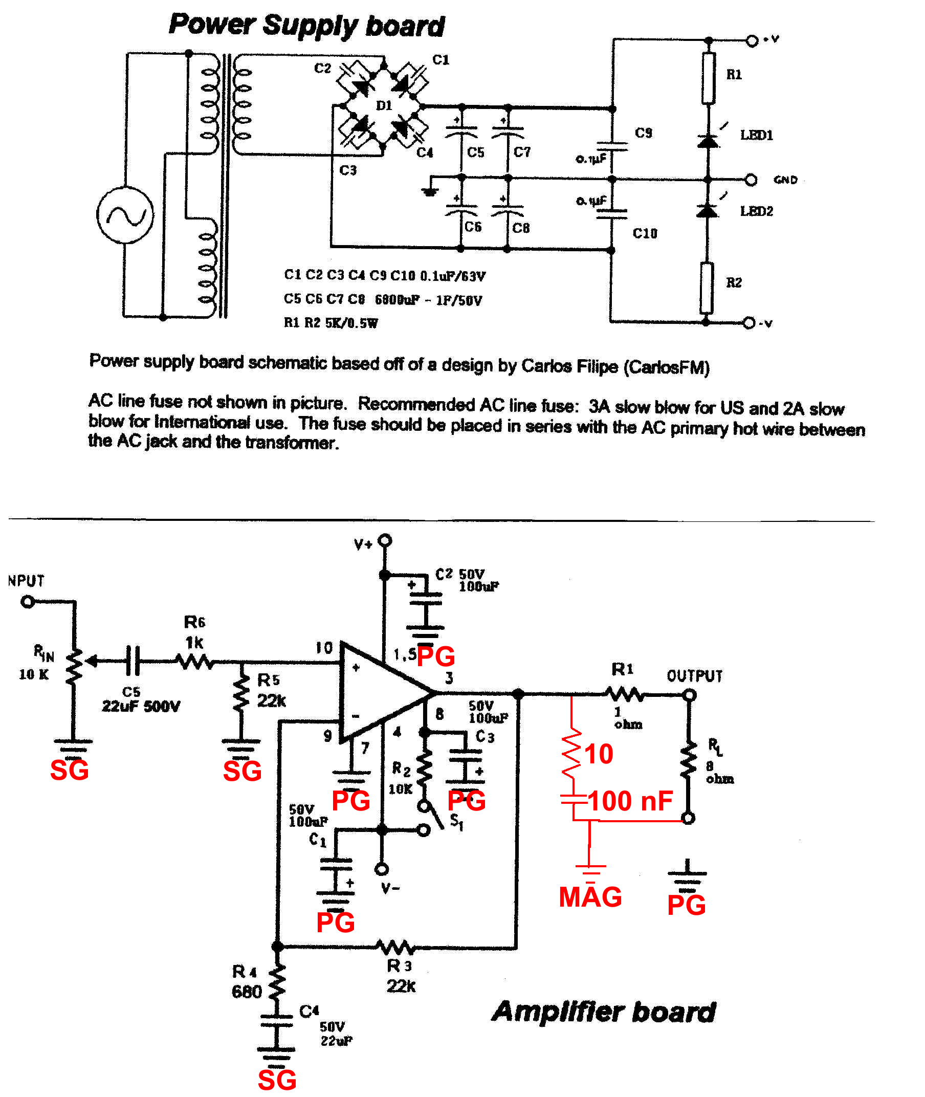

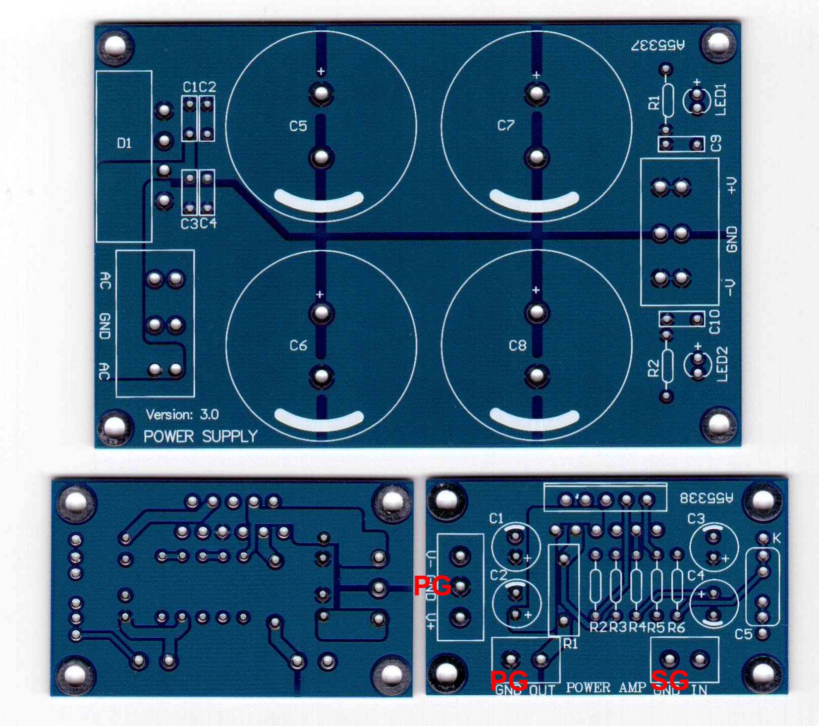

I used a cutter to cut the bridges. It was not as easy as first thought. The bridges are tiny. Cutting them is closer to a surgical operation than general DIY.
The lower C4 pad is now separated from the power ground, confirmed by the Ohm-meter. I checked that the bottom trace is electrically connected to the top pad.
What is next?
What is next?
relabel the schematic.
Change all the Signal Grounds to say SG/SigRetn. R5 & C4 connect to SG
Change all the Power Grounds to say PG/PGnd.
Not shown on the PCB, but add a notional Main Audio Ground (Star) labeled MAG or Star *.
This is where the speaker return connects, not the PG.
Add the missing RF filter to the input.
Add the missing Zobel/Thiele Network to the output connected to PG.
Update the power pin decoupling to match National's recommendation.
Build up your PCB keeping those three grounds separate.

I hope that I relabeled correctly.

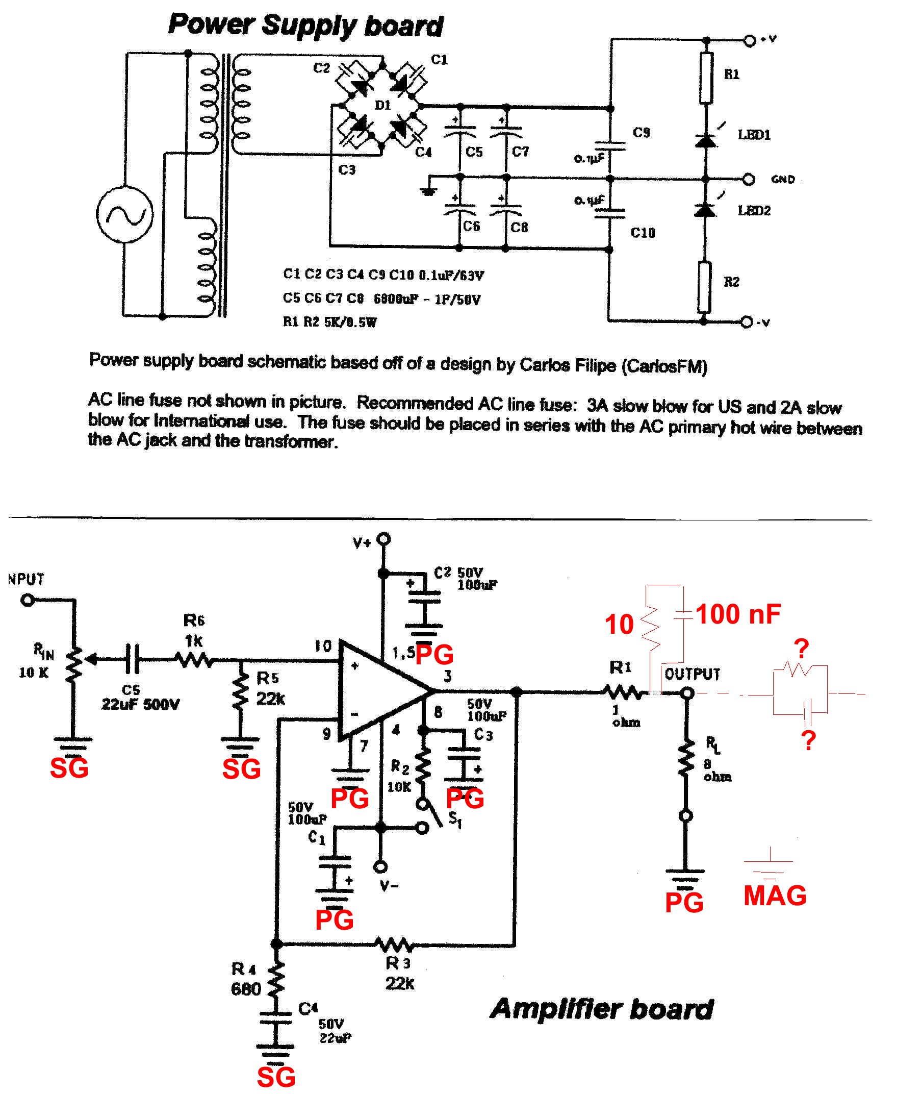

How should the missing RF filter look like?
Not sure about the Thiele network either. I understand that it reduces RF from and to the amp, but I am not sure about component values and configuration.
?Update the power pin decoupling to match National's recommendation.
Do not understand.
?Build up your PCB keeping those three grounds separate.
Where should the MAG be?
Nearly there.
Read National's datasheet for supply rail (power pin) decoupling.
Read National's datasheet for details of output Zobel. The 1r0 resistor comes after the Zobel R+C
The Speaker Return must be connected to MAG not PG.
When you have that, there is yet more to come.

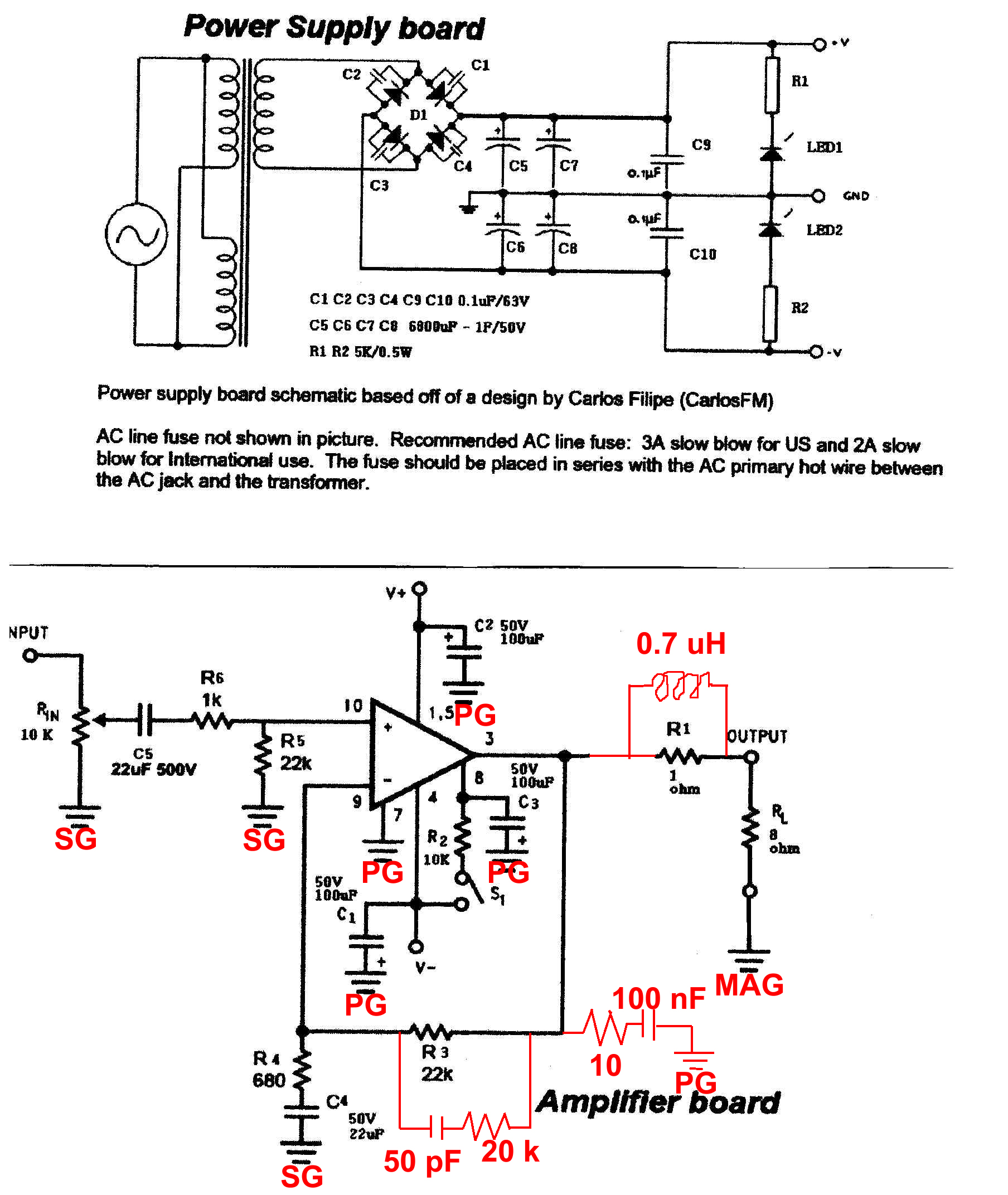

Cs is supply rail decoupling. Fig2 uses only one, but your dual polarity version Fig1 needs two.
Rsn + Csn is the output Zobel.
Adding *L // *R converts the Zobel to a Thiele output Network.
You already have the series Resistor *R. you need to add the 3 missing components.
The Output Zobel Rsn +Csn must be connected to Power Ground PG.
The speaker Return must be connected to Main Audio Ground MAG.
Read through that table. Identify every component in the Fig1 & Fig2 schematics. Find out what each component does. Ask if you can't understand any part.
Add all the extra components of Fig2 & the table to Fig1, except the single supply biasing which dual polarity does not need (Ra+Ca+Q1).
By the end of this you will be starting to understand why a chipamp with all the extras is able to do it's job.

the Inductor (L) goes in parallel with 1r0 (R1). You don't need two resistors in series. Delete the extra 4.7mF.
m= milli (10^-3)
u= micro (10^-6)
H= Henries The inductor to use can be anywhere between 0.7uH to 3uH. Try 10 turns 1mm diameter enameled copper @ ~ 10mm diameter air cored helix
The 10r+100nF (Zobel) returns to the Power Ground PG, not MAG.
The speaker returns to MAG not PG.

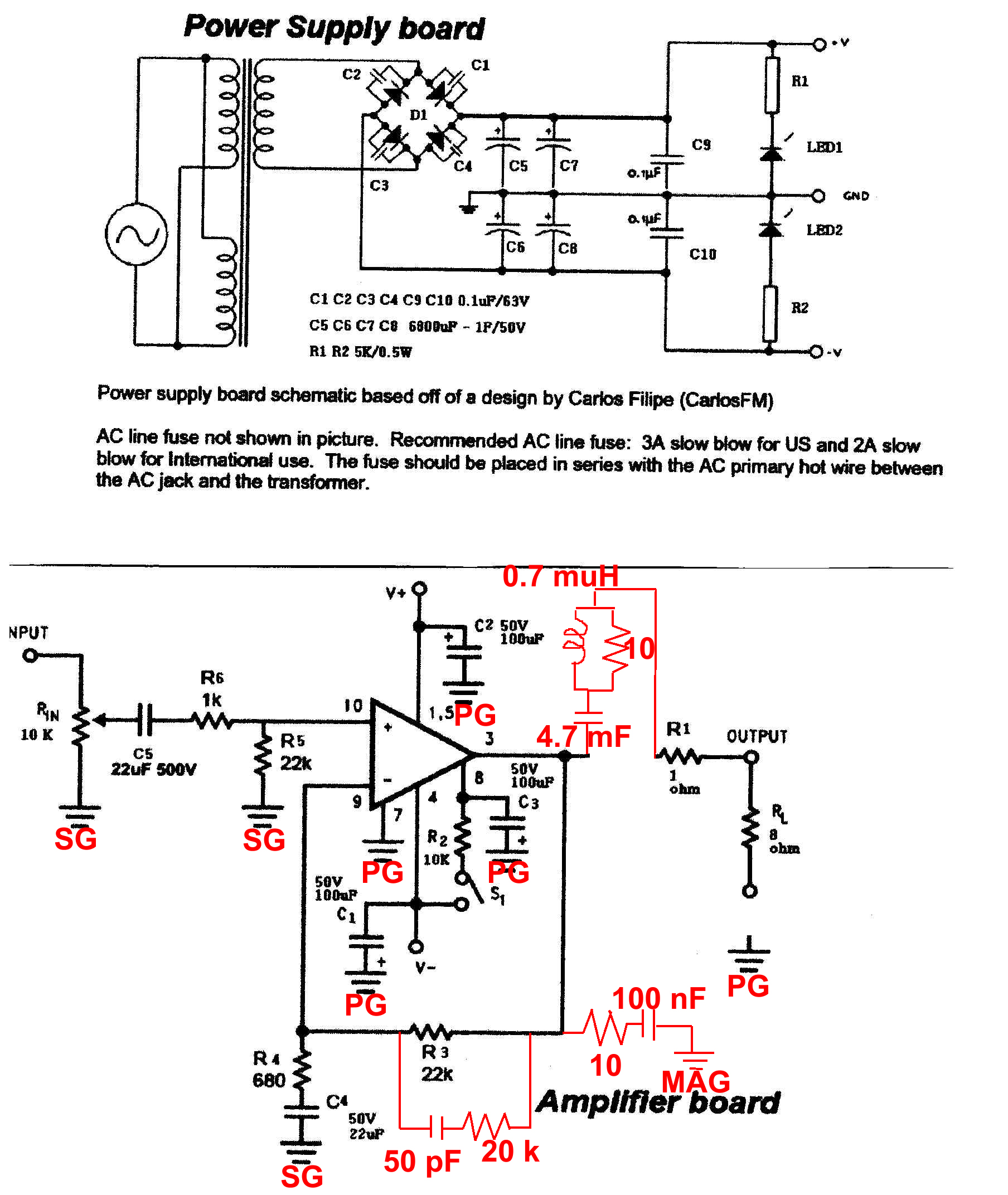

Ok.the Inductor (L) goes in parallel with 1r0 (R1). You don't need two resistors in series. Delete the extra 4.7mF.

I had only copy-pasted the schematic on page 8 (Fig. 2). I was obviously wrong. Hope that this time it is correct.

Ok. I will have to find this copper helix. Maybe it can be taken from an old PCB.H= Henries The inductor to use can be anywhere between 0.7uH to 3uH. Try 10 turns 1mm diameter enameled copper @ ~ 10mm diameter air cored helix

I've the exactly the same PCB as the one you have.
I'm trying to implement some bass boost circuit based on this circuit
I'm wondering what I need to change?
I'm trying to understand which portion of the circuit is the bass boost.
Please help.
Please help.

The 3886 is shown without RF filtering, without DC blocking on either the input or the NFB, without local decoupling and onboard decoupling, without a dedicated signal return to pair up with the signal input, without a delay on deactivating the mute pin, without either a Thiele output Network nor an output Zobel.
Who told the Chinese that ground planes are equal to or better than star grounding?
They actually are better if executed well. Unfortunately that is hard to do on a 2 layer board. If performed well, a ground-plane is better then a star-grounding. Inductive -wise, RF-wise and (subjective) sound-wise.
With kind regards,
Bas
